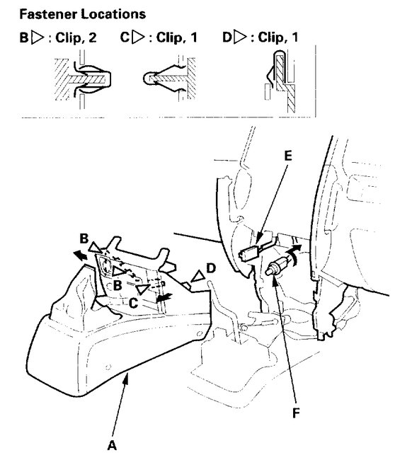

I need to remove the back part of the center console, because I want to install an armrest between the front seats. There are 2 screws on both sides of the back part of the console, I did remove them. The front and the back parts of the center console are somehow connected to each other, but how? I do not see any more screws...
Jul 31, 2020 at 1:41 AM
  • 110,244 POSTS

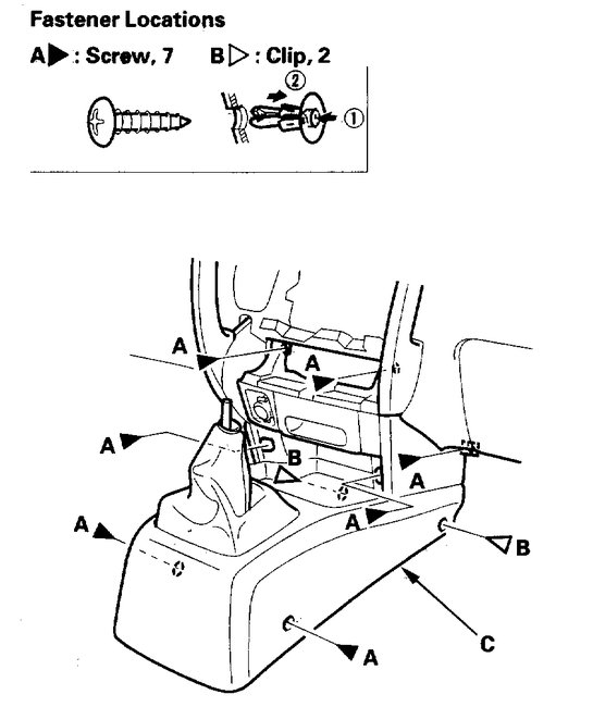

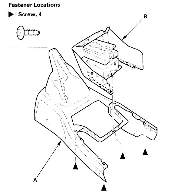

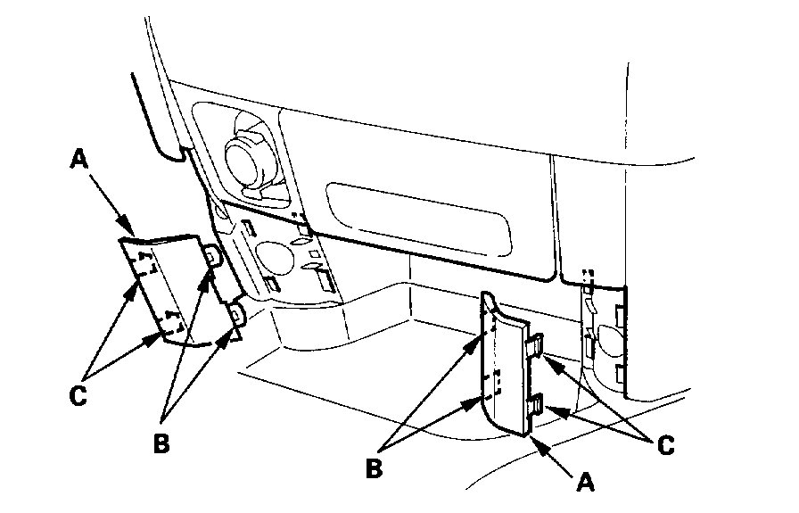

The HRV wasn't offered in the US in 2005, so I have very little technical information on it. What I did was look up a 2005 CRV which is the closest thing I have. I attached several pics below of the console and how it's removed. It shows where the fasteners are located.
Take a look and see if it helps.

Dear Joe, thanks for the answer! Unfortunately, the HR-V's center console is very different from CR-V's (I had a CR-V previously). There must be a hidden (I mean inside the console so it is not visible) patent or fixing between the front and back elements of the console, I think I could touch it with my finger thru the whole of the fog light switch, but do not know how to make it released.
