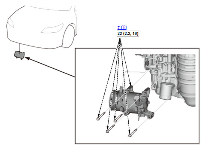

I need to replace my AC compressor, I just don't know how to access it.
Oct 17, 2025 at 3:40 AM
  • 55,432 POSTS

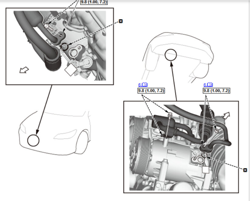

Okay I can help. here is a video you will need and a generic guide to help as well with diagrams for your car in the images below. Take your time and if you have any issues please upload a short video so I can help you.
https://www.youtube.com/watch?v=4EqdrBVb0sY
and
https://www.2carpros.com/articles/replace-air-conditioner-compressor
Make sure the system is fully discharged before working on the HVAC system compressor. Check out the images (below). Let us know how it goes.
