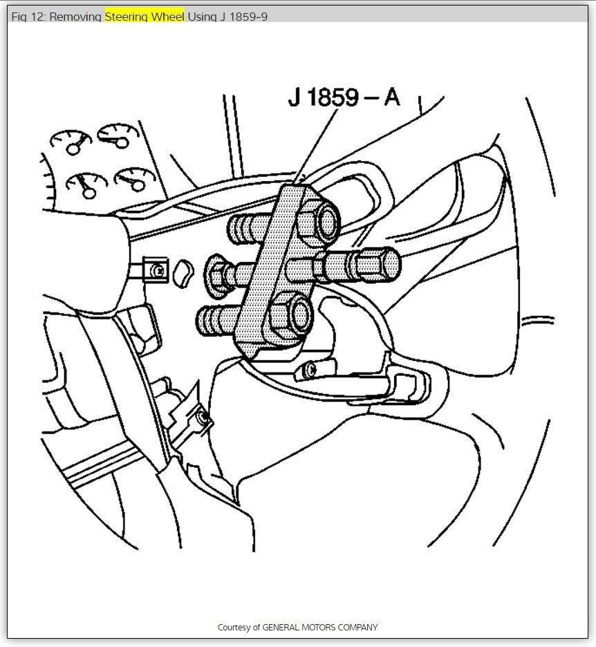

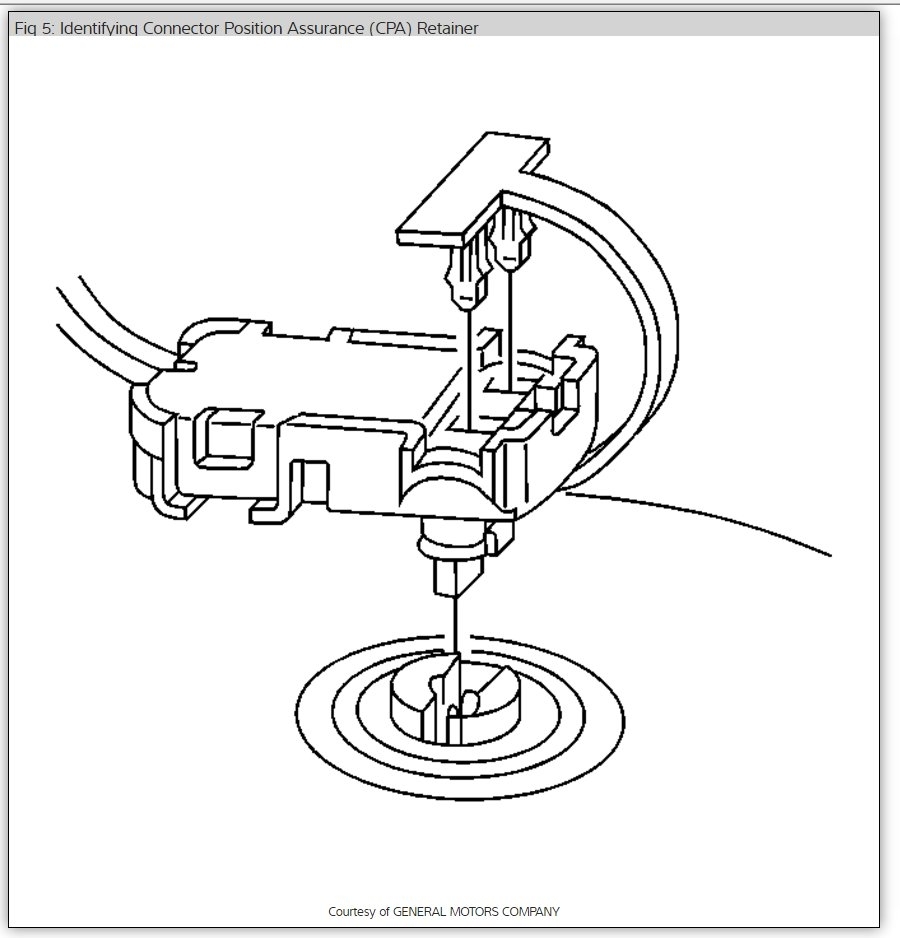

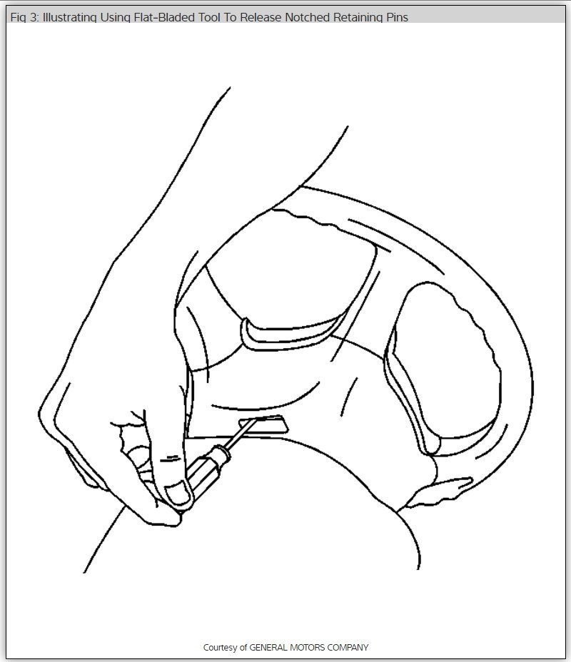

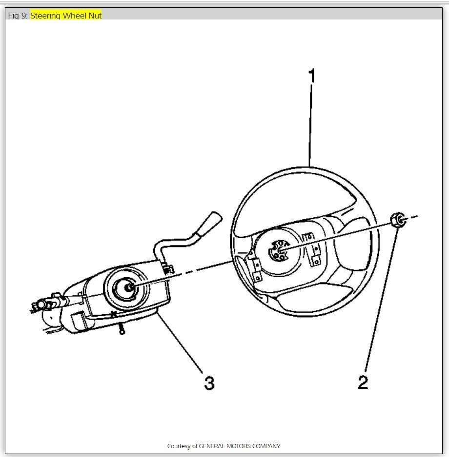

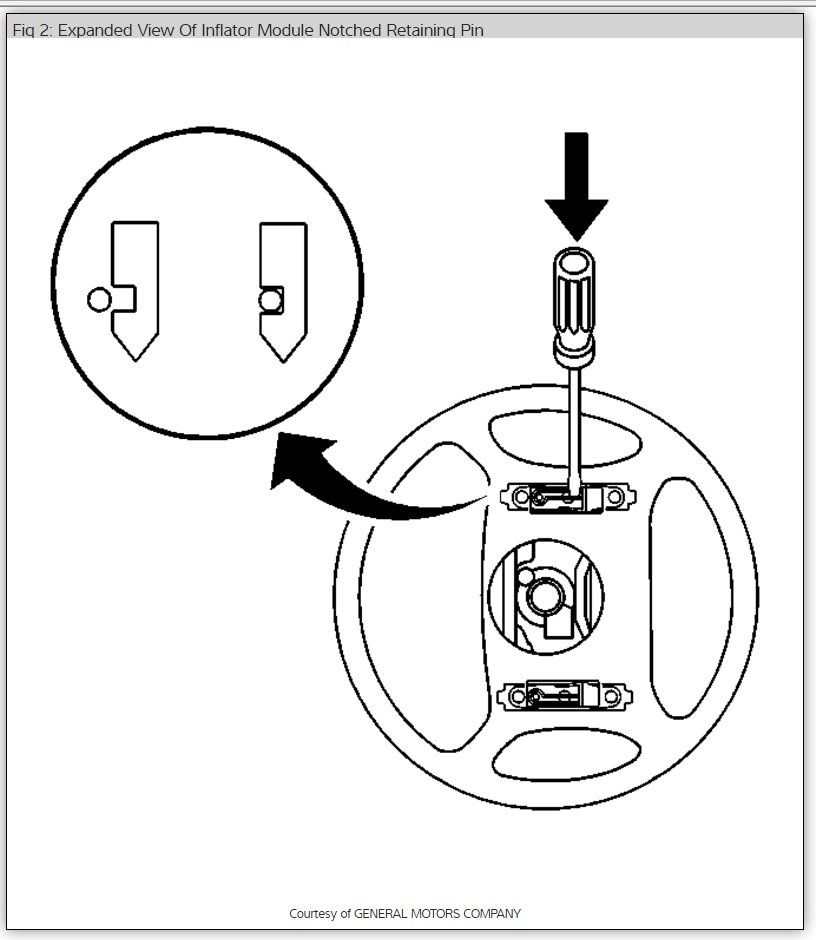

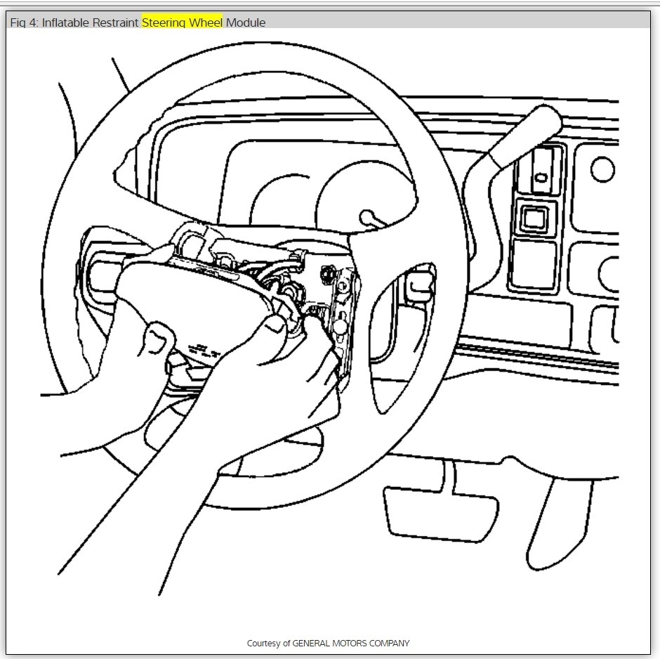

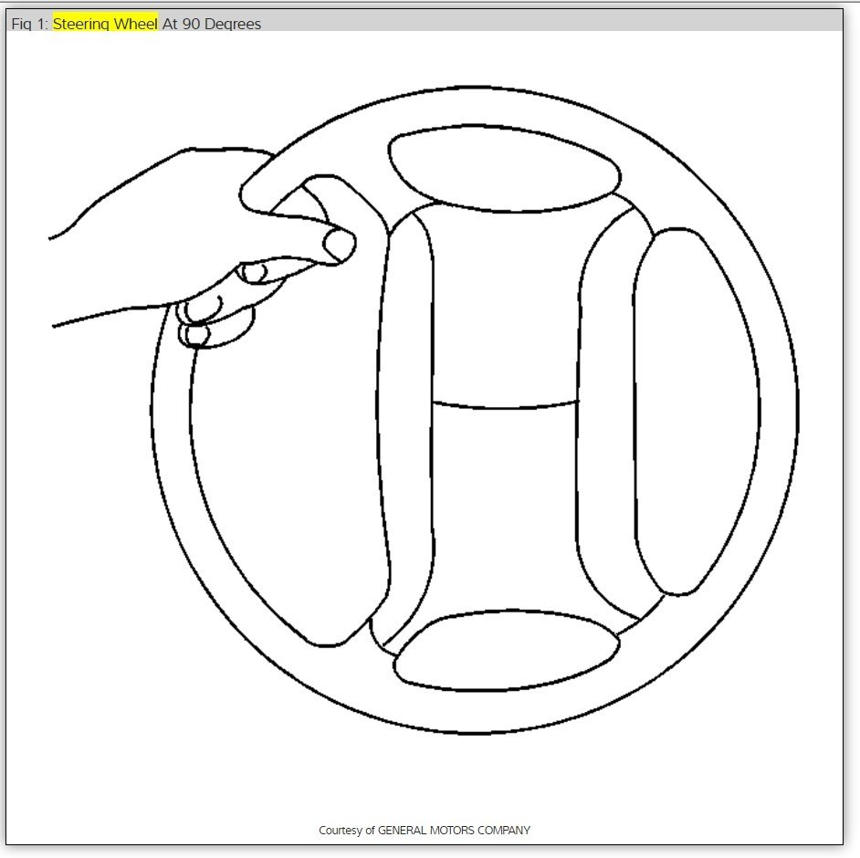

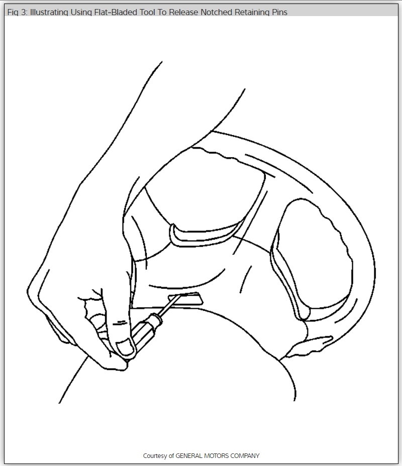

I want to replace ignition the steering wheel is stubborn.
Jul 3, 2018 at 6:50 PM
Experienced Mechanic
55,746 POSTS
Here is a guide to help you remove the steering wheel and diagrams below to help you as well:
https://www.2carpros.com/articles/steering-wheel-removal
