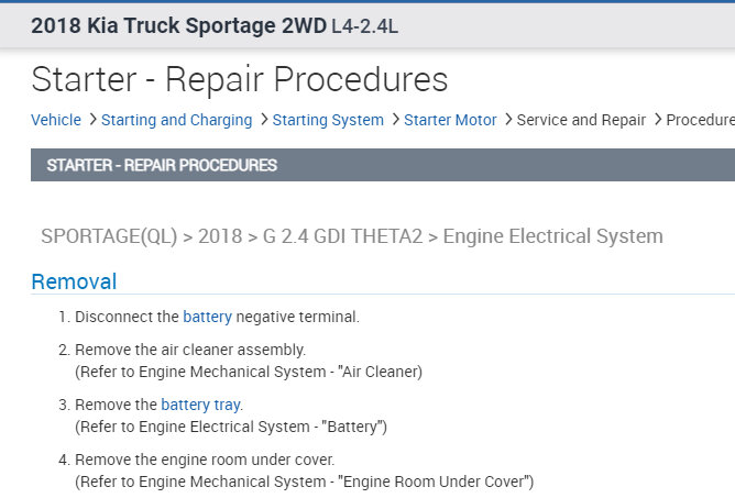

How to remove and replace the starter?
2018 KIA SPORTAGE
77,000 MILES • 2.4L • 4 CYL • 2WD • AUTOMATIC
CSANCTIFY
Won't start.
Oct 31, 2023 at 11:29 AM
  • 110,244 POSTS

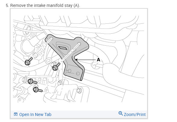

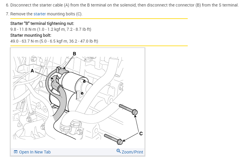

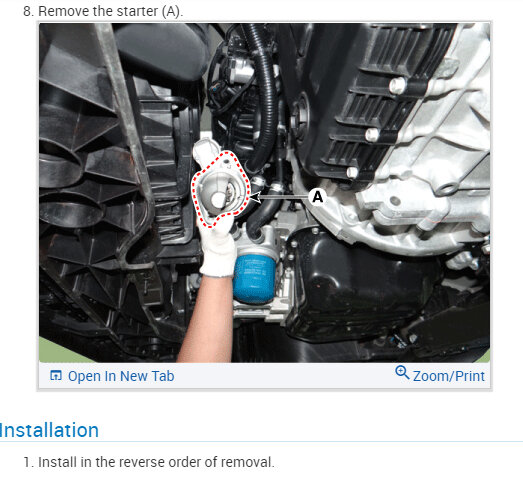

This is a straightforward repair. However, make sure the negative battery terminal is disconnected before you start working on or around the starter motor.
To get you started, here is a link that explains in general how to replace the starter motor. This may be helpful for you because in general, it shows the different steps.
If you look below, I attached the directions from my manual specific to this vehicle. Take a look through them and let me know if you have any questions.
Take care and let me know if this helps.
