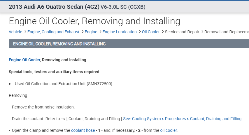

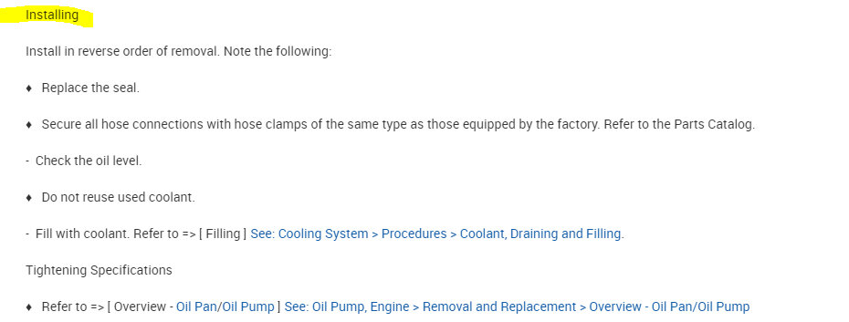

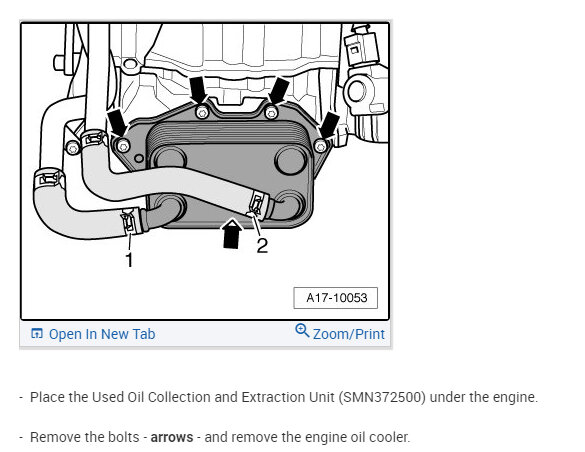

Is this the engine oil cooler? If it is, I attached the directions below. They are vague as always.
Take a look at it and let me know if I have the correct part. Also, you indicated 3 bolts. There should be more. And last, is the bolt head stripped or the threads?

Oh okay, i will double check to make sure if there are 3 or 5, yes, i had my shares of stripped bolts but this one was already stripped and little room to work with, it's the outside threads where you attach a socket to remove it, most left. One on bottom was removed, one to the right is blocked by a frame.

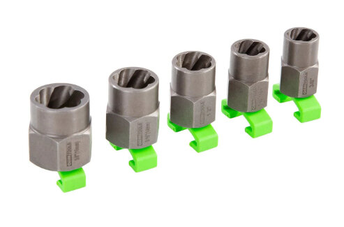

As far as the stripped one, do you have access to it? If so, they make bolt extractors for bolts with stripped heads. I attached a pic from an AutoZone site of what they look like below. If you have these, they should remove them.
Now, the one blocked by the frame is a different issue. Is there any clearance between the bolt and frame?
See pic below.

There is very little clearance, i will try once i get the other bots out. Yes, the stripped one has nothing blocking it, it's the one on the left.
