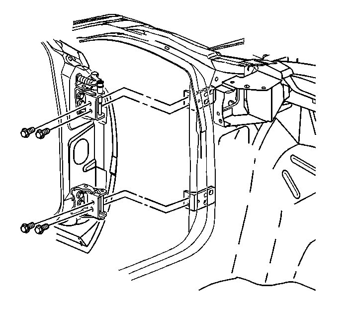

How to remove and replace left passenger door.
Jan 4, 2020 at 2:30 PM
  • 110,244 POSTS
The door is held on by hinges. They unbolt from the body of the vehicle. I don't have directions for door replacement, but I do for hing replacement which requires you to take the door off the car. The only thing is if there is wiring going to the door. In that case, you will need to remove the door panel and disconnect the components and route the wiring out of the door.
Here are the directions I have. The attached pics correlate with the directions.

FRONT SIDE DOOR UPPER HINGE AND LOWER HINGE REPLACEMENT
Front Side Door Upper Hinge and Lower Hinge Replacement
Removal Procedure
Note: In order to minimize door realignment, do not remove both door hinges at the same time. Do each door hinge separately, and replace the broken door hinge first.
pic 1
1. Open the front door.
2. Support the front door.
3. Remove the intermediate hinge bolts from the front door hinge.
4. Move the door as far as the rubber conduit will allow.
5. Clean the mounting surfaces of the hinges with a clean rag and mark the front door hinge locations on each surface with a grease pencil or other suitable marker.
6. Remove the bolts from the front door side hinge.
7. Remove the door side hinge.
8. Remove the bolts from the bodyside hinge.
9. Remove the bodyside hinge.
Installation Procedure
pic 2
1. Position the bodyside hinge to the alignment marks.
Caution: Refer to Fastener Caution (See: Vehicle > Vehicle Damage Warnings > Fastener Caution).
2. Install the bolts to the bodyside hinge.
Tighten the bolts to the bodyside hinge to 33 Nm (24 lb ft).
3. Position the door side hinge to the bodyside hinge.
4. Install the intermediate hinge bolts to the front door hinge.
Tighten the bolts to the intermediate hinge to 33 Nm (24 lb ft).
5. Install the door side hinge bolts.
Tighten the bolts to the door side hinge to 33 Nm (24 lb ft).
6. Remove the door support.
7. Inspect the door for proper operation and alignment. Refer to Front Side Door Adjustment (See: Front Door > Adjustments) or Rear Side Door Adjustment (See: Rear Door > Adjustments).
