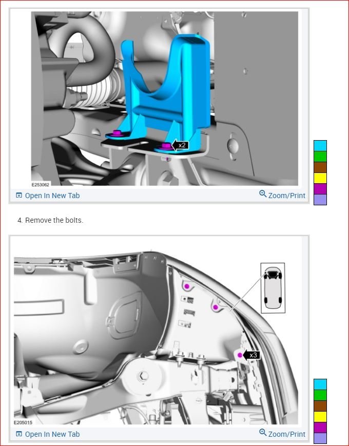

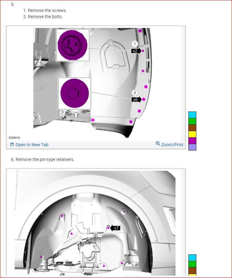

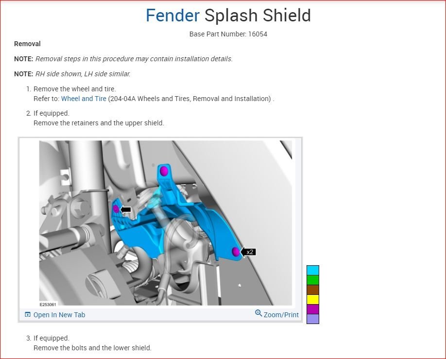

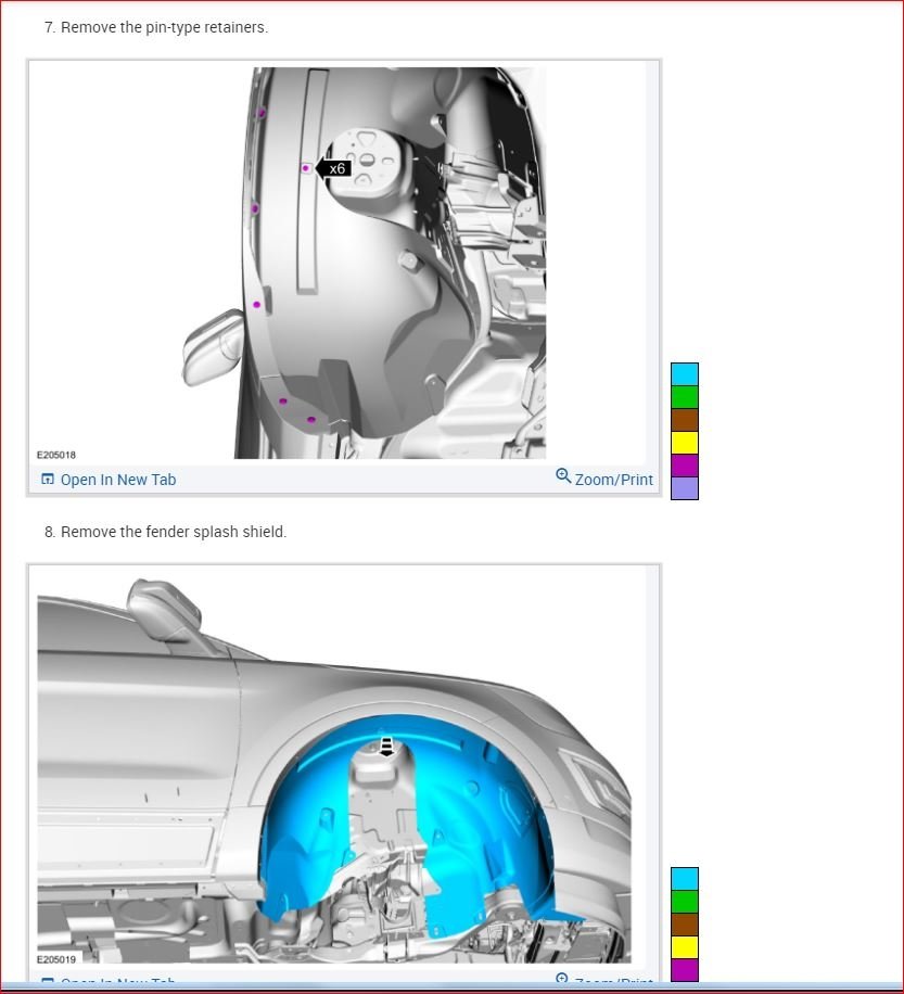

Dented the left front fender above the tire going threw MacDonald's. Need to pop out the dent or remove the panel so we can fix the dent.
Jun 5, 2019 at 12:22 AM
Experienced Mechanic
18,907 POSTS
This is the procedure for the right front but the process is the same side to side. They just pictured the passenger side.
Please let me know if you need anything else. Thanks
