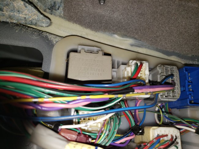

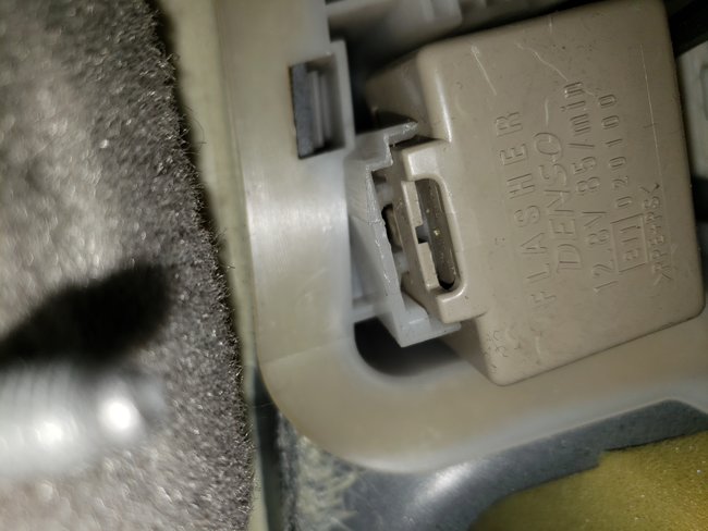

I cannot hear my turn signals.
So, I assume I should replace flasher relay.
I'm not sure how to remove it.
Any help will be greatly appreciated.
Where to buy a replacement.
Pictures are attached.

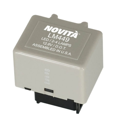

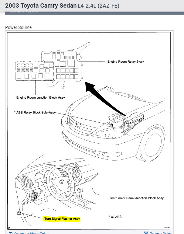

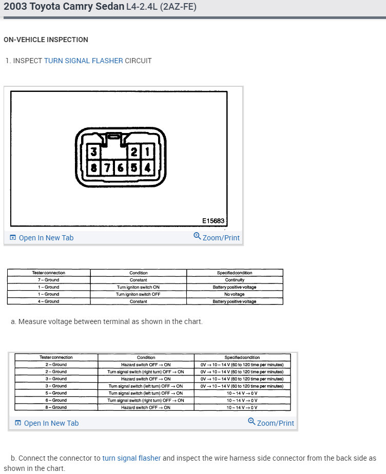

The flasher relay simply pulls out of the socket.
You might have to use a needle nose plier to pull it out, it could make it easier.
These relays are available at many of the local auto parts stores like AutoZone, O'reillys, Napa etc.
I have attached diagrams below for your reference.
