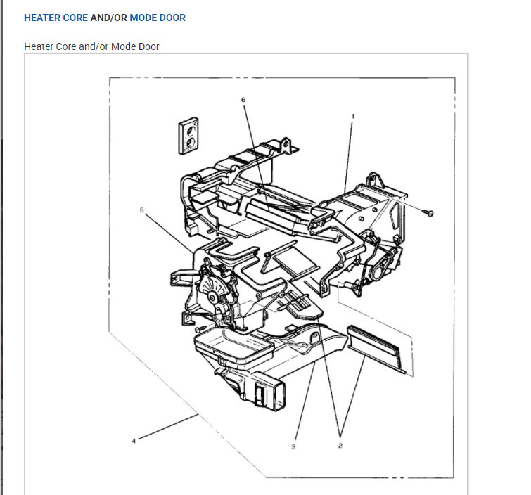

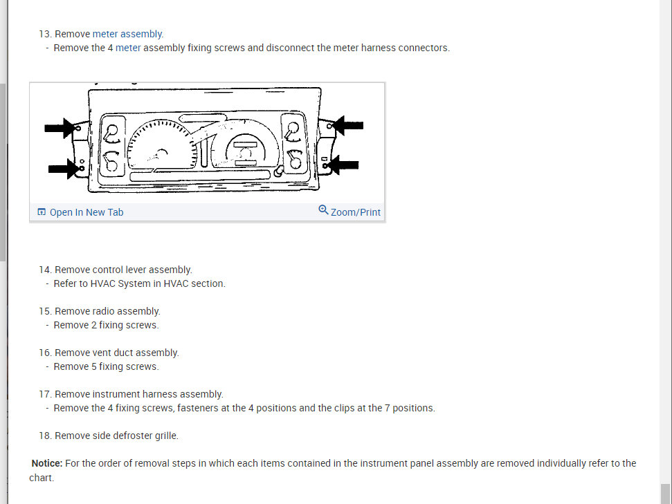

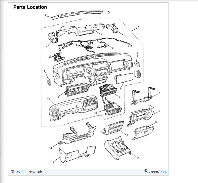

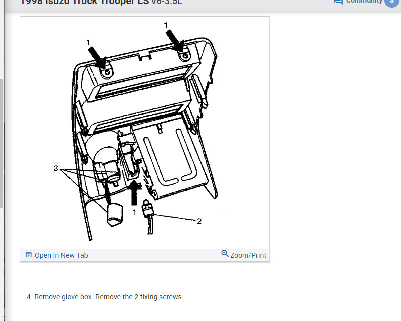

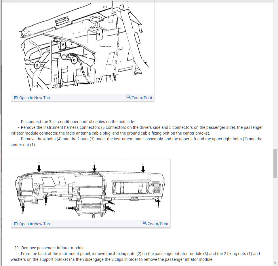

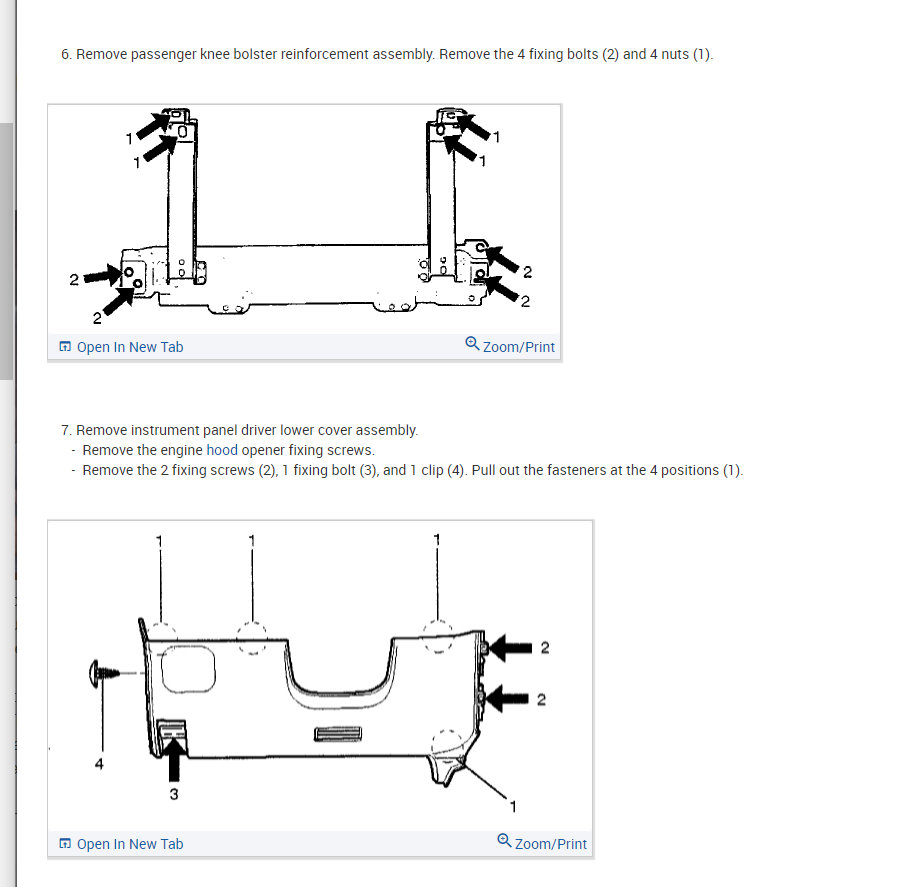

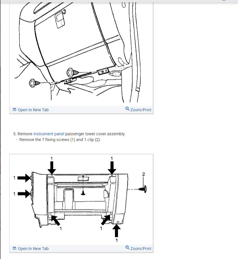

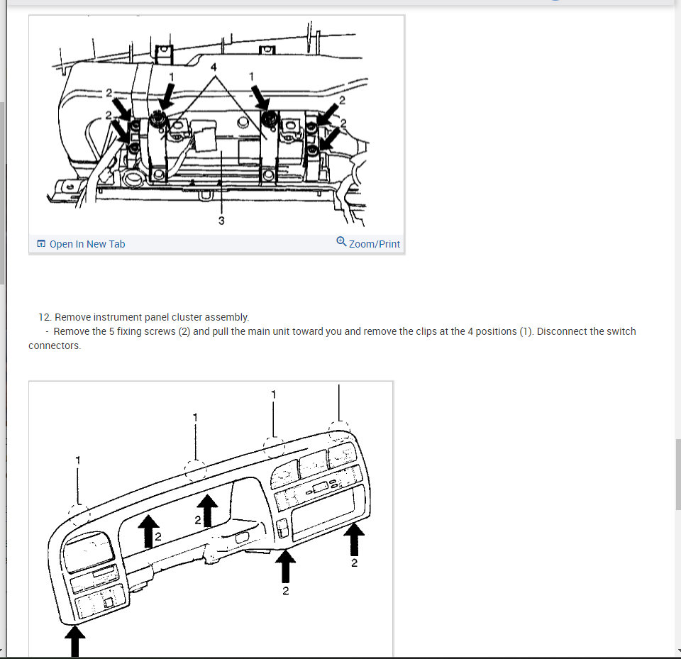

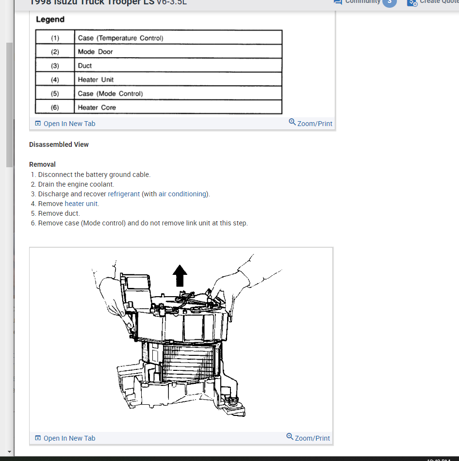

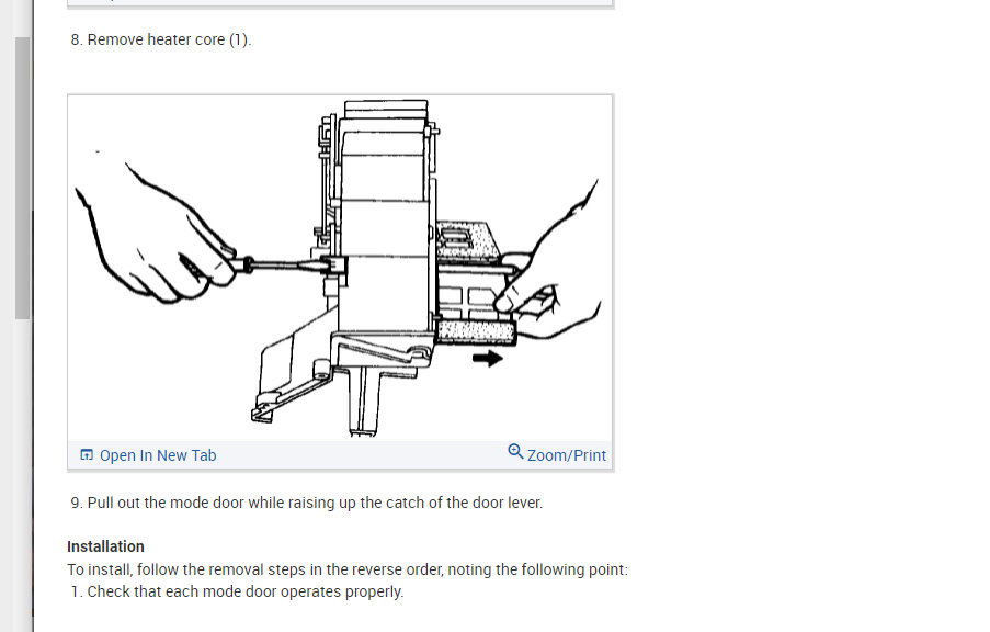

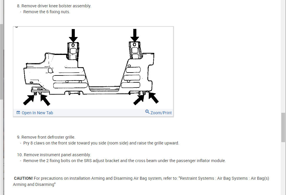

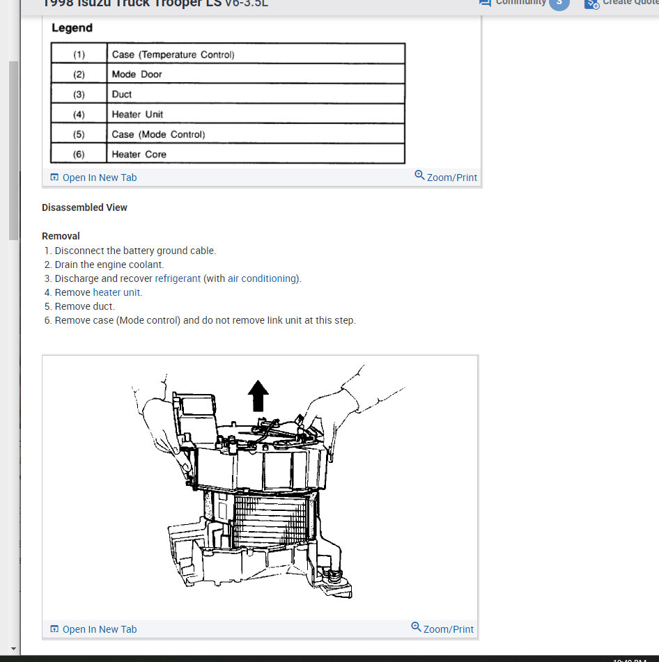

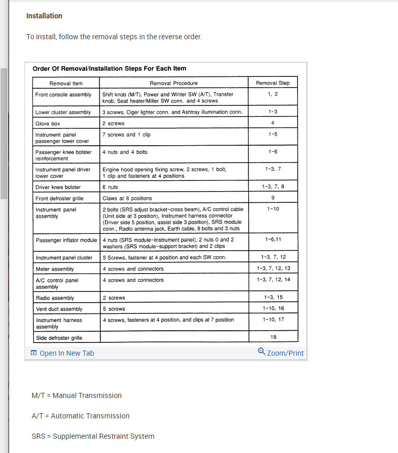

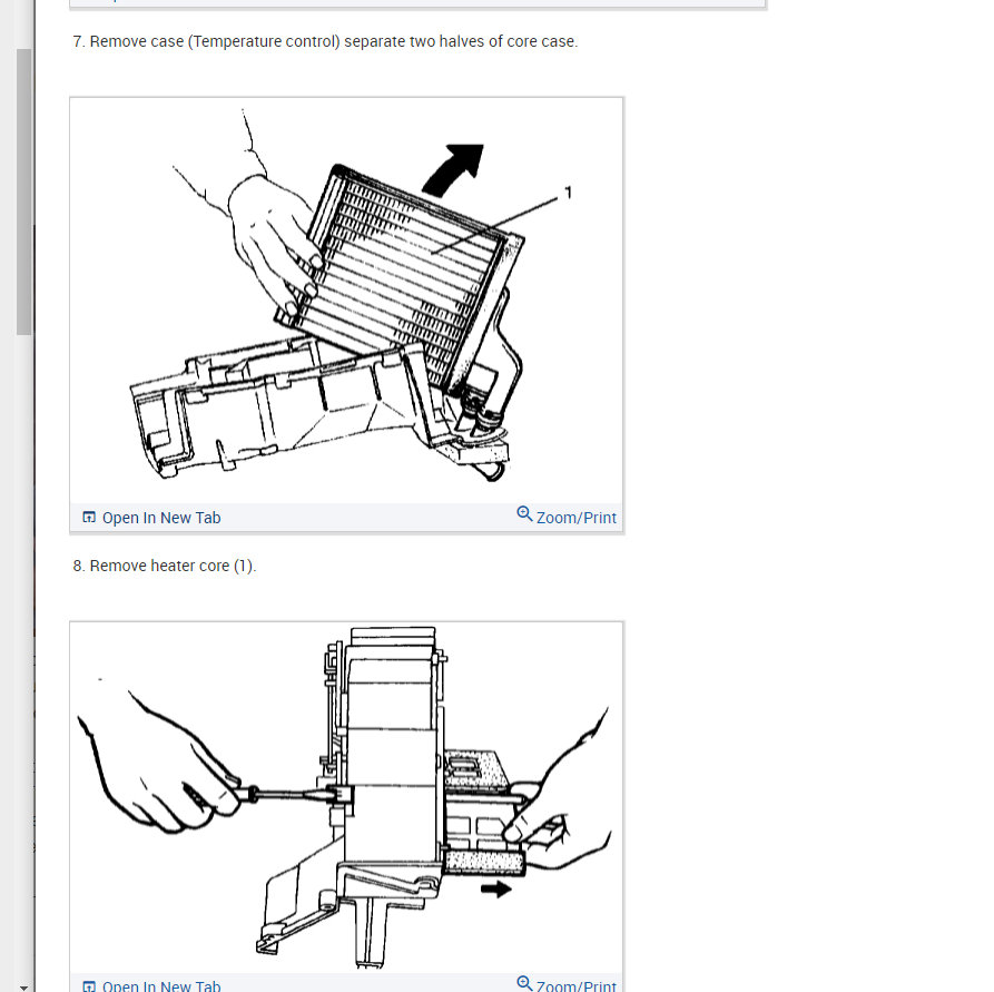

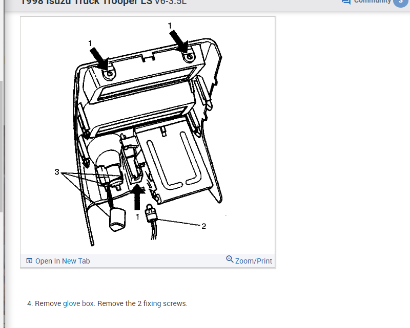

how to remove dash to replace heater core?
Feb 13, 2016 at 8:20 AM
Here is a guide that will help with replacing a heater core. Please review this and the attached material below from the manual:
https://www.2carpros.com/articles/replace-heater-core
You will find the attached process on how to remove the dash and the heater core unit. Then I attached the process on how to remove the heater core from the unit.
Please run through all this material and let us know if you have other questions. Thanks
