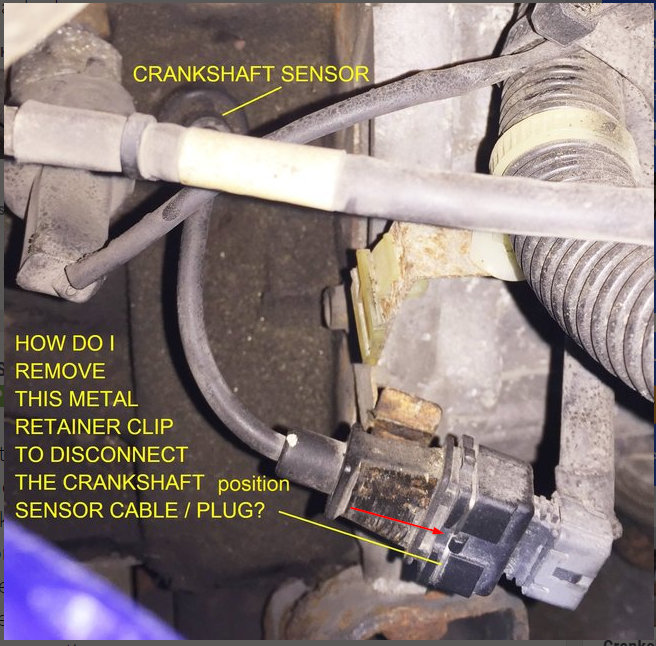

The crankshaft position sensor went bad. A friend told me to be extra careful when removing/disconnecting the crankshaft position sensor cable/plug or it will break. How do I remove the crankshaft position sensor cable/plug properly, any videos? Photo attached.

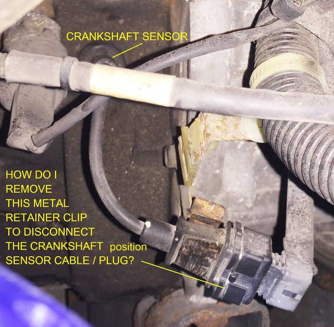

Photo attached.

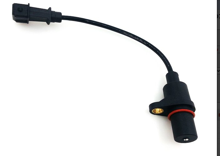

The way to tell how these come apart is to look at the replacement part to determine where they separate. Then if it has a locking tab or clip then they are going to pull off the connector in only one direction. It appears this one pulls off from one of the 2 the larger sides of the connector. I attached a picture below. Please run through this and let us know if you have other questions.

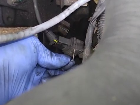

If you can't get it off, put a small flat head under the clip and pry it off and it should pop out as shown by the red arrow on your picture.
