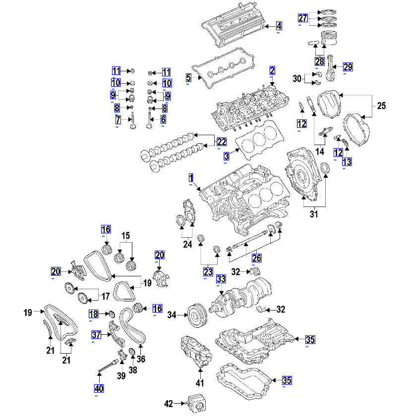

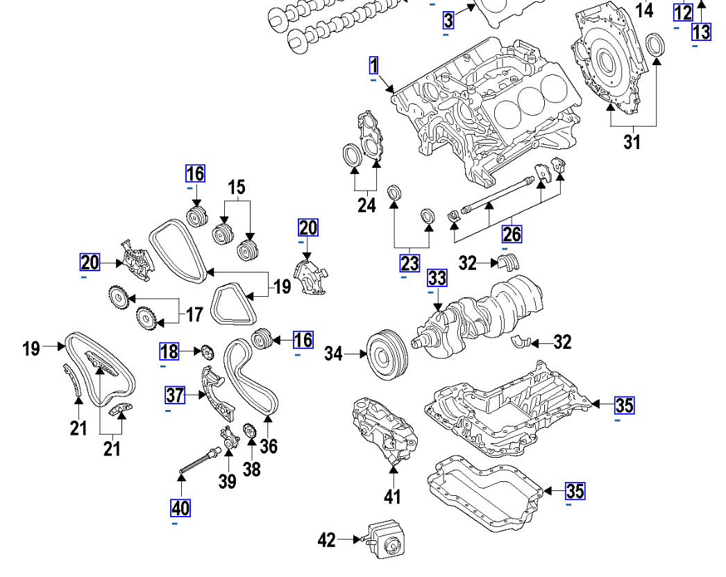

Gotcha, they don't show us much for this, I would get a factory manual for the car.
Crankshaft Bearing Journal Diameter
mm 65.000 - 0.022 - 0.042
Crankshaft Connecting Rod Journal Diameter
mm 56.000 - 0.022 - 0.042
Sorry we were not more help. Check out the images (below). Let us know if you need anything else.
