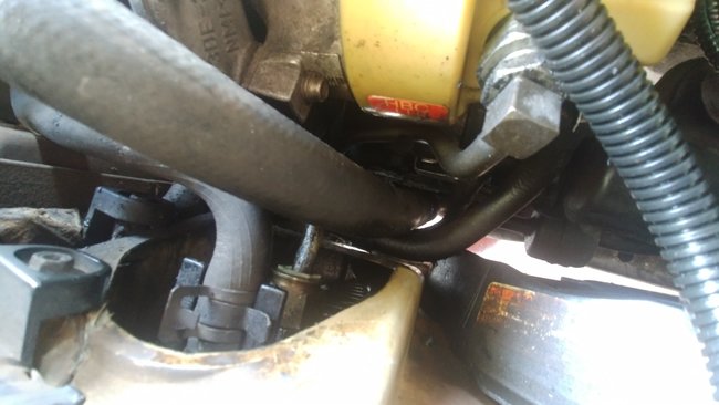

The top transmission cooler line is leaking at the fitting on the radiator. I am sure I just need to replace the fitting, right? Was going to use Dorman #800601 to replace it with and use some thread tape. But how do I get clearance to that line? It seems like an AC hose or something is in the way, it is quite stiff, and the power steering pump too. This is the OHV engine. Picture is attached, it is the brass fitting below the tiny hose from the reservoir.

Yep, that is a tight spot. You will need to remove what you need to to get at the line. To replace the fitting you need the tool. Here is a video to show you how to replace the fittings:
https://youtu.be/Boi0DPXVHbM

What I did was use the really long 22mm Duralast wrench (that I keep for oxygen sensors) and got it out. I used a pick (99 cents at HF) to dig out the "quick connect" plastic piece before hand. Really did not want to drop the radiator for this.
