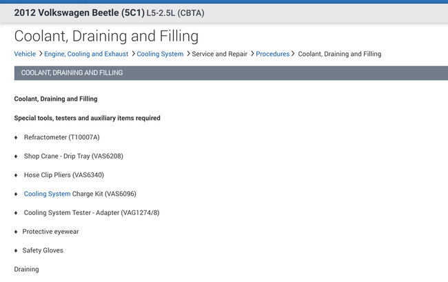

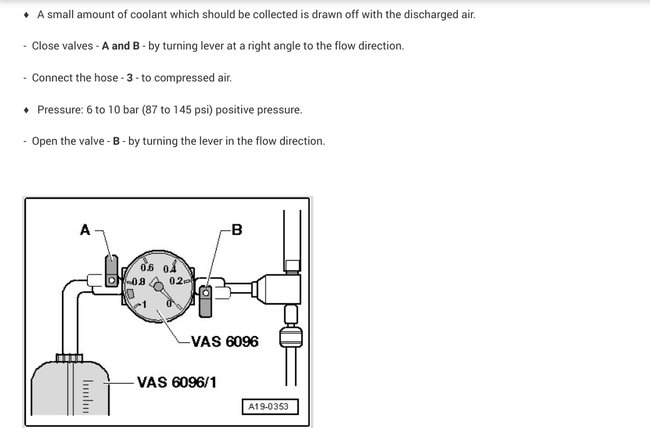

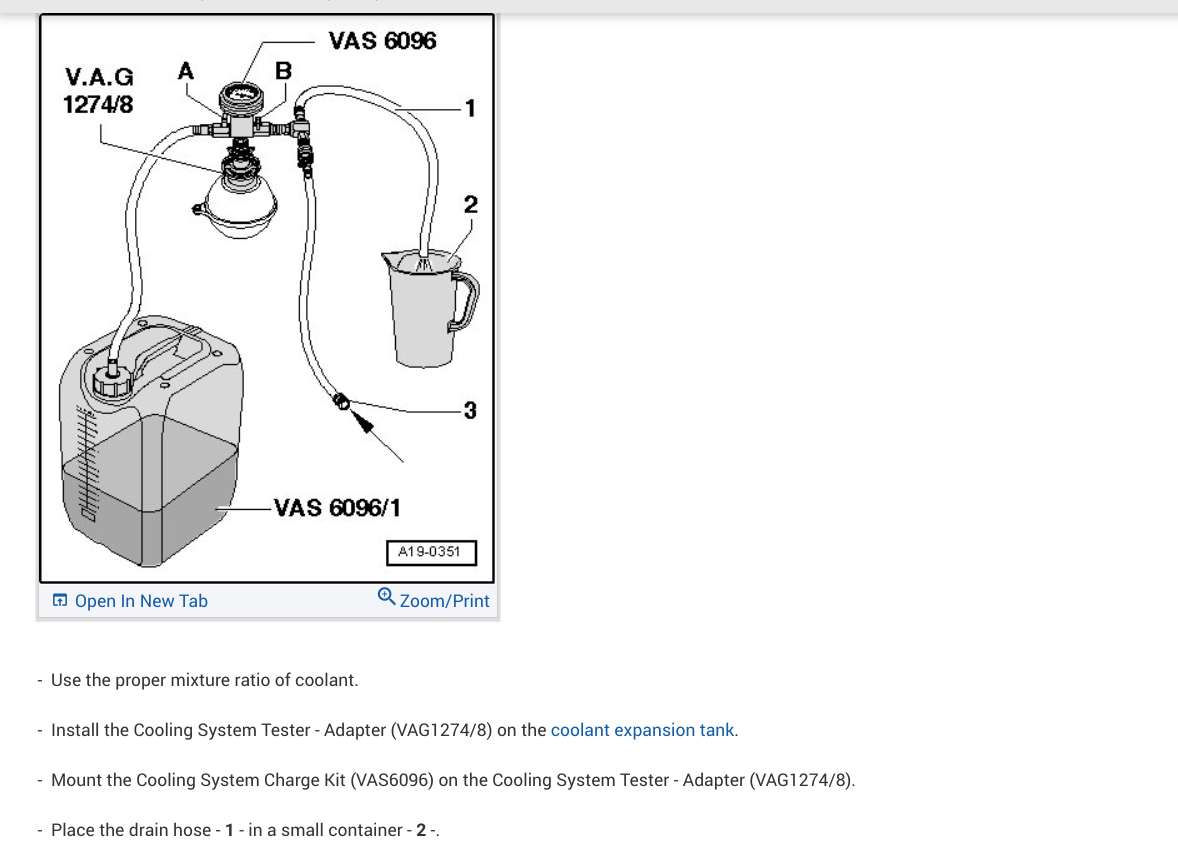

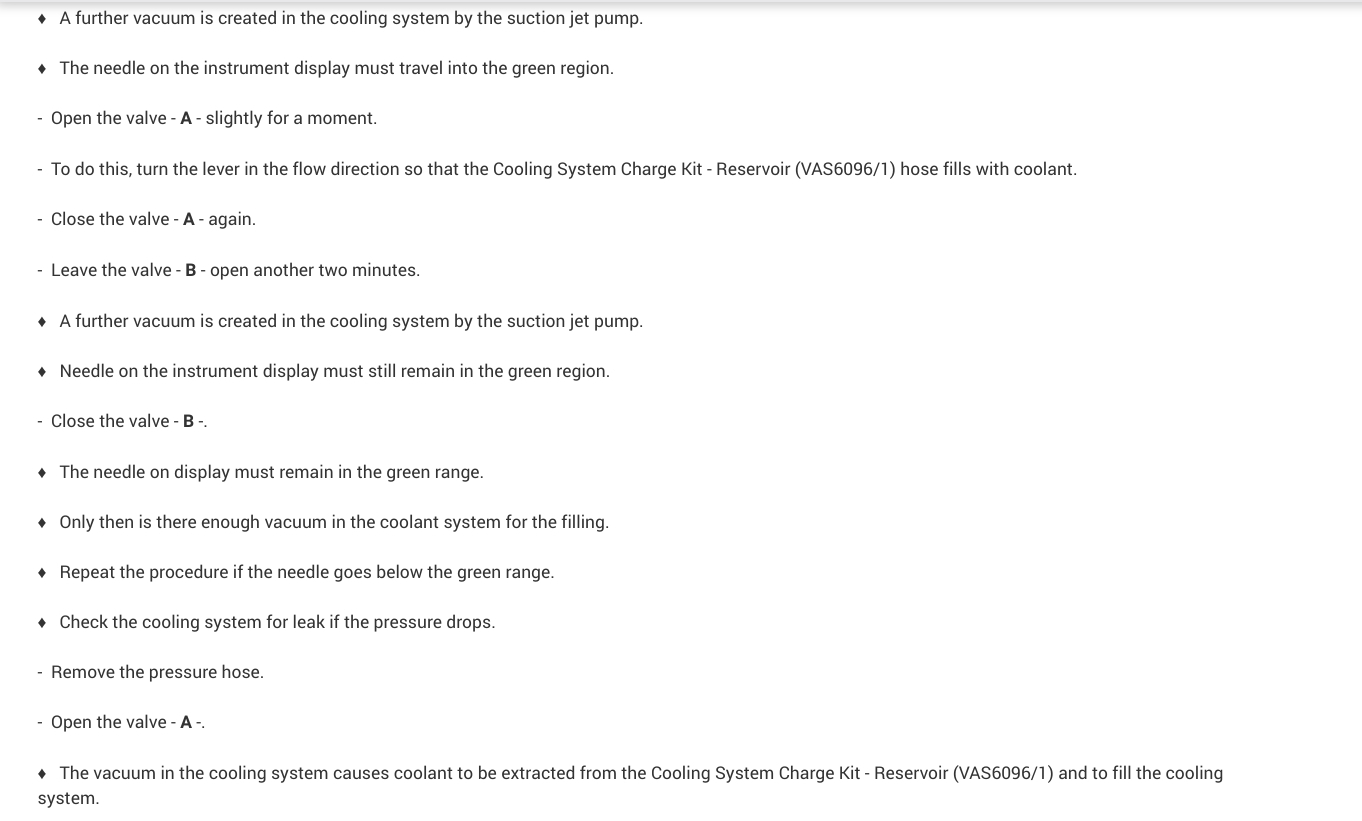

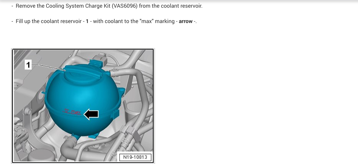

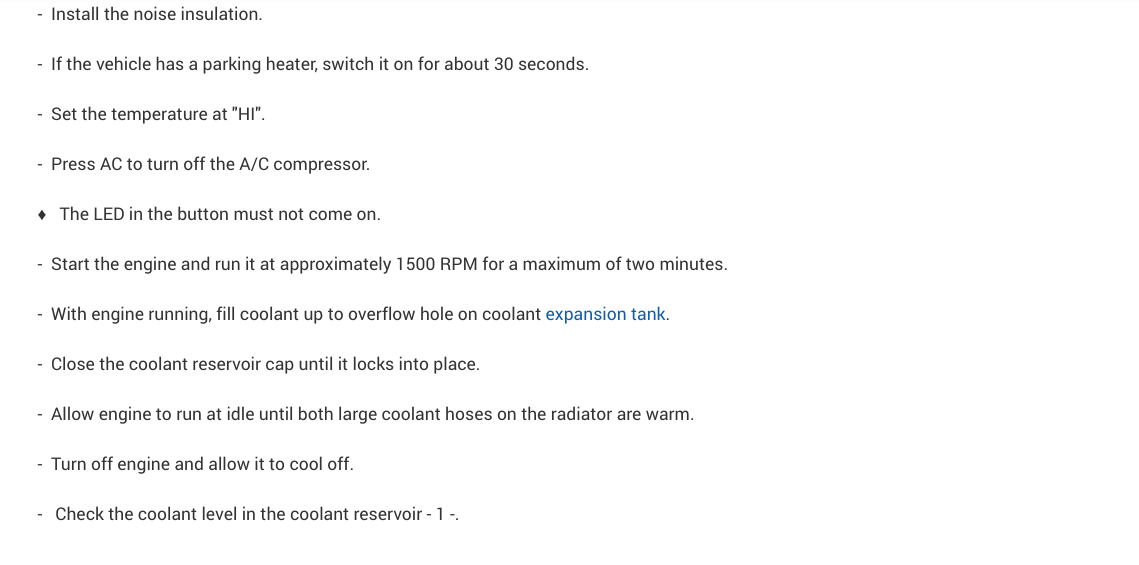

I have a tool that pulls a vacuum on coolant system to avoid air and was wondering how I could get remaining out of block. system holds 9 liters and can hardly get 4 out of it and if you could use g13 instead of g13 they no longer make it.
Dec 28, 2019 at 5:17 AM
SCGRANTURISMO
  • 4,897 POSTS

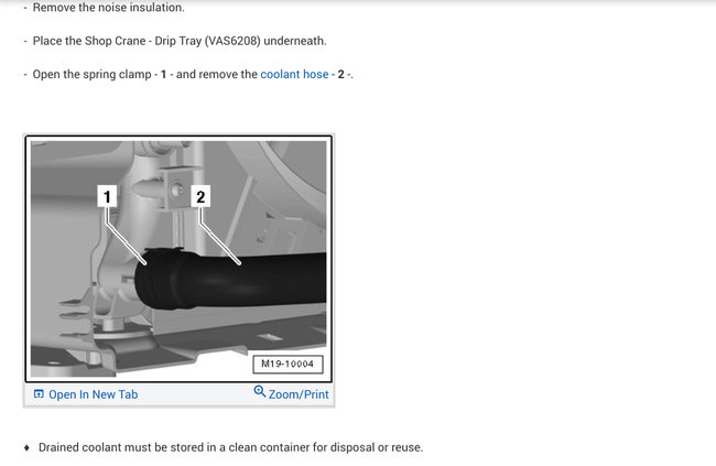

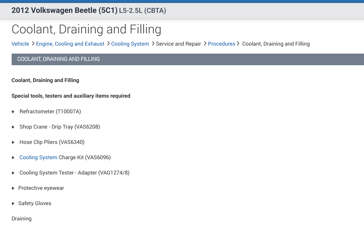

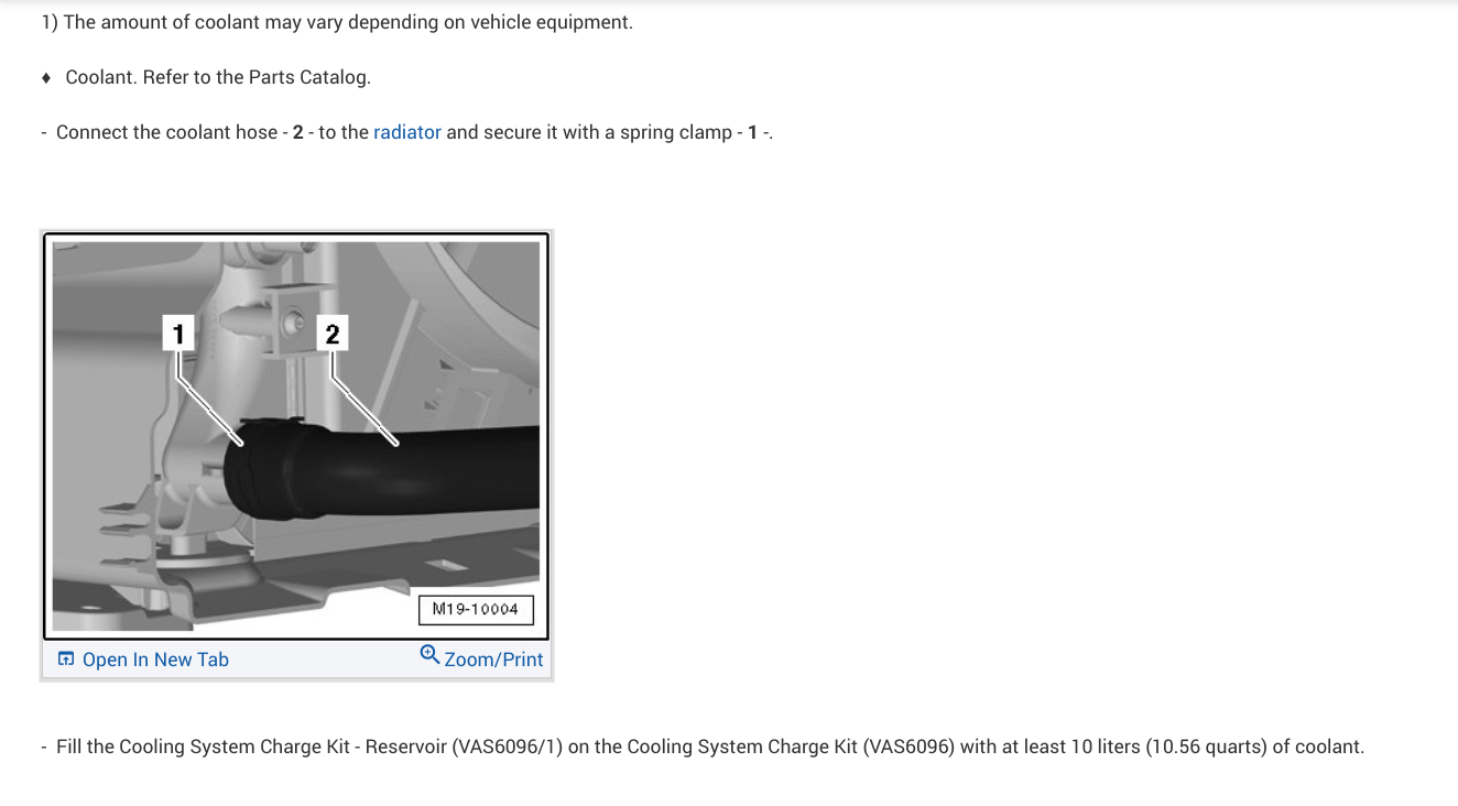

In the diagrams down below I have included the procedures from the vehicle manufacturer on the proper way to drain and fill your vehicle's cooling system. Please go through this guide and get back to us with how everything turns out. I hope this helps and have Happy Holidays.

No. It looks like you just undue the bottom radiator hose and this should allow all of the coolant to drain from the system. The instructions sent earlier are straight from the vehicle manufacturer, and this is what they recommend.

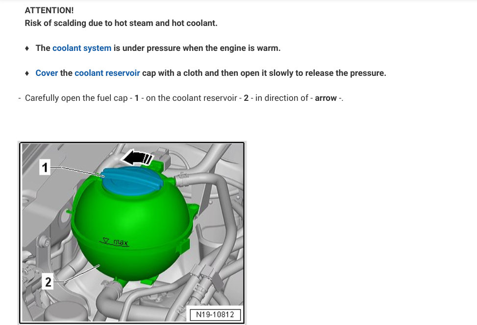

If this is the lowest spot on the cooling system, then it is going to be where to drain the system at. Fluids, by nature will always go to the lowest point of anything. Do you have the pressure released in the system? This would cause the system not to drain completely.

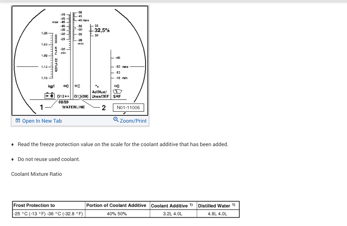

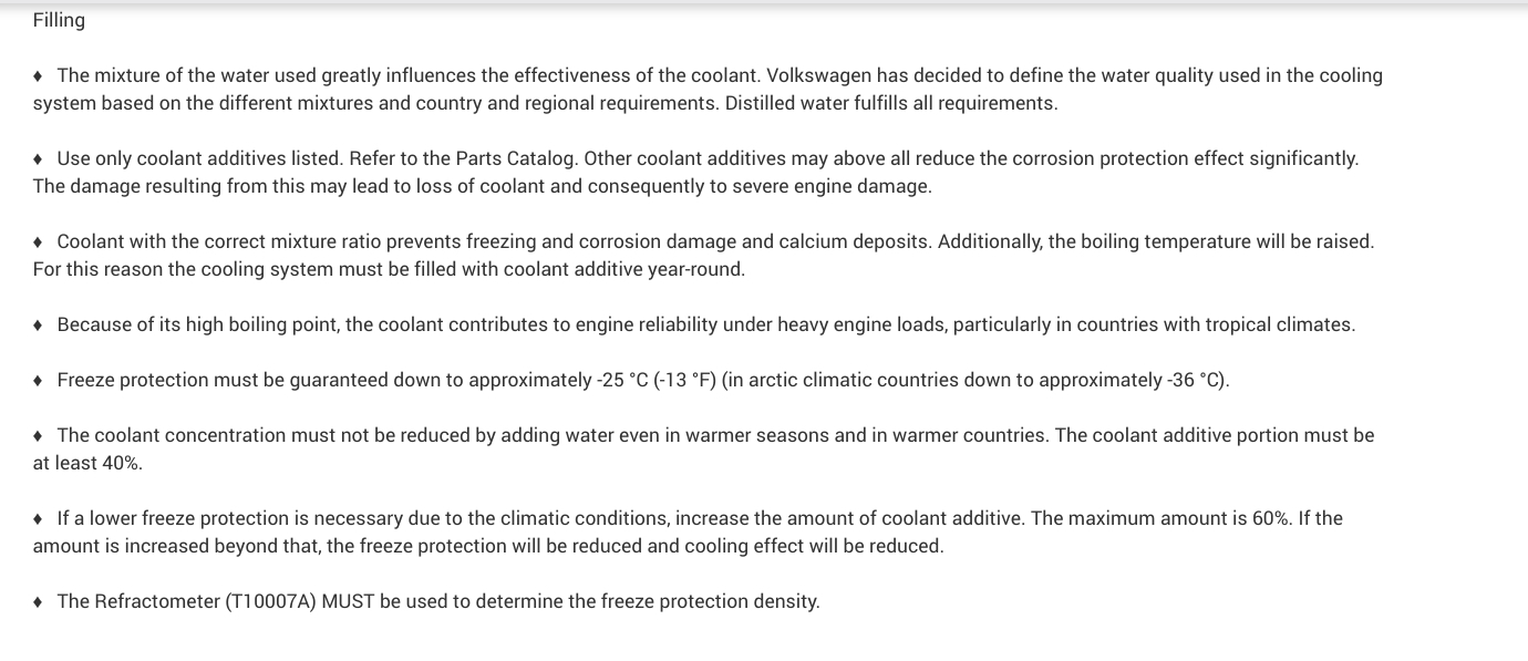

Yes and would putting g13 in it hurt it? it say g12 on reservoir but can’t seem to fine it anywhere.
Dec 29, 2019 at 11:18 AM
SCGRANTURISMO
  • 4,897 POSTS
Hello again,
It should be. They have the same cooling abilities the main difference is that G12 uses glycol and G13 uses glycerin, which is better for the environment than glycol.

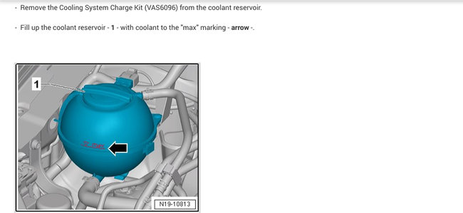

Should I rinse it or just drain and fill?
Dec 30, 2019 at 12:33 AM
SCGRANTURISMO
  • 4,897 POSTS
Hello again,
Either way should be fine. If you decide to do a flush and fill. here is a link below that explains the process:
https://www.2carpros.com/articles/coolant-flush-and-refill-all-cars
Please get back to us with how everything turns out.

AUDREYJACOBS
The procedure will not drain engine block. Plug has to be removed from block to accomplish this.
