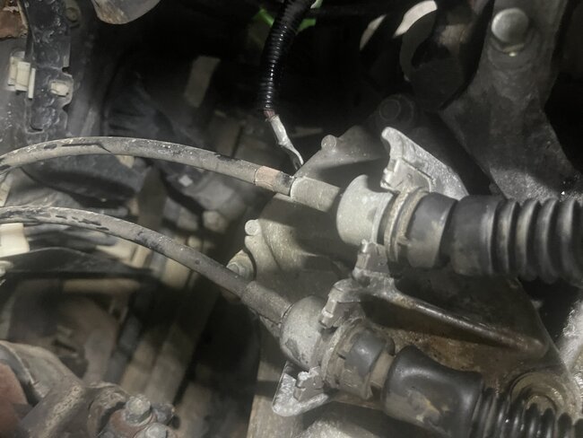

You ever replaced or removed these cables? I cannot tell how these clips are holding the cables down.

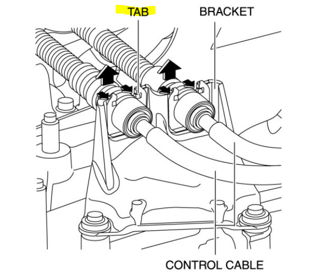

As far as removal, press the tabs on the control cable and disconnect the control cable from the bracket. See pic below.
Try this and let me know if it helps.
Take care.,
See pic below.
