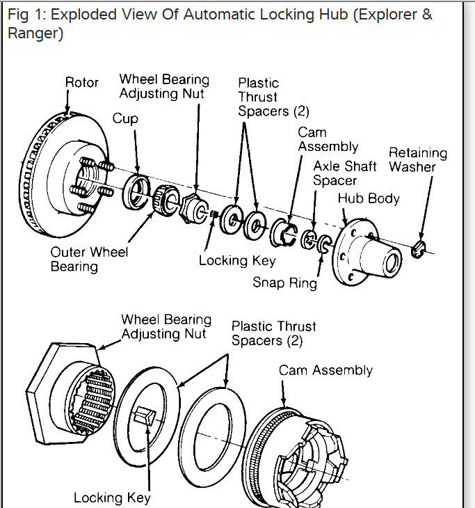

How to remove an automatic locking hub to change rotors
4WD • AUTOMATIC
FORDLOVER143

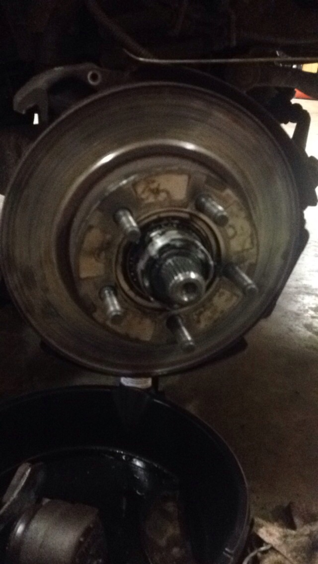

We need to get to thw rotors to change them and removing the hub seems to be the hard part. No videos on the internet seem to show the same hub. Any help you have would be greatly appreciated.
Jun 30, 2015 at 4:37 AM
HMAC300
  • 48,601 POSTS

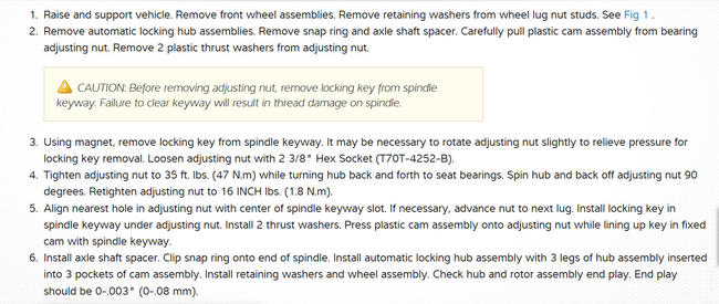

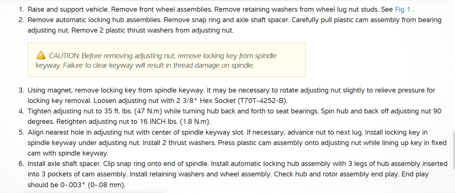

It can be a little tricky but here are diagrams to help you get the job done. Check out the diagrams (Below). Please let us know if you need anything else to get the problem fixed.
