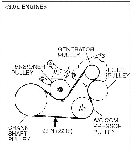

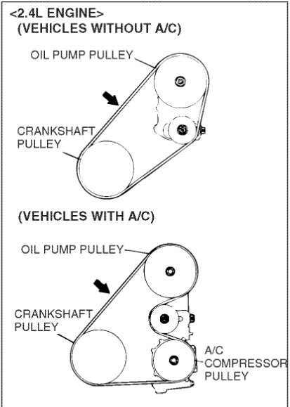

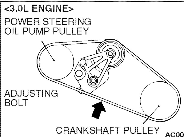

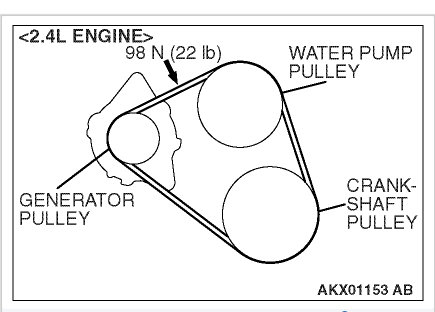

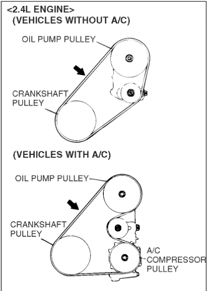

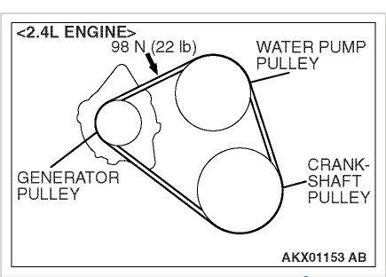

How to replace belts both of them?
Sep 6, 2019 at 8:37 AM
DANNY L
Experienced Mechanic
5,648 POSTS
Hello, I'm Danny.
Here is a tutorial that shows what is involved:
I've attached pictures below of its description/diagram. I've included both the 2.4 liter and 3.0 liter engines since you didn't specify yours.Hope this helps and thanks for using 2CarPros.
