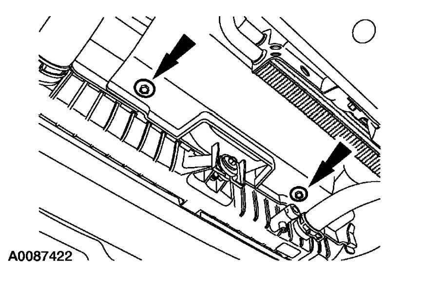

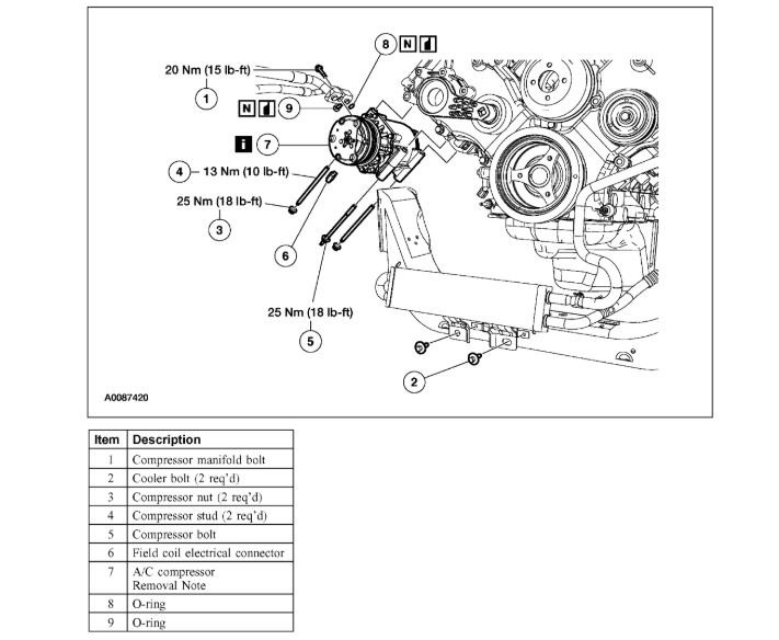

AC compressor is blowing hot air. Clutch on AC compressor not working. How to remove AC compressor from top or under vehicle to put on new one?
Jun 22, 2018 at 2:51 AM
Good evening.
The compressor comes out the bottom and it is very tight.
Procedure below and pictures attached.

4. Remove the parts in the order indicated in the illustrations and tables.
To remove individual parts, only carry out the listed steps.
Item 7: A/C Compressor Removal Note

1. Remove the lower fan shroud to access the A/C compressor. Remove the nuts.

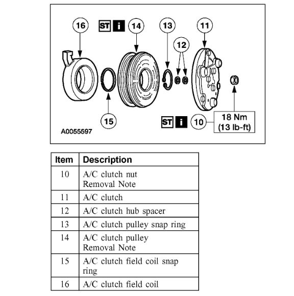

Item 10: A/C Clutch Nut Removal Note
imageZoom/Print
1. Remove the A/C clutch nut.
1 Using the special tool, hold the clutch plate.
2 Remove the nut.
Item 14: A/C Clutch Pulley Removal Note
imageZoom/Print
1. Caution: Do not use air tools. Damage to the A/C clutch pulley or A/C compressor may result.
Using the special tool, remove the A/C clutch pulley.
