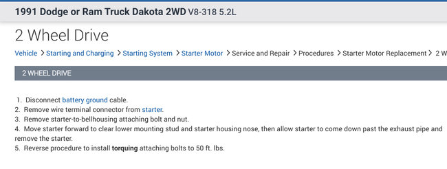

i can't figure out how to remove the starter to install a new starter?

In our reference material we do not show any listings for a 4.7L engine for a 1991 Dodge Dakota. Here is a link to guide explaining how to remove and install a starter motor below. It is a fairly easy and straight forward operation.
Please go through the guide and report back on how everything turns out.

It has a 5.2, but what you just sent me does not explain on how to remove it.

Okay, sorry about that. In the diagrams down below I have included the instructions from the vehicle manufacturer for the removal and installation of the starter motor for your vehicle. Please go through this manufacturer's guide and get back to us with how everything turns out.
