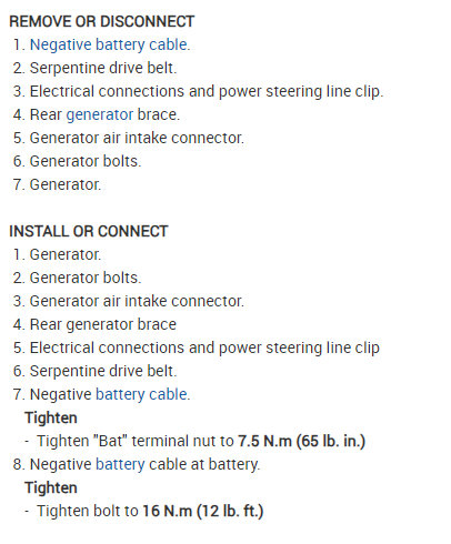

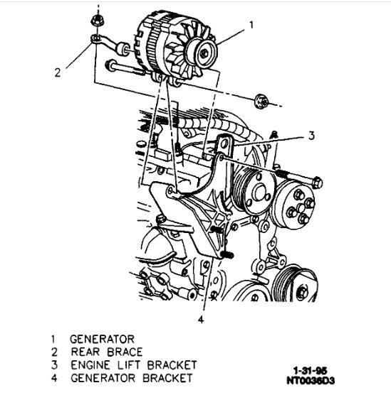

Alternator replacement, how to remove Alternator on the car listed above GT?
Sep 1, 2024 at 1:14 PM
  • 110,248 POSTS

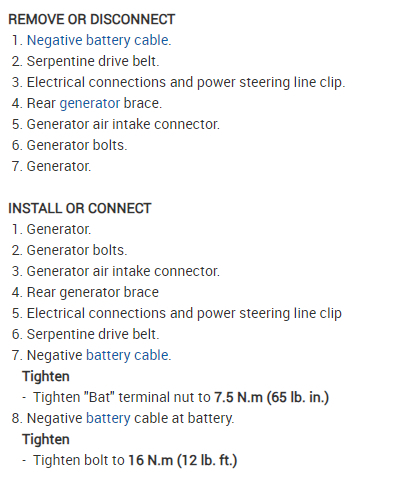

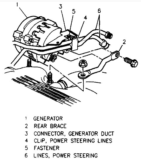

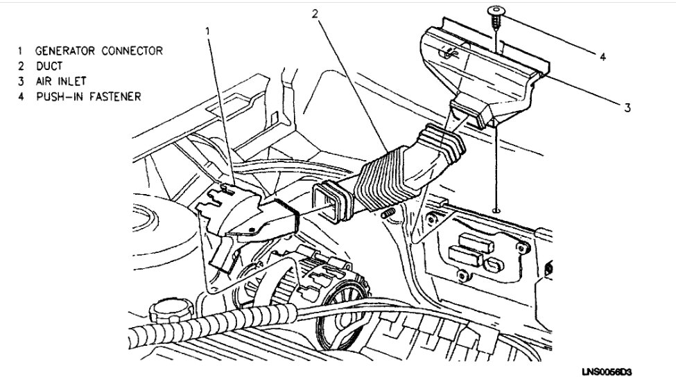

I attached the directions and pictures from my manual (see below). They are helpful, but I feel somewhat vague. Take a look at them and let me know if you have questions.
Also, here is a link that explains how it is generally done:
https://www.2carpros.com/articles/how-to-replace-an-alternator
Make sure the battery negative cable is disconnected before you start working on the alternator. There is a power supply to it that is straight from the battery.
Let me know if this helps.
