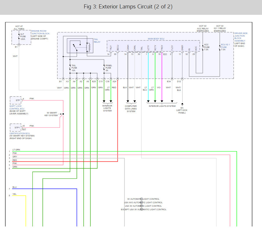

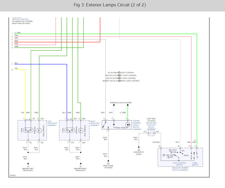

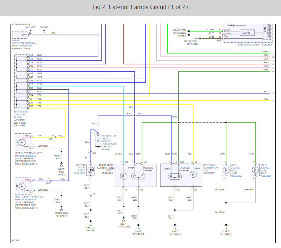

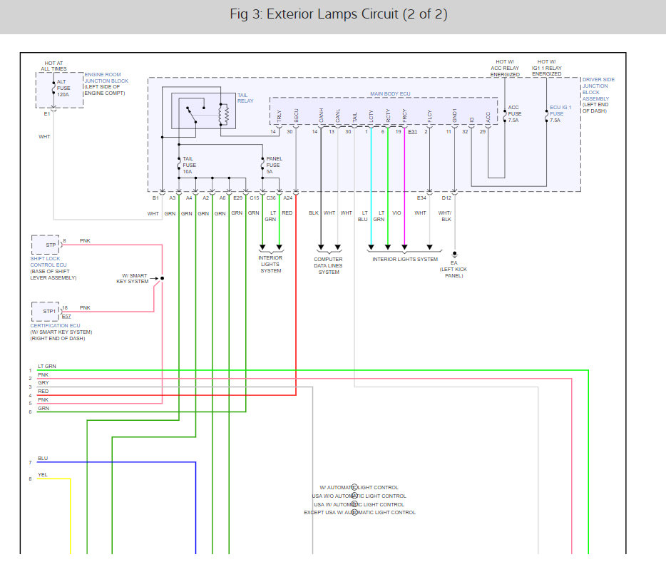

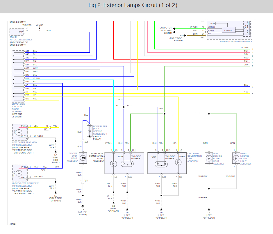

I have some problem with headlight and blinker lights. Sometimes when people help me and send to me wiring diagram is difficult to understand what the numbers, letters and some symbols mean.
Mar 23, 2020 at 12:36 PM
  • 110,244 POSTS

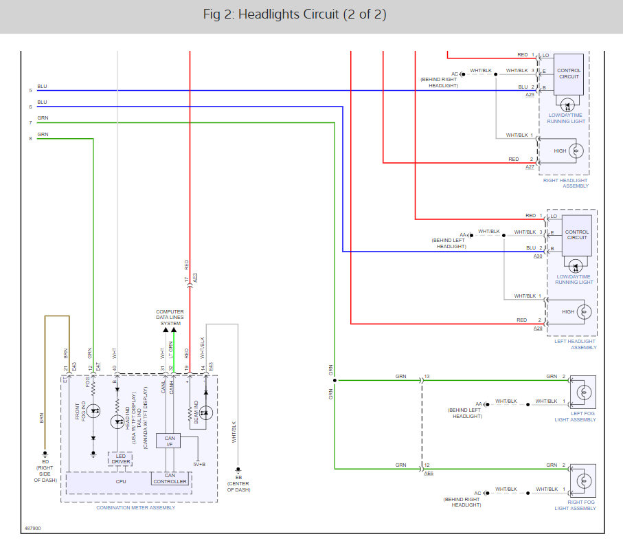

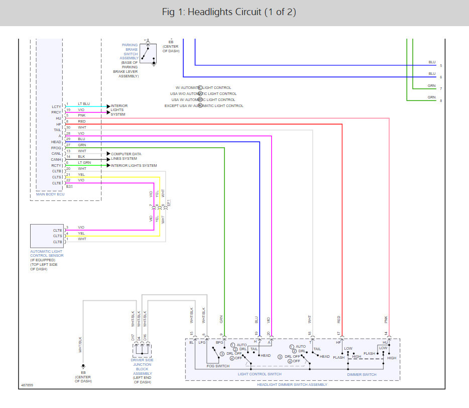

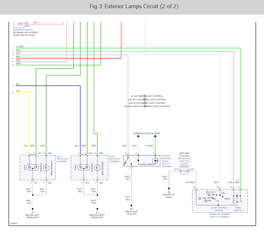

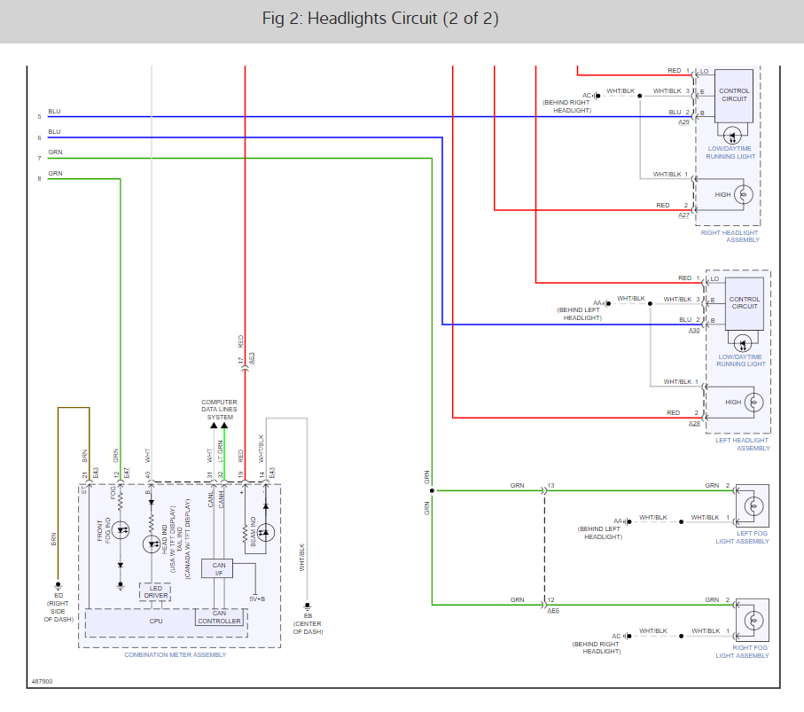

Numbers can refer to pins in a harness, the fuse amperage, and so on. As far as the letters, it's the same. Now, if you don't recognize symbols, if you look online for automotive schematic symbols, it should help.
Here is a guide to help test with the blinker and headlight diagram below.
Let me know what is going on. Maybe I can help.
Mar 24, 2020 at 5:51 AM

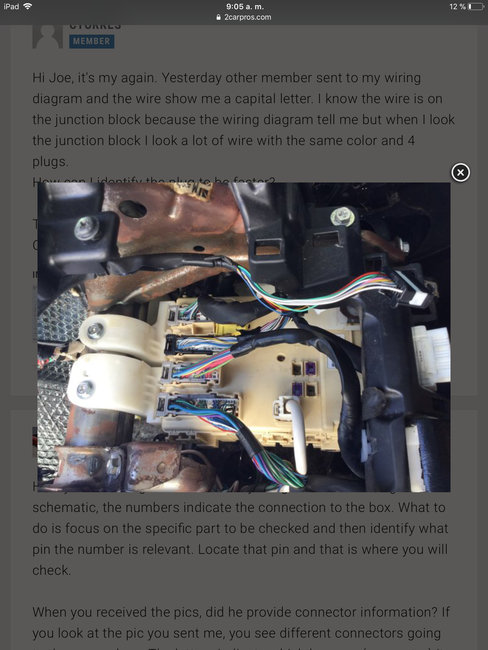

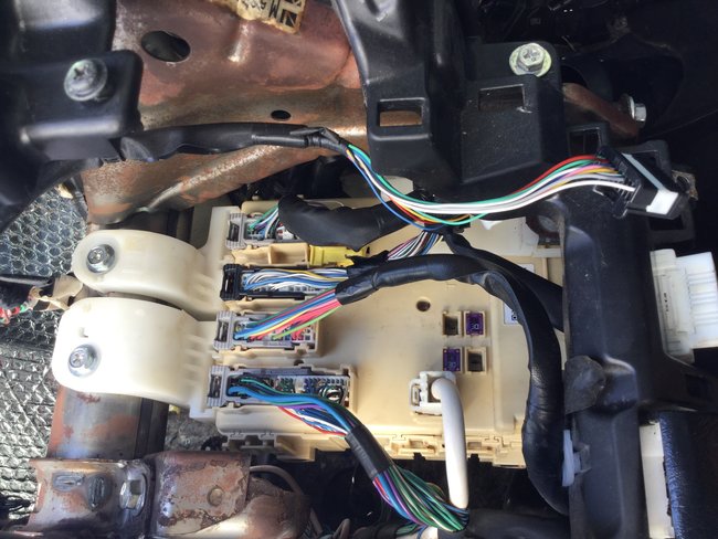

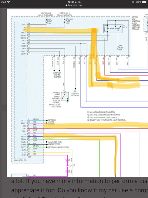

Hi Joe, it's my again. Yesterday other member sent to my wiring diagram and the wire show me a capital letter. I know the wire is on the junction block because the wiring diagram tell me but when I look the junction block I look a lot of wire with the same color and 4 plugs.
How can I identify the plug to be faster?
Thanks for your time.
CTORRES
Mar 24, 2020 at 6:30 AM
  • 110,244 POSTS
Hi, my friend. I'm glad to hear from you again. When looking at the schematic, the numbers indicate the connection to the box. What to do is focus on the specific part to be checked and then identify what pin the number is relevant. Locate that pin and that is where you will check.
When you received the pics, did he provide connector information? If you look at the pic you sent me, you see different connectors going to the same place. The letters indicate which harness (connector) it goes to.
Let me know if that helps you.

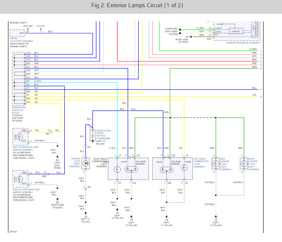

Talking about my question I want to tell you when he sent me the picture he did not give me information the connector. Passed a lot of time and I found the connector and performed operational test. But I wish perform all troubleshooting faster.
Right now I know about the color, number pin and location system, but is very hard to understand harness (connector) need to work.
Can you give me an example with the picture I sent? Which is the connector for my example.
Exp: Locate the 2 wires yellow. E39, E24 on junction block.
Thanks again for your time and patience.Take care.

Are there any identification marks on the connectors?
Mar 26, 2020 at 8:45 AM
CTORRES
  • 67 POSTS
Morning. Well, I have been searching some identification marks on the connector or junction box surface but I didn’t find anything.

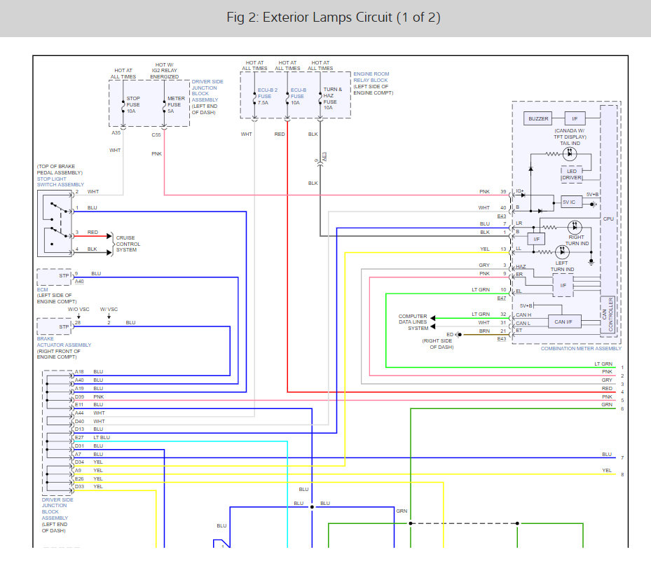

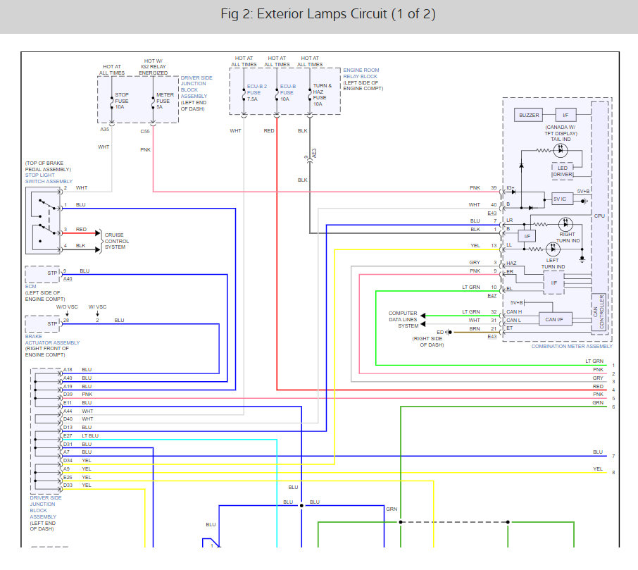

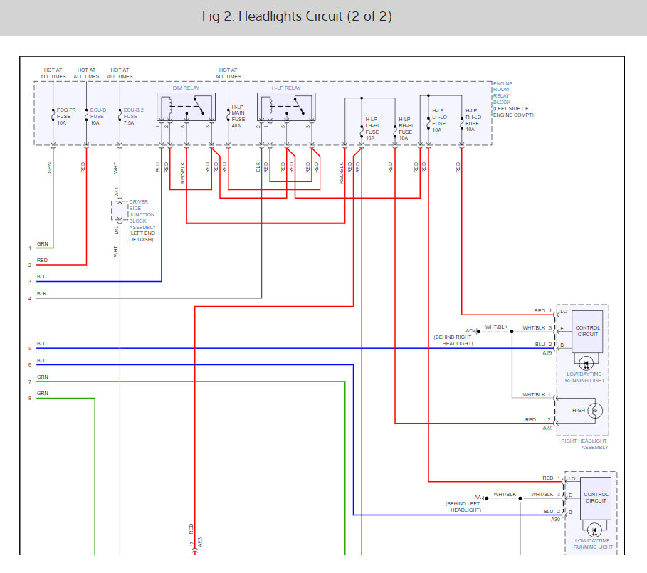

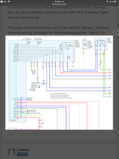

If I can jump in here. It seems like you do not have the entire wiring diagrams so they are confusing. here is a guide to help you with the testing and the complete lighting wiring diagrams so you can see how the system works and which wires to test:
Can I ask what kind of problems you are having? Check out the diagrams (below). Please let us know what you find. We are interested to see what it is.

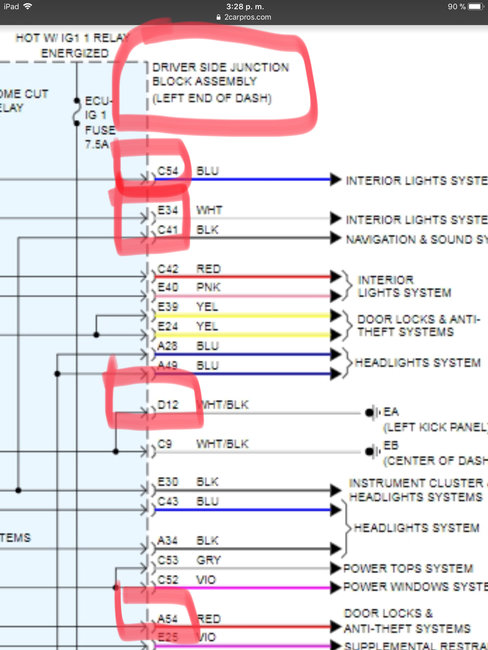

Morning Ken. well I appreciate your time and want to tell you the link you sent me was amazing I learned a lot of things I didn’t know.
But I still don’t understand how can you identify faster the connector the pic show me.
For instance I need identify on pic (blue wire D37 tail fuse) on the junction block. When I lock the junction box there are 4 connector and a lot of blue wires. I can find the wire but I wish identify faster the connector and wire to perform the test.
I don’t know if the capital letter “D” meaning the plug.

That is when a connector view is handy. All of the connectors will be slightly different shapes or keyed different to keep them from being installed wrong. Also many times you can ID a connector using the wire colors that are next to other wires.
That said, could I ask what the issue you are having with the lights is? That might help narrow down the correct connector numbers and wires.
