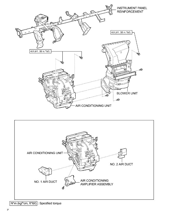

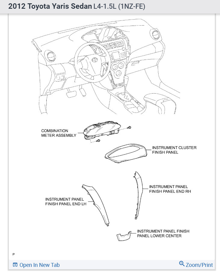

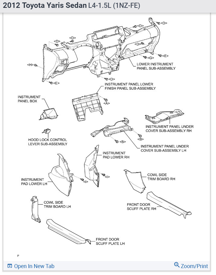

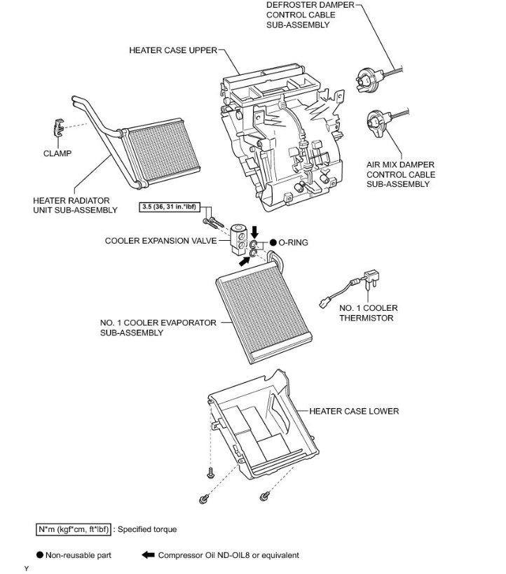

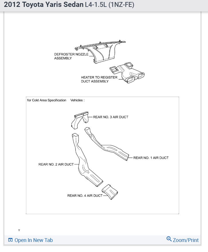

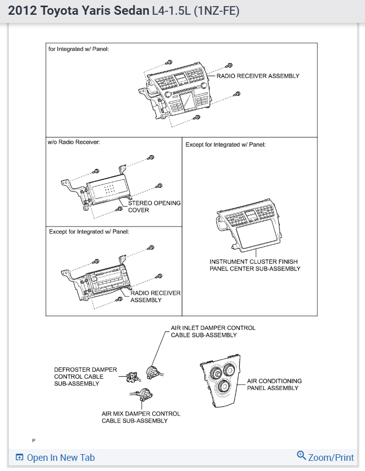

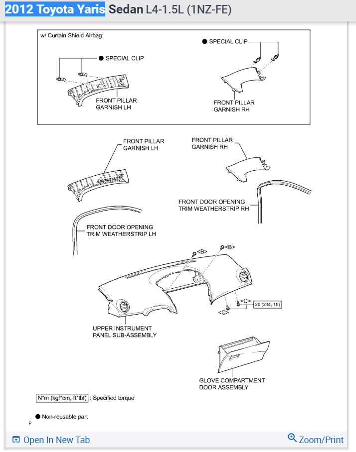

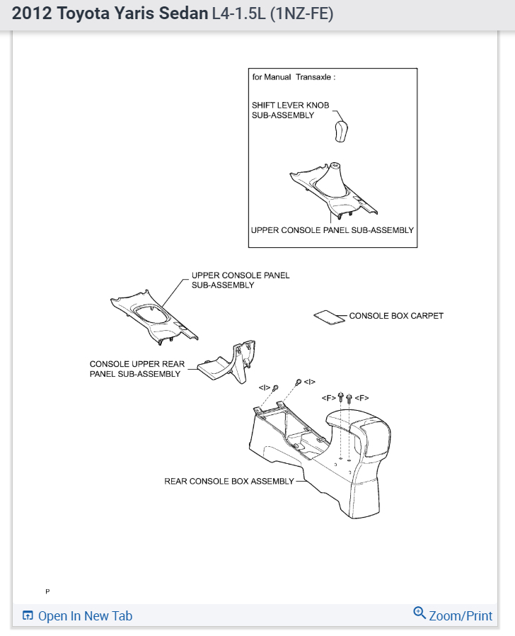

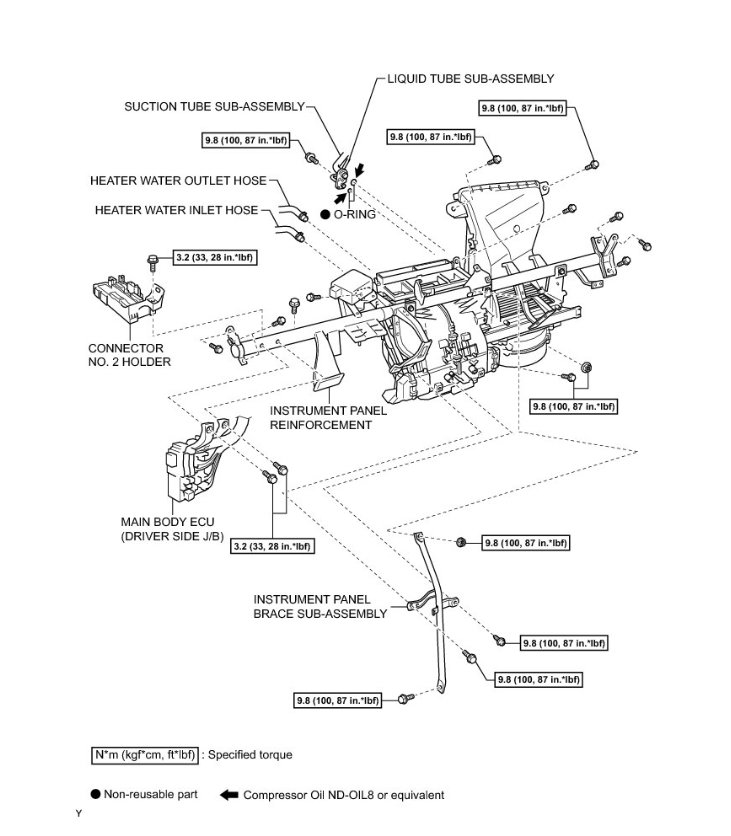

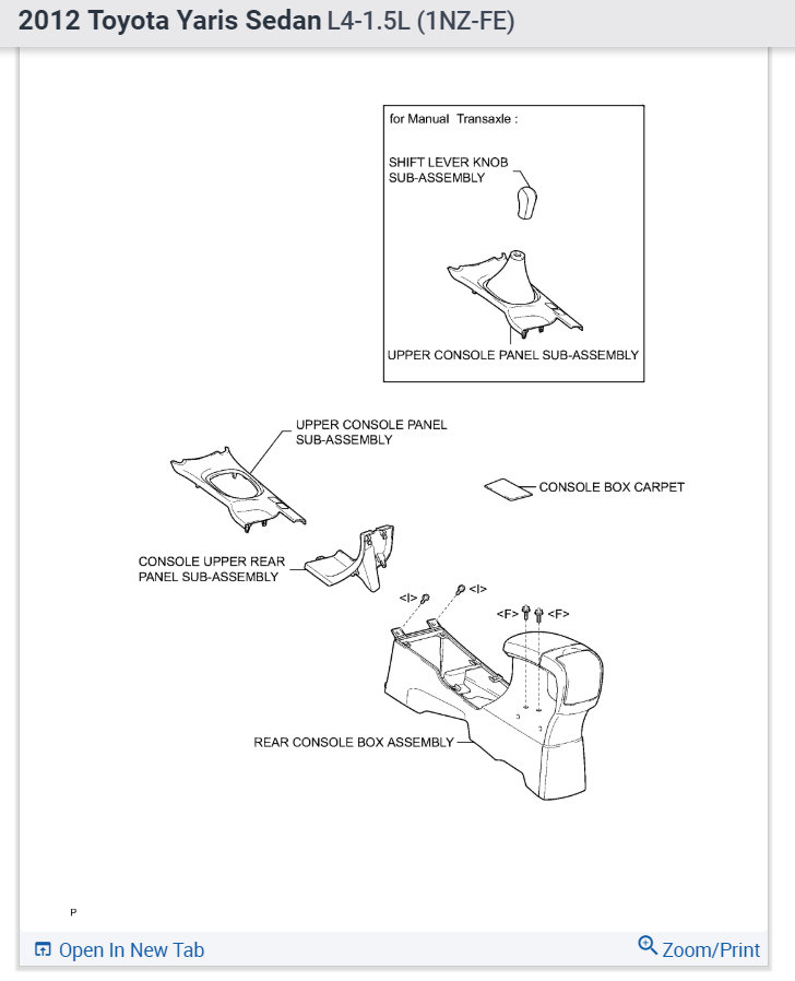

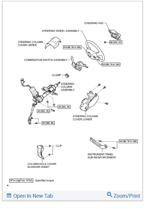

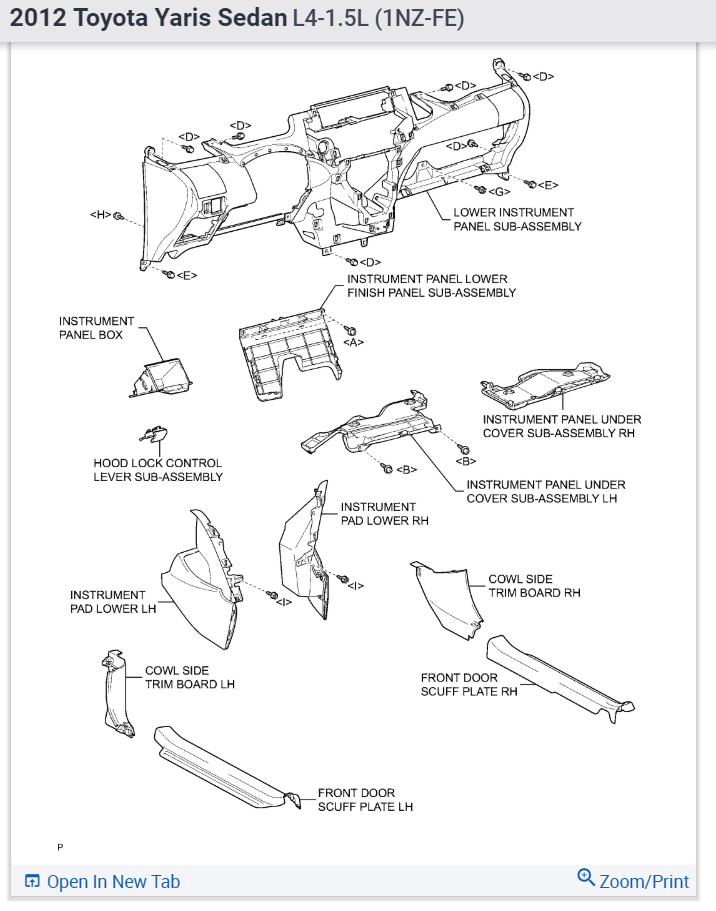

Need step by step pulling dash out so I can get to heater core.
Oct 1, 2018 at 3:55 PM
  • 54,832 POSTS
You will need to evacuate the A/C system and drain the coolant. Disconnect the battery as well.
Here are the diagrams and instructions below on how to remove the dash and replace the heater core there are many so check out each one. Also if you get stuck please take video or images of the problem and upload them here.
