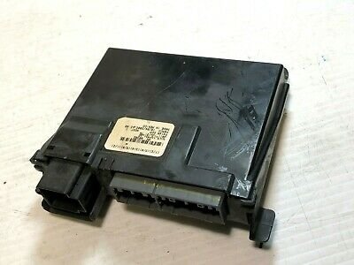

Part # 3W1t-13C791-AJ. I have found similar parts but not the exact same part number. Will other part number's work and where is the best place to find one?

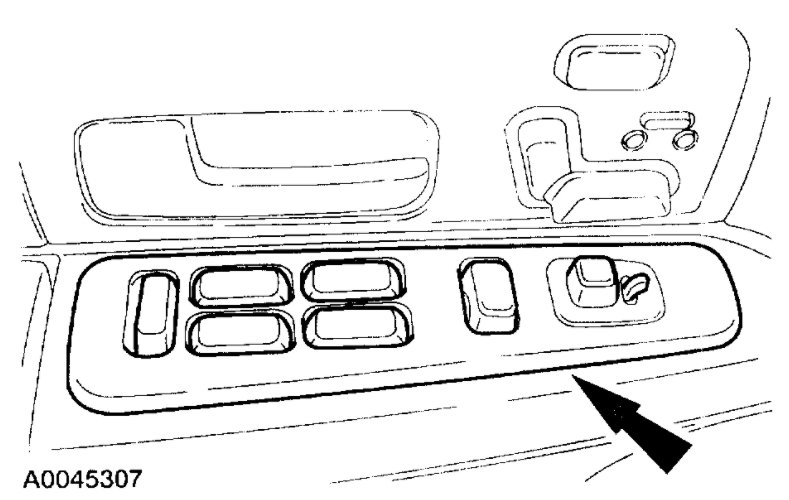

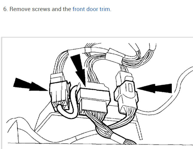

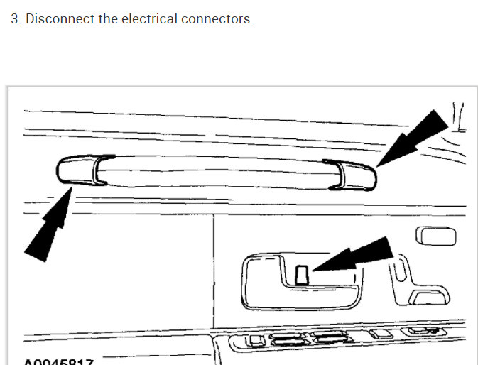

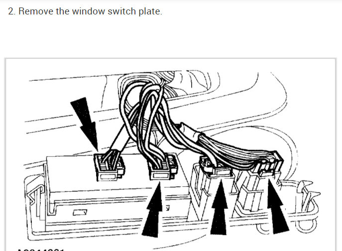

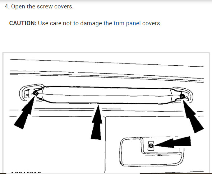

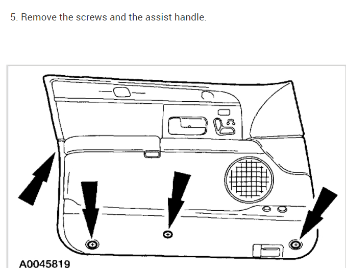

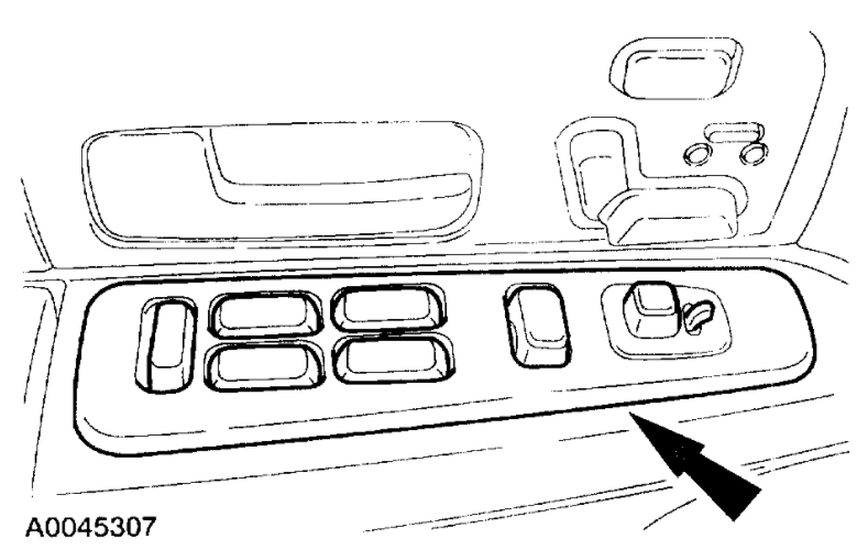

Have you taken the door panel off to verify the part number on the module? Here is a tutorial showing how to do so:
https://www.2carpros.com/articles/door-panel-removal
I've attached picture steps below for your car how to remove the panel. The part number for the module looks real close and only off by 1 letter which is 3W1T-13C791-AH. I've attached a picture of that below as well. Keep us updated. Hope this helps and thanks again for using 2CarPros.

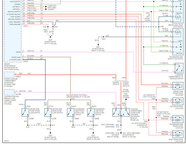

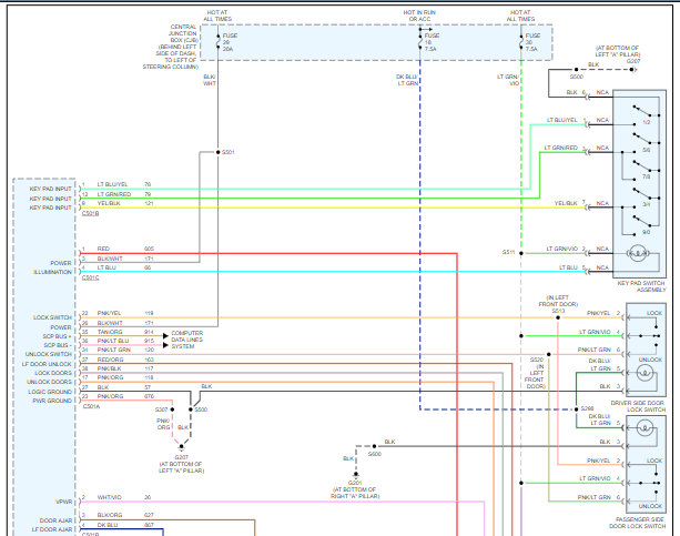

I have just used Forscan to check for DTC's there are no errors so before I buy a replacement it appears there is an open circuit going to the locks. Sometime they all function properly then the circuit quits again. Do you have the wiring diagram that controls the circuit? Or any other suggestions for troubleshooting would be helpful.
Thanks,
Charlie
Nov 5, 2020 at 3:01 AM
DANNY L
  • 5,648 POSTS
Hello again.
Okay, here is the wiring diagram you requested. I've cut it in half so you can view larger so it overlaps. Keep us updated as to what you find and we'll go from there. Hope this helps and thanks again for using 2CarPros.
