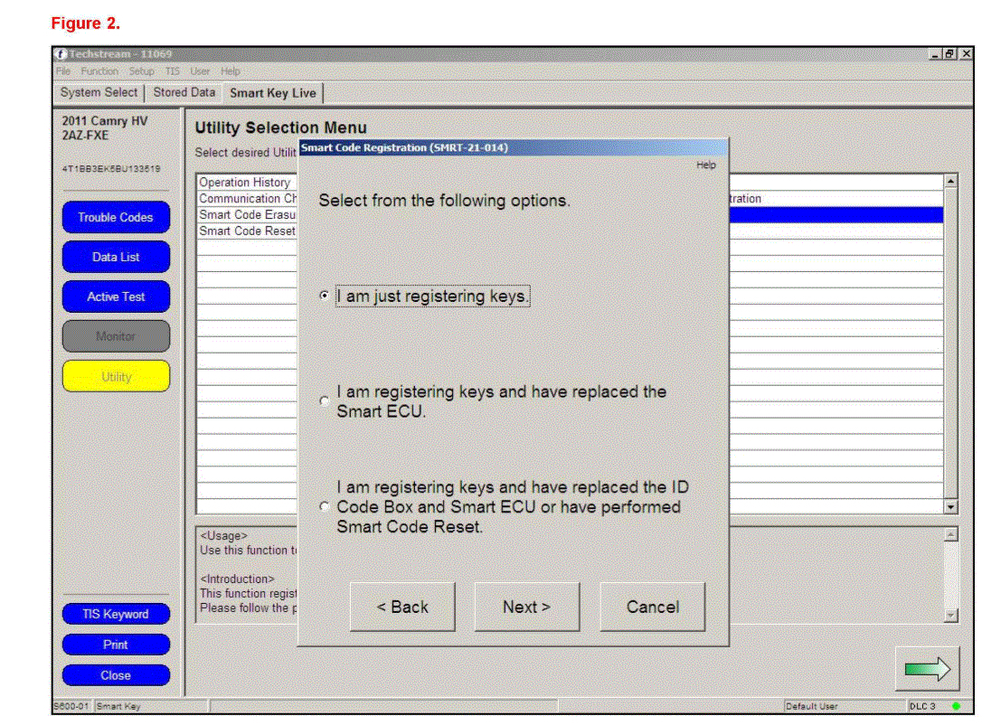

This really isn't a DIY on this vehicle. To make things even more difficult, there was a change to the frequency used (AM or FM) based on production date. If you look through this technical service bulletin, it describes how to add one or two new fobs and update the system. However, it requires specific tooling. The attached pics correlate with the directions. Note that this indicates a fob that is inoperative. I realize that isn't the case, but the procedure for reprogramming is relevant.

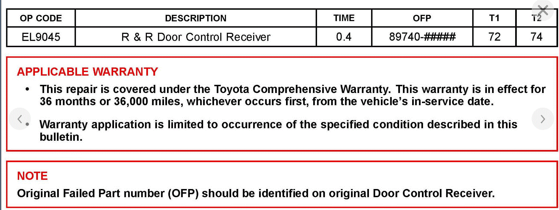

Warranty Information

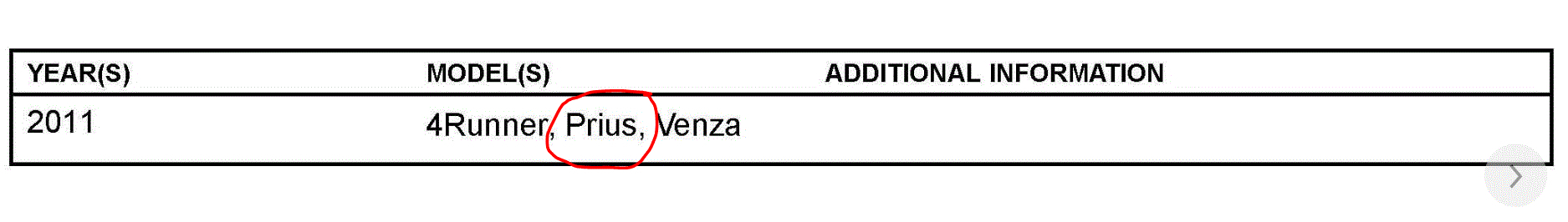

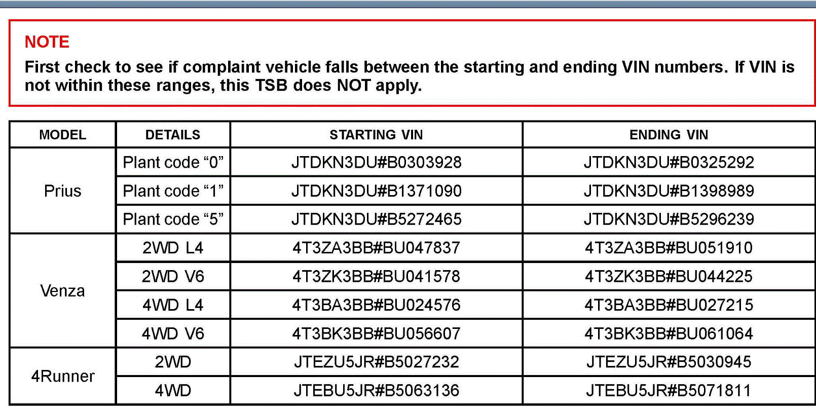

Production Change Information
pic 3

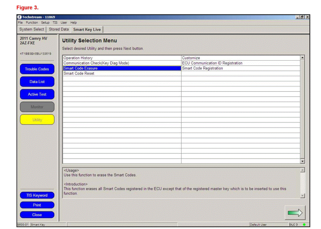

This TSB applies to vehicles produced AFTER the Starting VIN and BEFORE the Ending VIN shown.

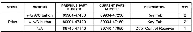

Parts Information
pic 5

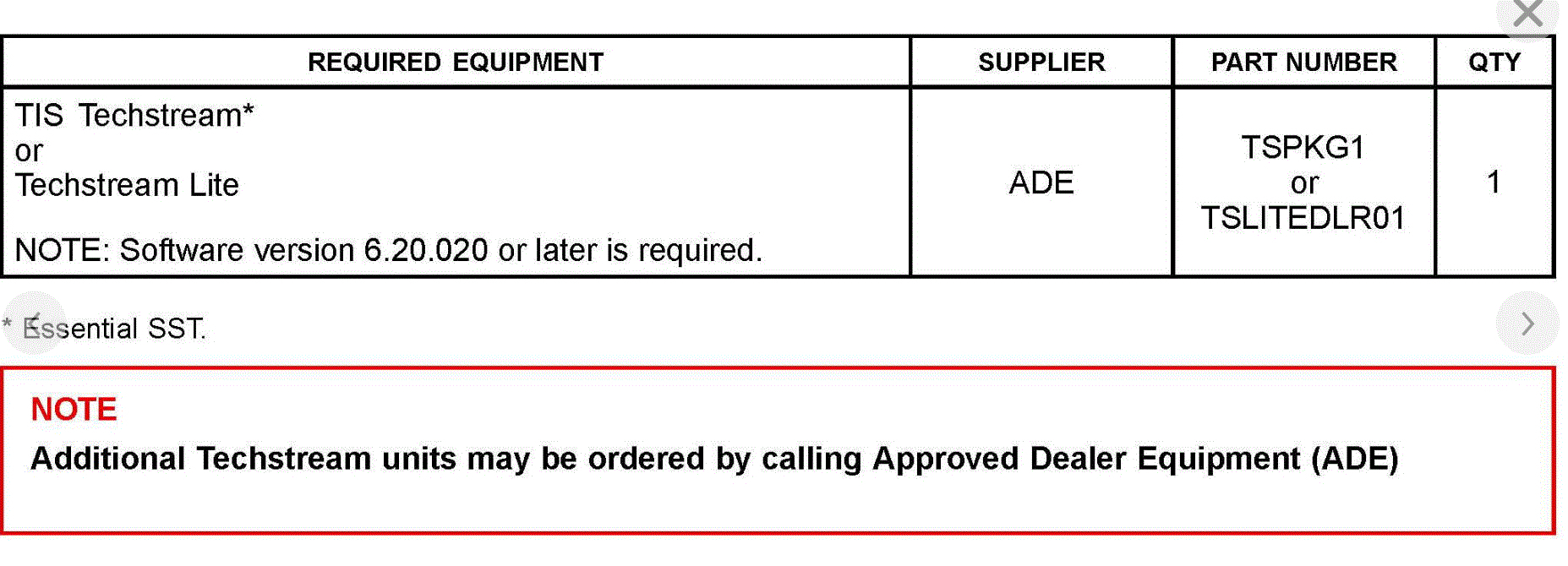

Required Tools & Equipment

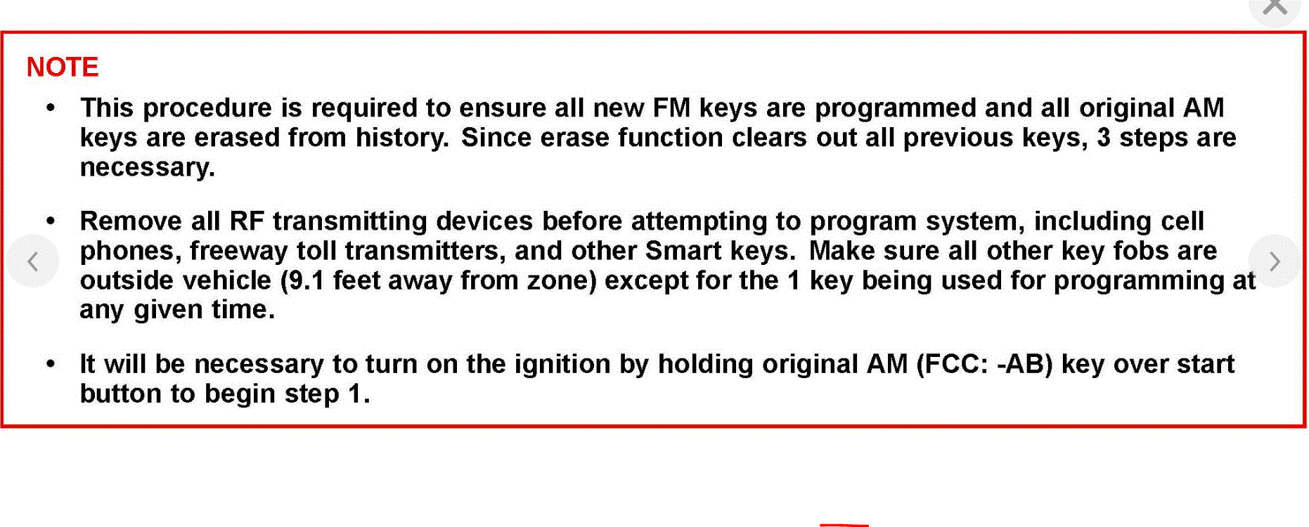

NOTE
Identify FCC ID codes on original and new Smart Key fob plastic cases. Key fobs with FCC ID ending in "B" identifies original AM keys. Do NOT mix original AM keys and new FM keys. Keep them in separate locations.
pic 6

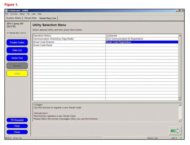

Programming 2 New FM Key Fobs Using "3-Step Procedure":
1.Add - This step programs one new FM key using the original AM key to authorize.
pic 7
pic 8
A. Enter Smart Code Program Registration utility for adding keys.
B. Authorize addition of FM key by first placing original AM key (FCC: -AB) on start button for one beep.
C. Add one new FM key by placing it above start button for first beep and on seat for second beep.
D. Close Smart Code Registration utility to complete step 1.
E. Remove all original AM keys from your work area. They are no longer needed.

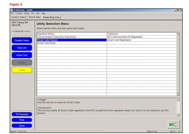

2.Erase - This step erases all original AM key codes but retains the new FM key programming.
pic 9
A. Enter Smart Code Erasure utility.
B. Authorize erasing of AM keys by placing new programmed FM key on start button for one beep.
C. Close Smart Code Erasure utility to complete step 2.
3.Add - This step programs the second new FM key to complete the set of two new keys.
A. Enter Smart Code Registration utility for adding keys.
B. Authorize addition of key by placing first new programmed FM key on start button for one beep.
C. Add second new FM key by placing above start button for first beep and on seat for second beep.
D. Close Smart Code Registration utility to complete step 3.
