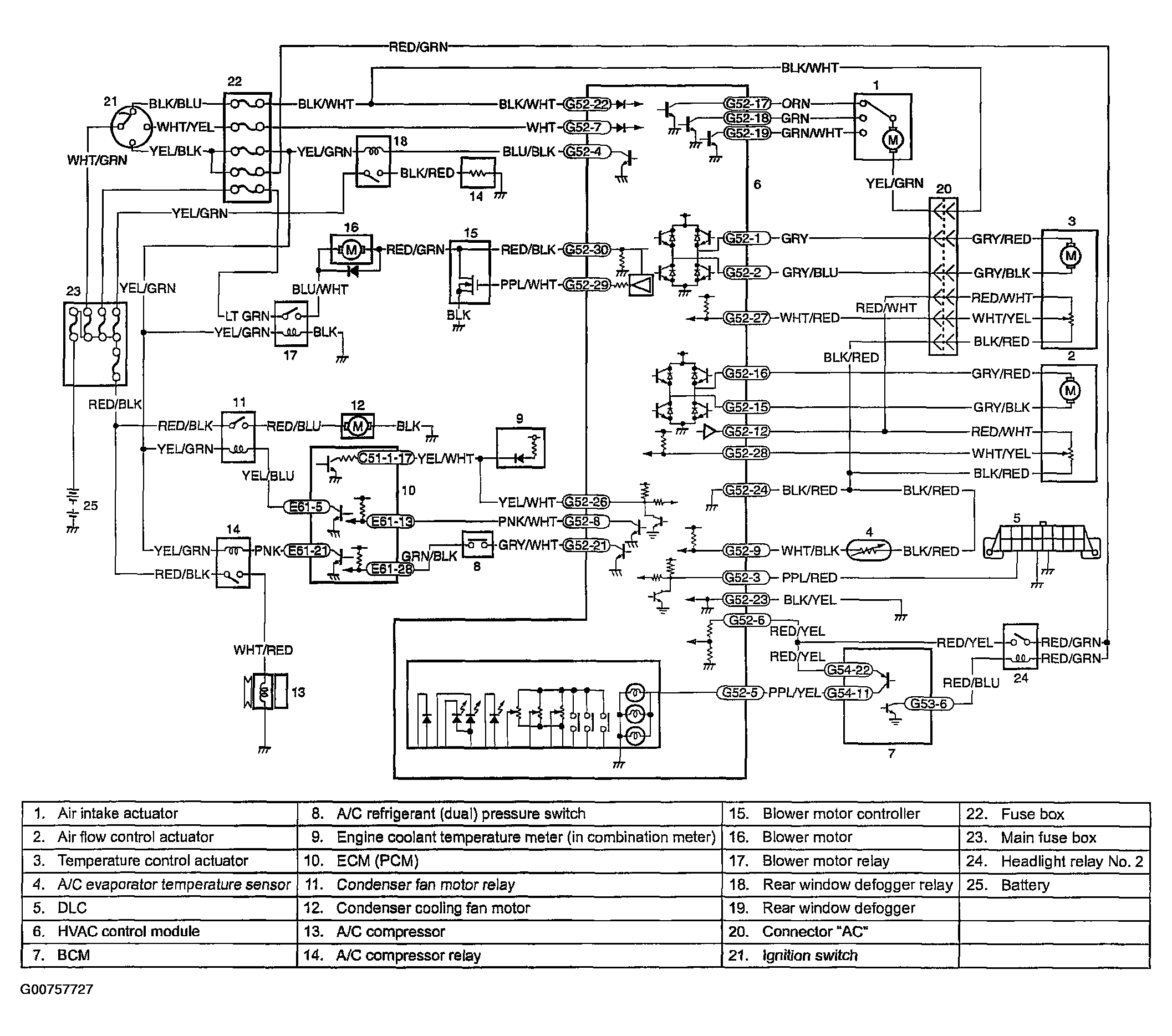

Hi...can anybody please tell me where to locate the blower resistor/fan control module... I think it's defective...if somebody can give me an hint it would be great..It's about -2 C outside and snow....It's he automatic temp. regulator on it, the big knob on the left, the AC light can be turned on/of, checked the fuses under dash, and in engine room. If anybody have an electrical diagrams and/or where located i would be very happy..

this may be the controller for that, however there is a thing called a fan driver behind right headlight and the blower motor relay is behind right kick panel also check front blower fuse and meter fuse under dash fuse box.

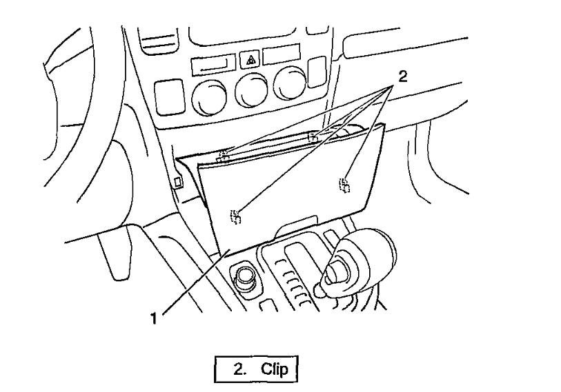

Disconnect negative (-) cable at battery.
Disable air bag system.
For H25 engine model, refer to AIR BAG RESTRAINT SYSTEMS .
For H27 engine model, refer to AIR BAG RESTRAINT SYSTEMS .

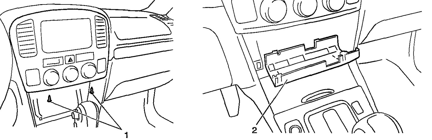

Remove center lower box (1).
Fig. 23: Removing Center Lower Box

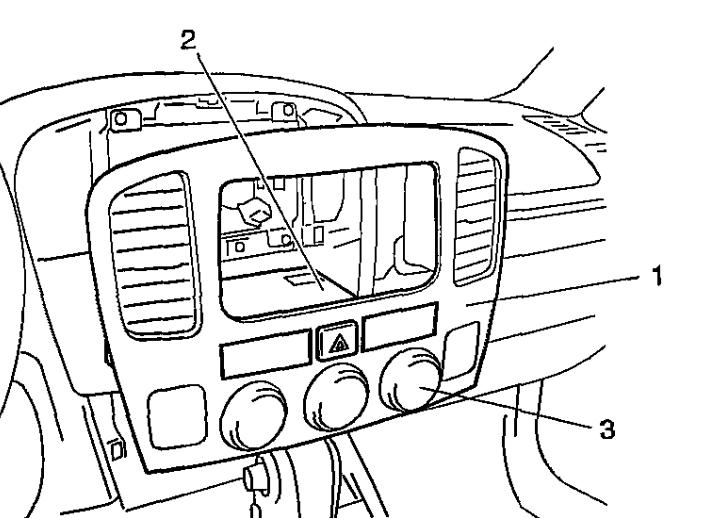

Remove center garnish mounting screw (1) and then pull off center garnish.
Remove harness and controller cover (2).
Fig. 24: Removing Harness & Controller Cover
Courtesy of SUZUKI OF AMERICA CORP.

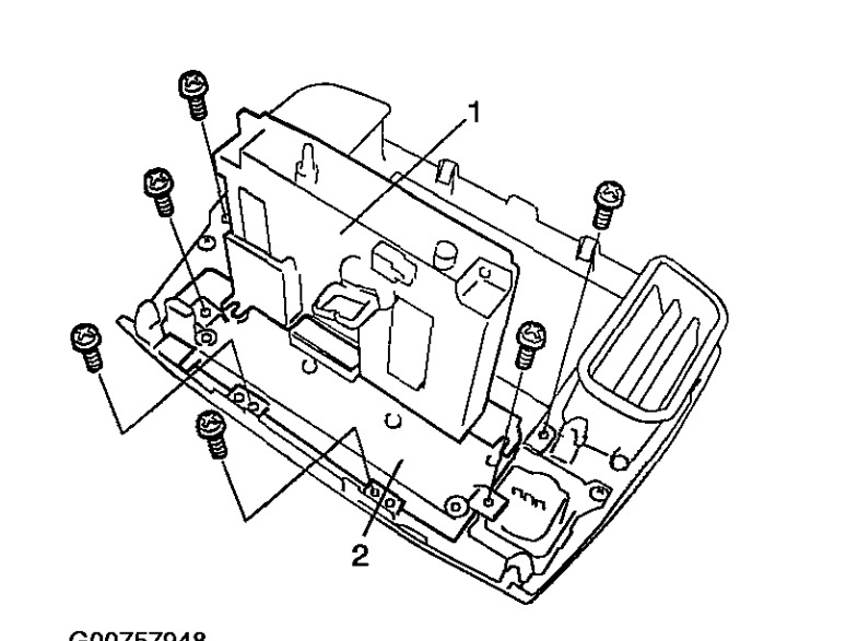

Disconnect BCM connectors and HVAC control module connector from each controller.
Remove center garnish (1) with BCM (2) and HVAC control module (3).
Fig. 25: Removing Center Garnish
Remove body control module (1), and then HVAC control module (2) as shown

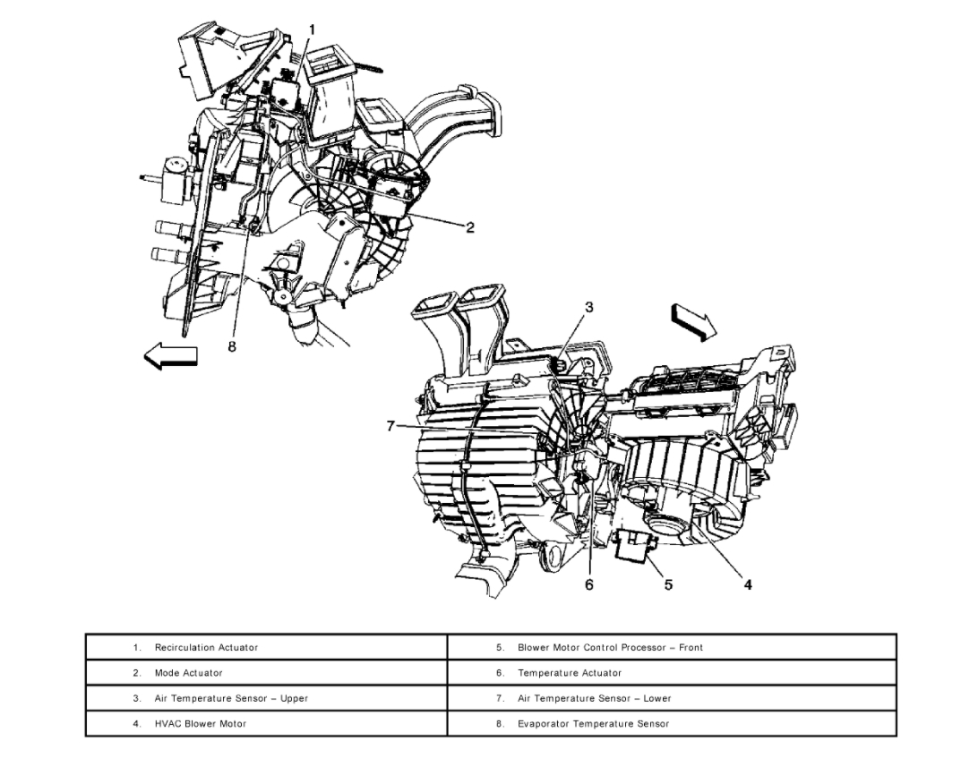

where would we find the blower motor and the blower resistor/fan control module?
Jan 11, 2021 at 8:08 AM (Merged)
  • 75,992 POSTS
This guide can help you fix it with the location of the blower motor and resistor in the diagrams below.
