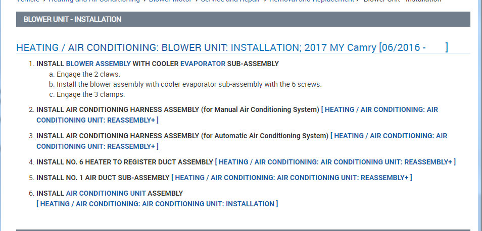

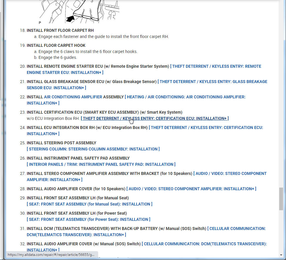

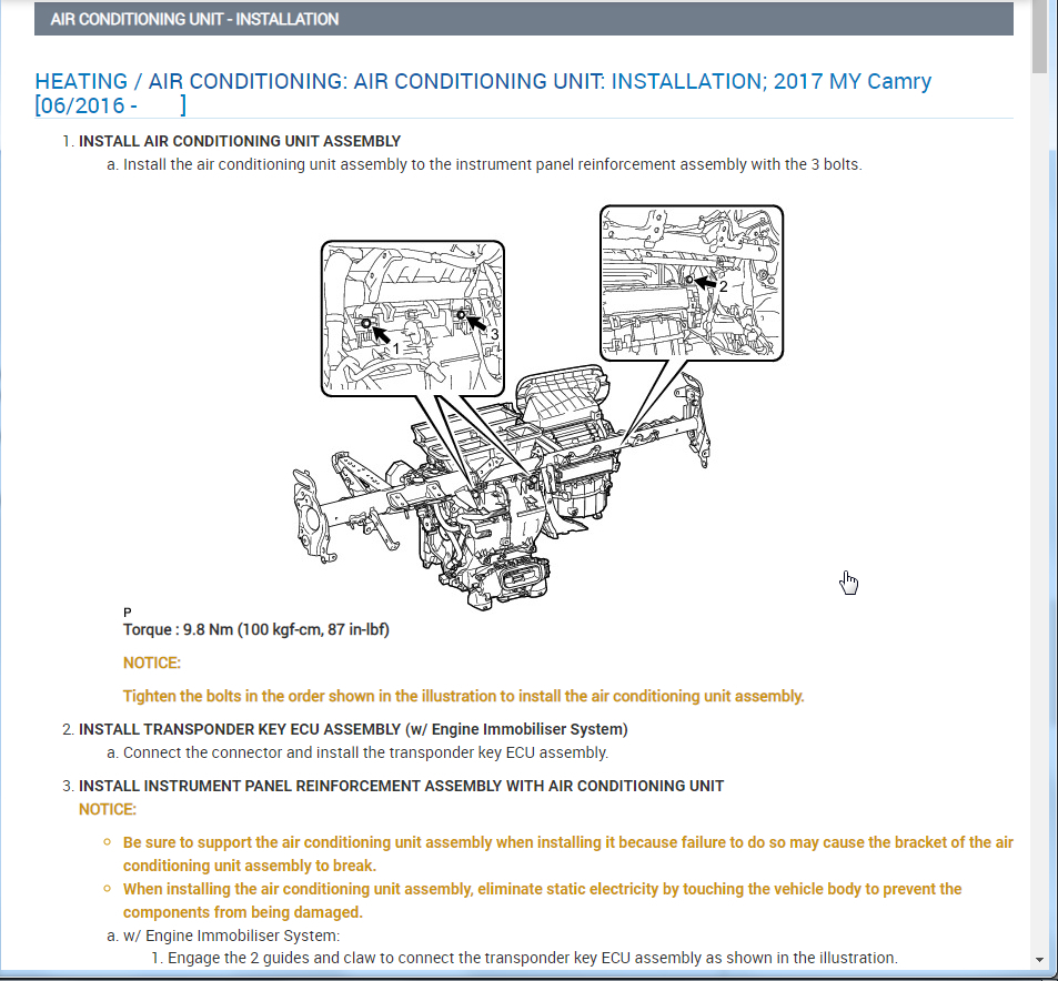

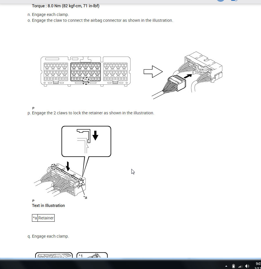

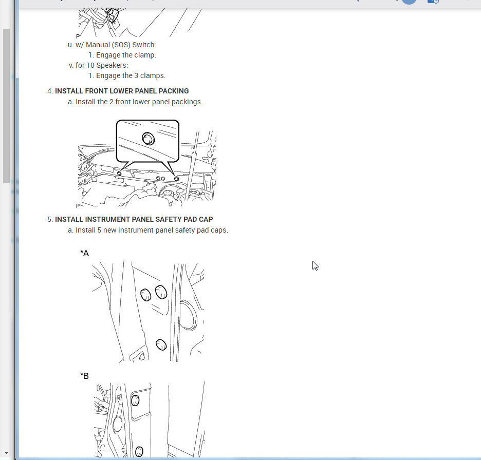

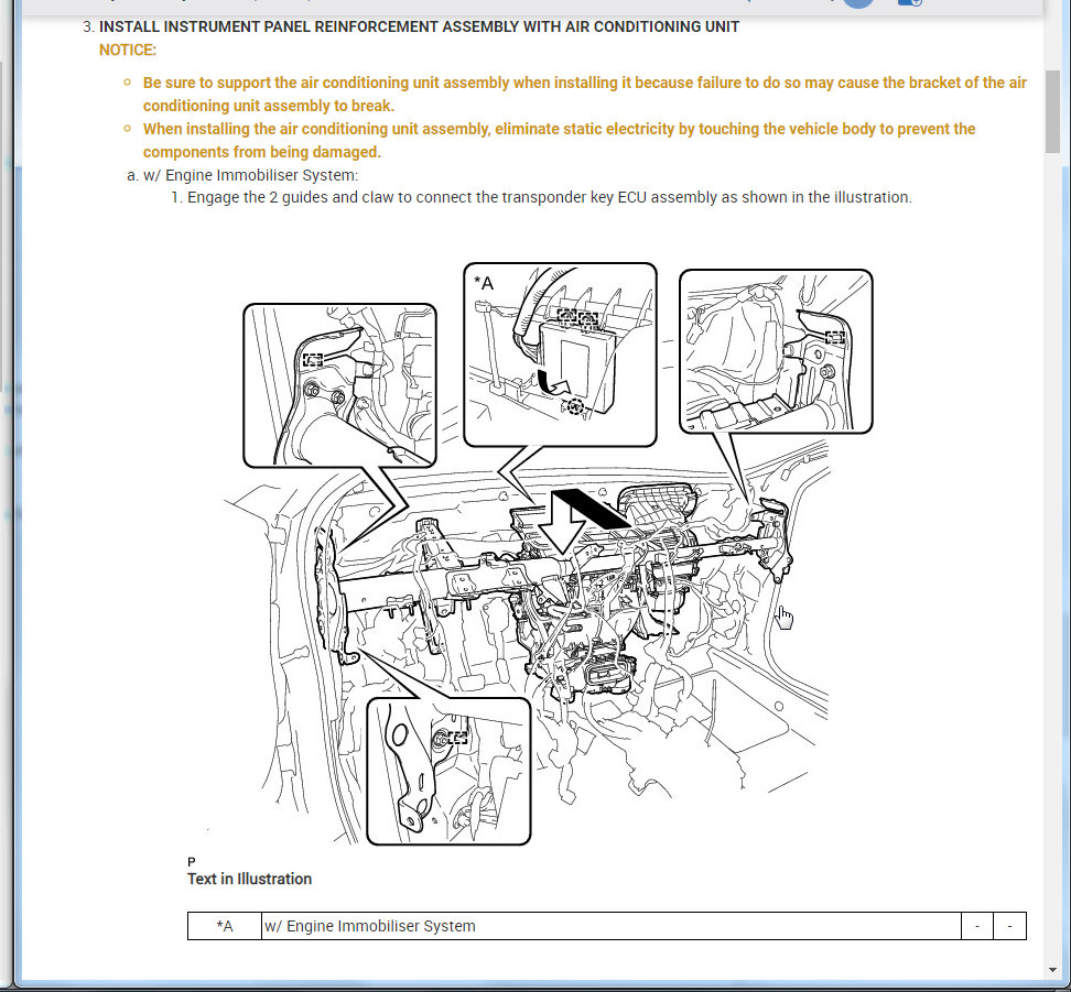

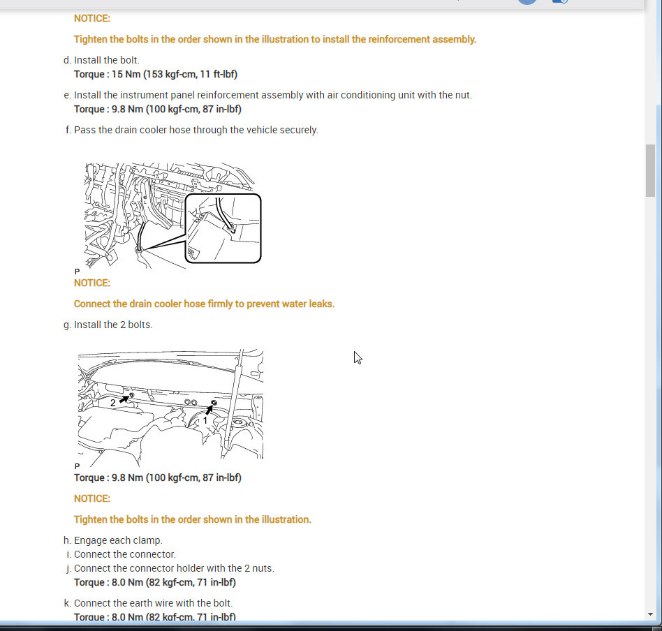

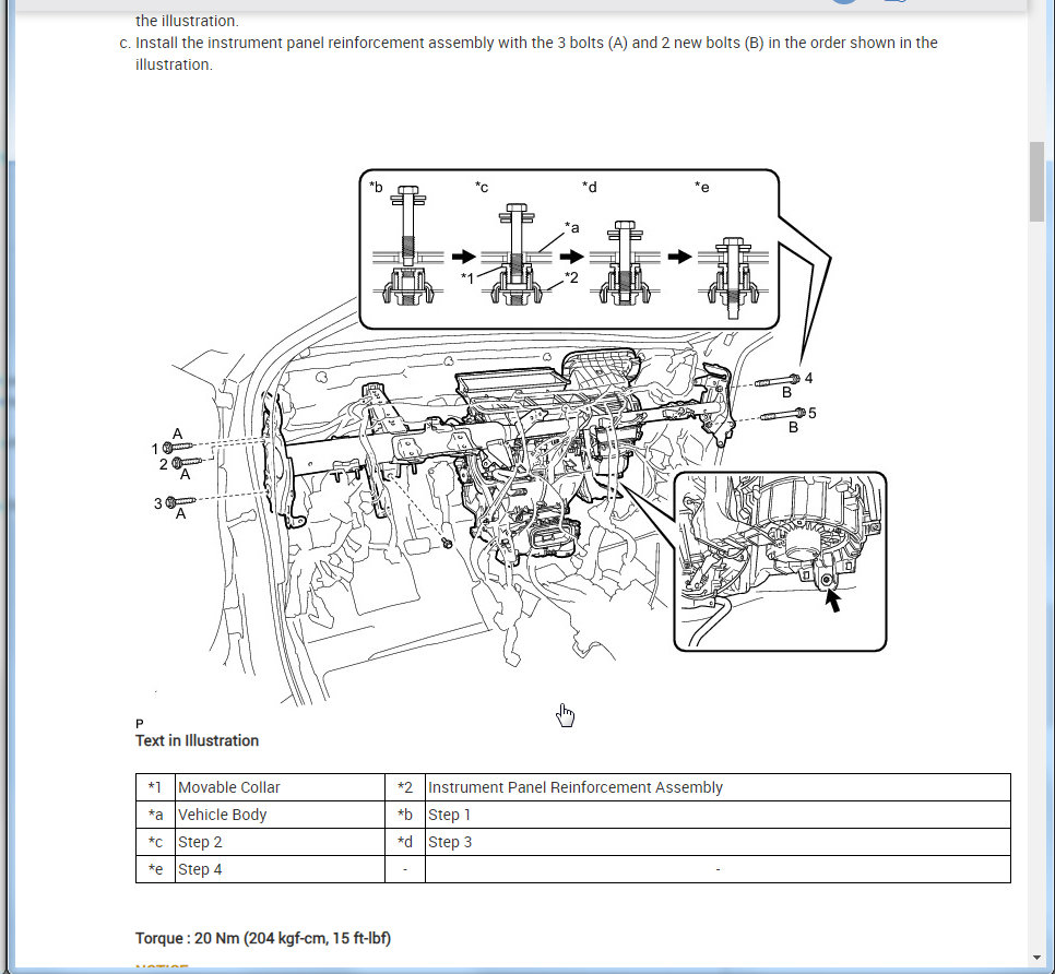

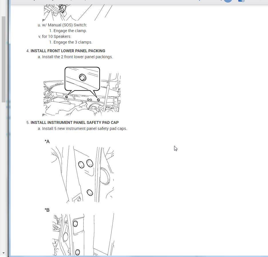

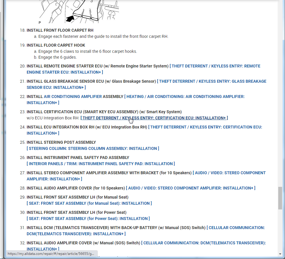

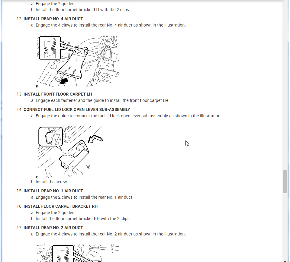

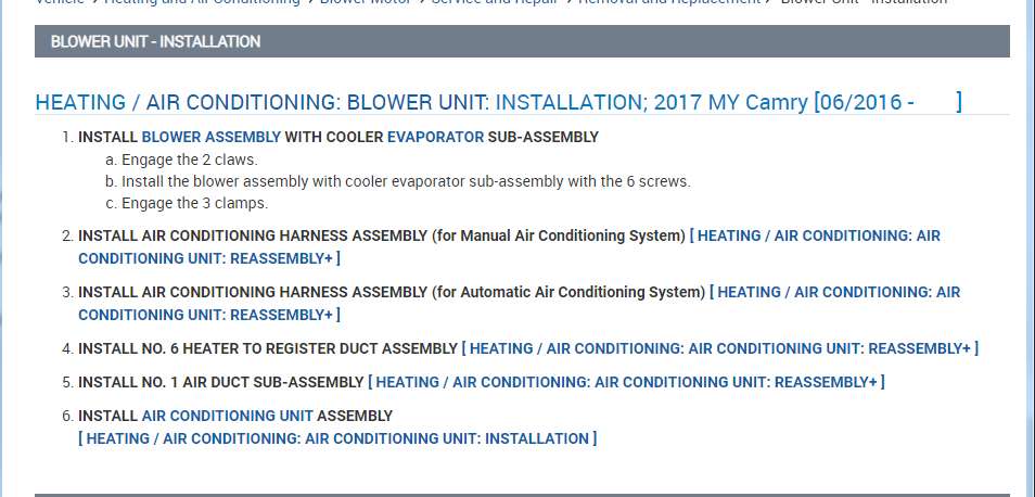

I am installing the blower motor can you help please?
Monday, January 22nd, 2018 AT 4:00 PM
2 Replies
MECHANIC
18,907 POSTS

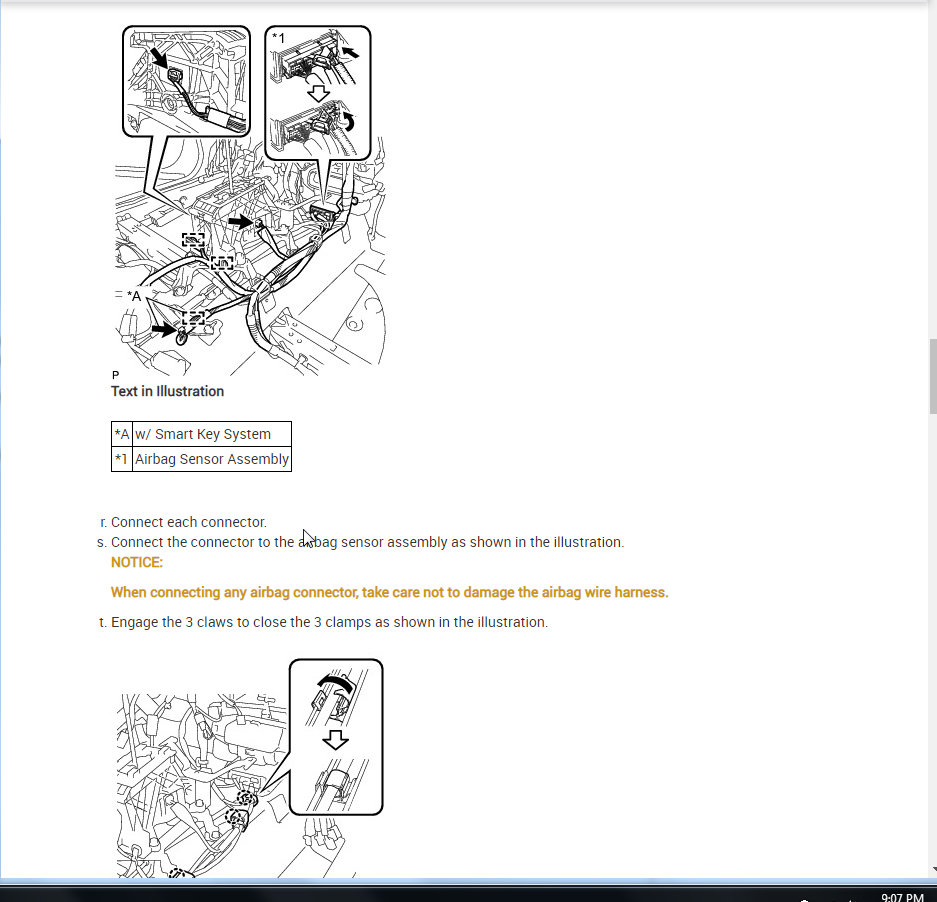

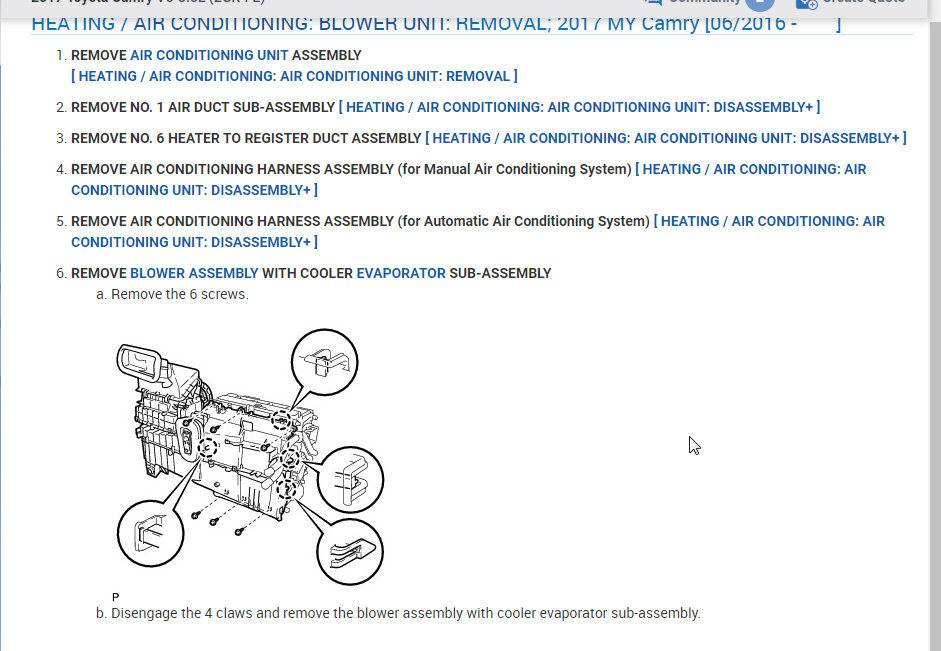

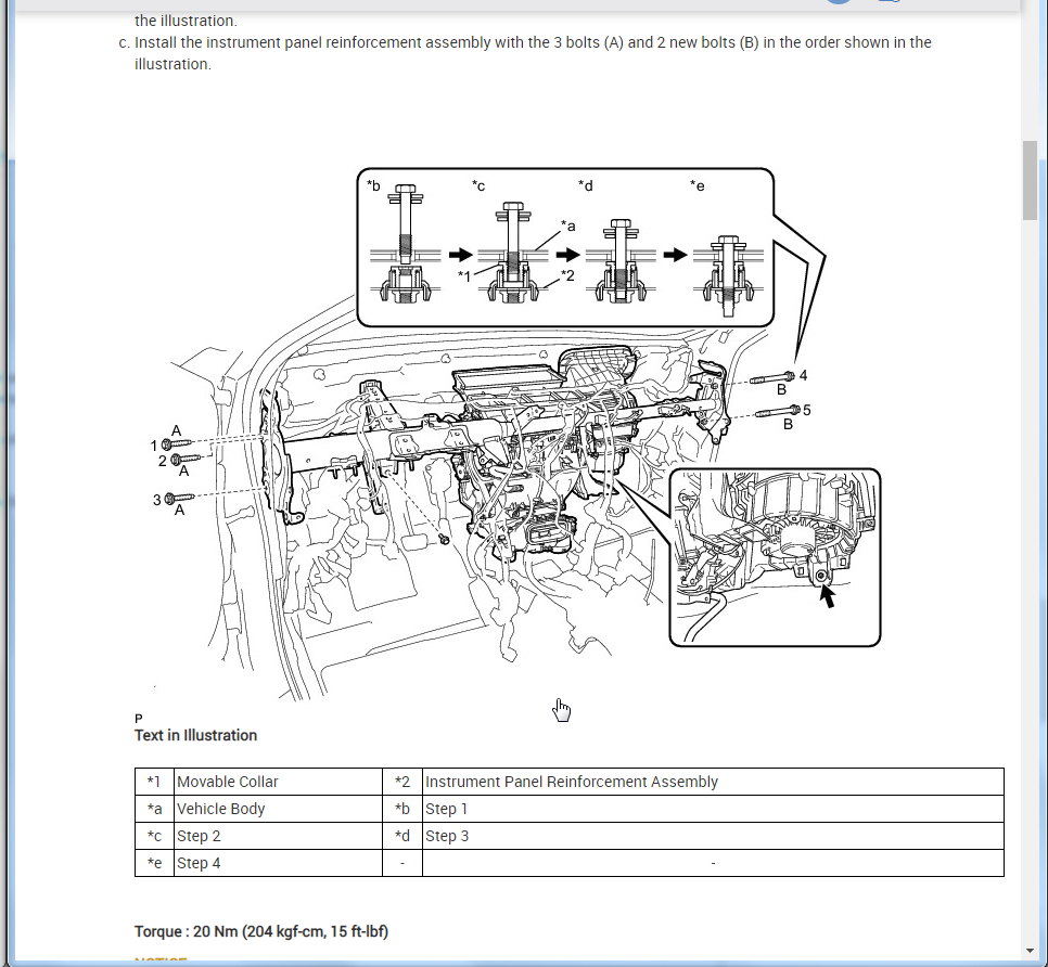

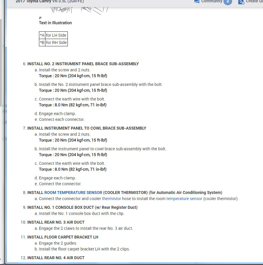

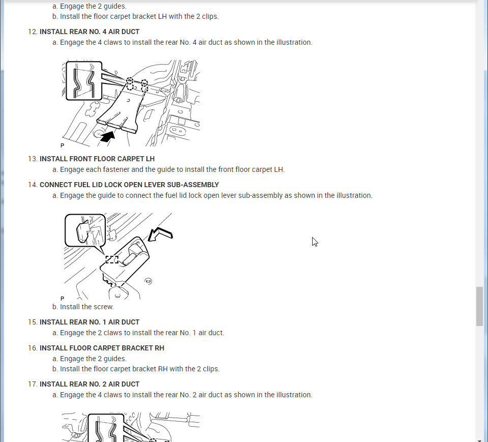

Here is a video that will help with this as well as a guide:
https://youtu.be/1eau7hCuuJ8
https://www.2carpros.com/articles/blower-fan-motor-works-on-high-speed-only
Below you will find the specific instructions on how to do this for your vehicle as it appears you need to remove the dash to do this.
Please let us know if you have questions. Thanks
