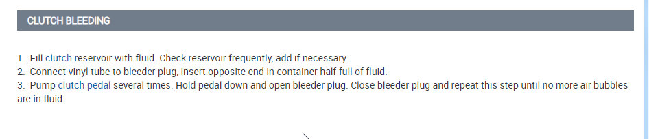

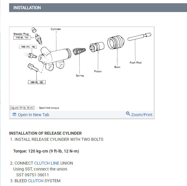

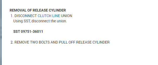

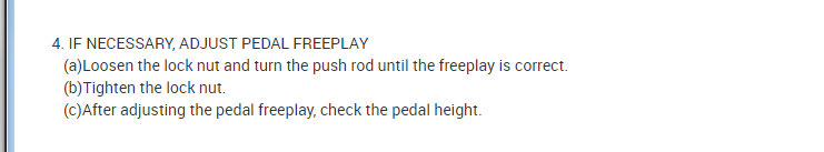

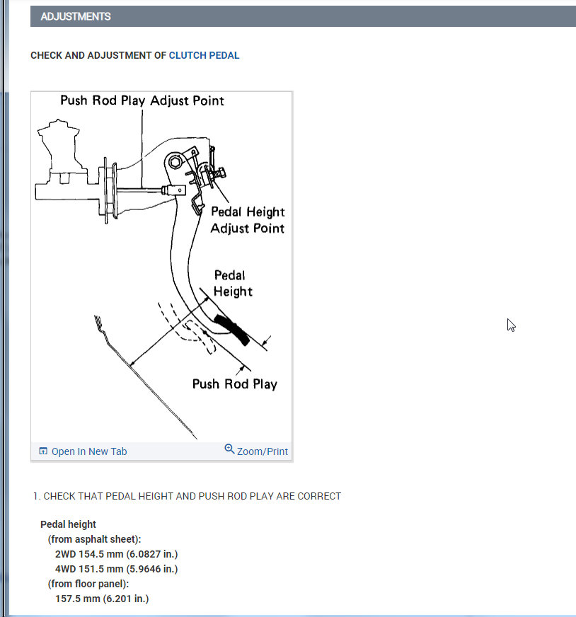

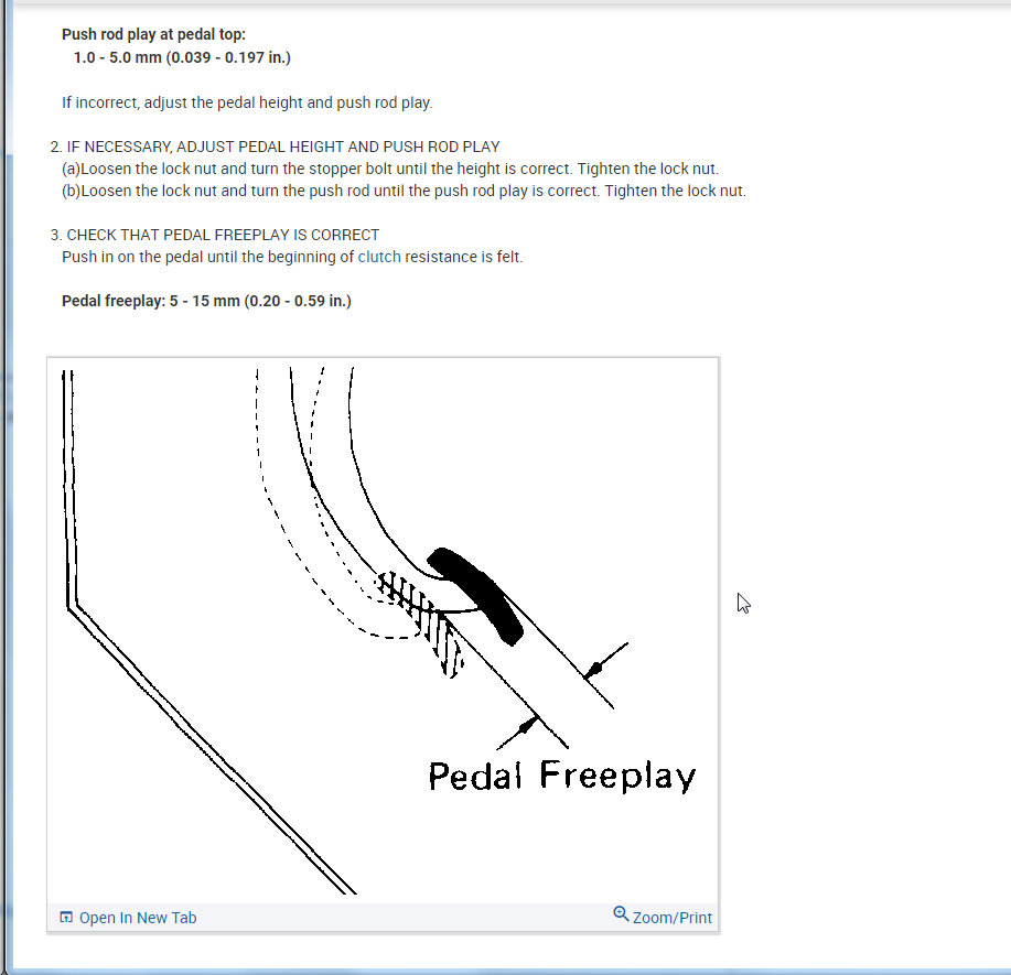

I need to install a clutch and how to adjust the clutch. Truck listed above is four wheel drive.
Apr 10, 2021 at 4:07 PM
Here are a lot of guides that we have put together to help with this. Mostly because most of the manuals are not very helpful. They say things like "remove transmission" because they were written for trained mechanics and not the general public or even less trained mechanics.
https://www.2carpros.com/articles/clutch-doesnt-work-sometimes-or-not-at-all
https://www.2carpros.com/articles/transmission-replacement-removal-manual
https://www.2carpros.com/articles/throw-out-bearing-replacement
https://www.2carpros.com/articles/pilot-bearing-replacement
I attached the process below from the manual so that you have that as well but again, it is not very detailed. Thanks
