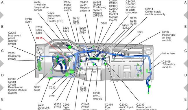

This came from a ford upfitter site. The blue part is the upfitter wiring harness. I don't know if it will help? More to come.
Sunday, October 6th, 2013 AT 9:50 AM

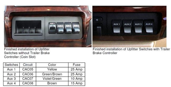

Upfitter switch pictures.
Sunday, October 6th, 2013 AT 9:55 AM

Route the wiring harness as shown and plug the middle connector on the upfitter harness into the 14401 harness at connector c215.
Attach the ground ring terminal to the IP frame fastener hole.

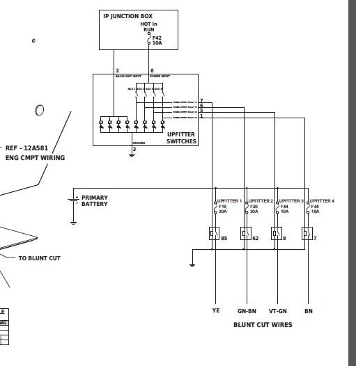

Here is an example of upfitter switch wiring. It's just an example.
Sunday, October 6th, 2013 AT 10:49 AM
