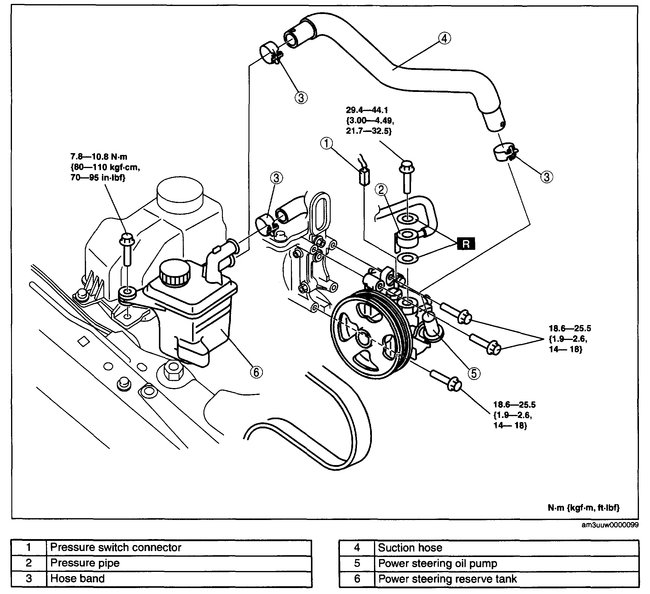

How do you install a power steering pump in the car listed above? It seems easy to do. I rather try myself then pay $741.00.

First, here is a link that shows in general how one is replaced:
https://www.2carpros.com/articles/how-to-replace-a-power-steering-pump
Here are the directions specific to your vehicle. You will need to refer to the attached picture for procedure.
_______________________________________________
POWER STEERING OIL PUMP REMOVAL/INSTALLATION [L3 WITH TC]
1. Remove the drive belt.
2. Remove in the order indicated in the table.
3. Install in the reverse order of removal.
Let me know if this helps.
