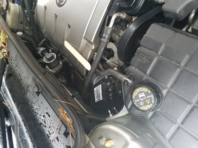

There is a leak in the power steering hose that goes from the pump over the back side of the engine. When attempting to purchase a replacement, the question is whether it is a pressure hose or return hose.

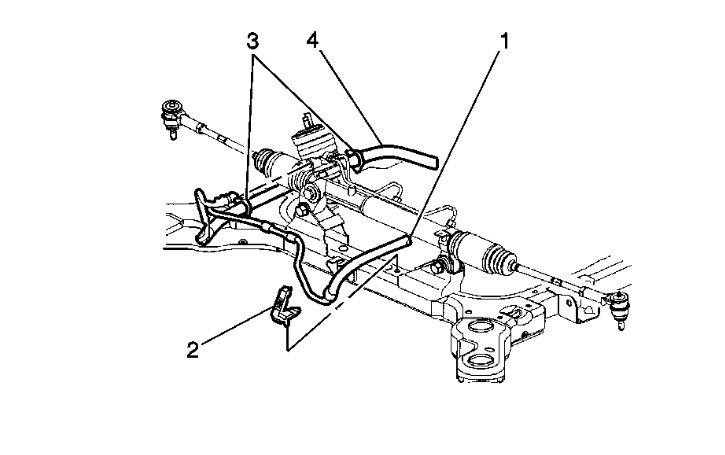

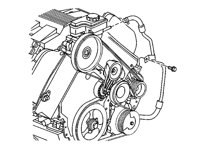

The pressure line picture is attached with the procedure as well as the return line.

Return line
Power Steering Return Hose Replacement
Removal Procedure
1. Install a drain pan under the vehicle.
2. Disconnect the power steering return hose from the power steering pump.
3. Remove the power steering return hose mounting bracket retaining bolt from the cylinder head.
4. Raise and support the vehicle. Refer to Lifting and Jacking the Vehicle (See: Vehicle Lifting > Procedures > Lifting and Jacking the Vehicle).
5. Remove the front air deflector. Refer to Front Air Deflector Replacement (See: Air Dam > Removal and Replacement > Front Air Deflector Replacement).
6. Remove the power steering gear heat shield. Refer to Steering Gear Heat Shield Replacement (See: Steering Gear > Removal and Replacement > Steering Gear Replacement).
7. Remove the power steering return hose from wiring harness tie strap.
8. Remove the power steering return hose from the frame brackets.
9. Remove the power steering return hose from the power steering gear.
10. Remove the power steering return hose from the vehicle.

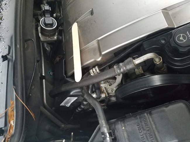

Your diagram is a little different than my car, I believe. I attached a photo.
Nov 27, 2019 at 12:40 PM
It is the same. The hose that shows here is the pressure hose.
Is that the one that is leaking?

Yes. That one goes towards the firewall.The leak is on the underside where the wood is. Are there fasteners behind there and does the hose continue straight down over the valve cover?

Yes, there are 2 more fasteners between there and the steering rack. The second diagram I sent shows the route of the hose.

What is the orientation of the diagram? Which is front, left or right?
Nov 27, 2019 at 1:29 PM
Number 4 is the left front of the cradle under the car. The picture is the cradle that the engine and transmission is mounted.
