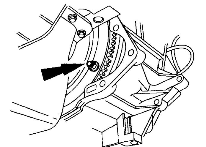

how to get torque converter bolts out

turn torque converter to where it is shown in pic hold either crankshaft or try a impact wrench for removal.
