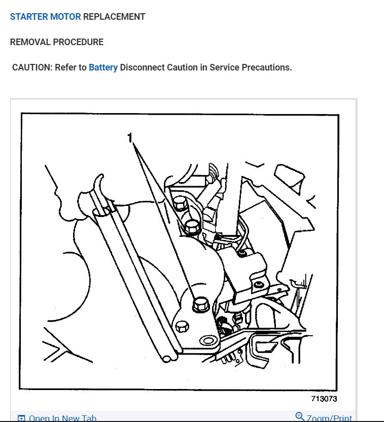

Need a diagram or something showing the proper way to remove a starter from the vehicle listed above. I have been walking to work for the past week and a half, please help me fix this. I know where the starter is just not how to go about it and what to do first. It was very rusty underneath, so I might have to take it somewhere just for that to use air tools. Thank you in advance.

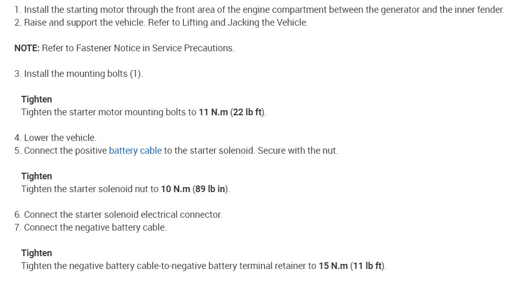

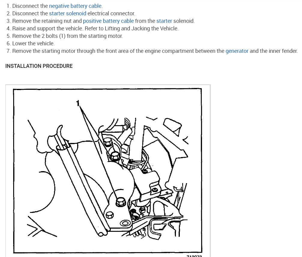

You will need to do the job from under the car so you will need to jack up the car. Here is a guide to help:
Here is a generic guide to help with the job with specific instructions for your car in the diagrams below:

I'm sorry but this doesn't really help. I don't know what angle in the diagram I'm looking from. I need step by step with photos or video to fully see how to and where to finagle the starter out from if I even can get past the rusted bolts. Thank you and I mean no disrespect I just don't understand.

These are all the diagrams we have for this car; can you upload pictures or a video so I can walk you through it? Also let's load test the battery by following this guide:
You may have a bad ground cable to the engine block or positive battery cable. Let me know
