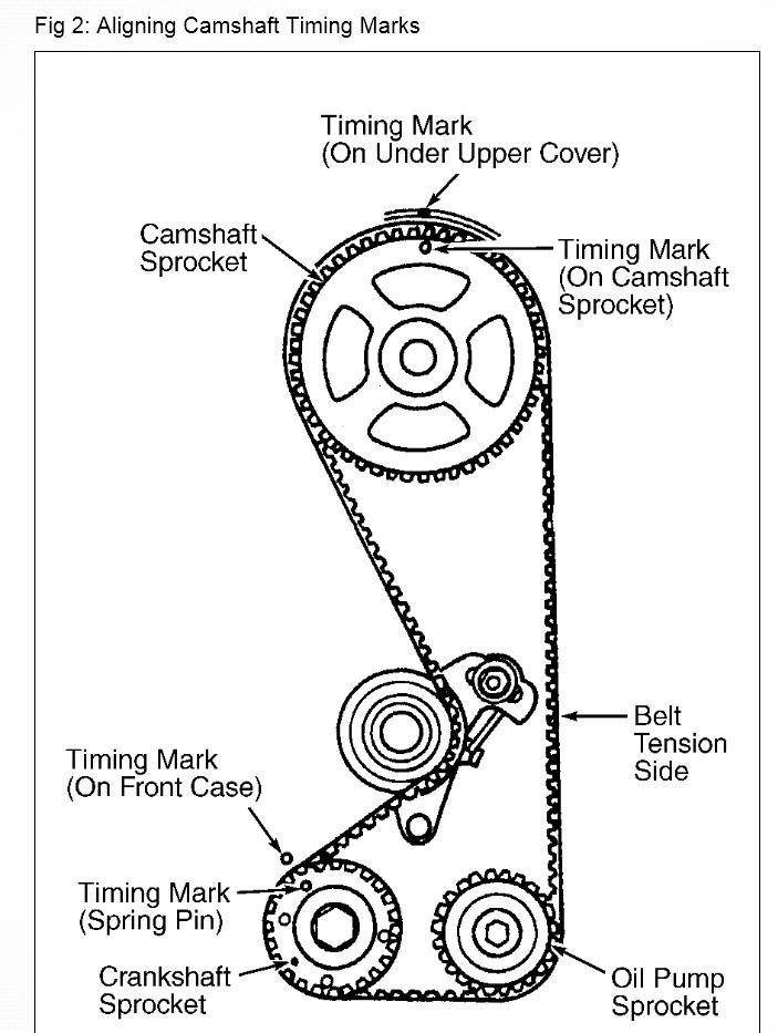

Just changing timing belt, tensioer, and pulley. I know it is an interference engine and where the marks are just cannot the new belt on. is there a certain order or way? I am going crazy! Tania
Apr 22, 2017 at 9:29 AM
KHLOW2008
  • 41,814 POSTS
Did you remove the auto tensioner? The diagram shows the marks. Auto tensioner has to be retracted and a pin inserted prior to installation, after which the pin is removed.

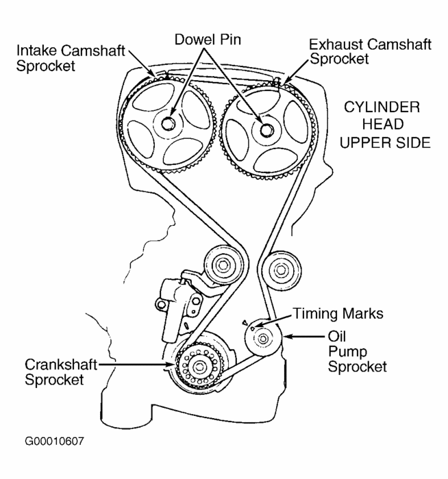

Sorry, the diagram is wrong. I will repost a new one as editing this post does not allow me to replace the diagram.
Apr 23, 2017 at 7:21 PM
KHLOW2008
  • 41,814 POSTS
Here is the correct diagram
Apr 23, 2017 at 7:24 PM
TANIA PASTRANA
Thank you for your reply it helped. I've gotten all of that back together but I had one other question. Another person at. It was the fuel pump and not the crankshaft sensor that it cause the car to cut off and replace the fuel pump apparently but I don't know exactly what they did because I'm not getting it like when you go to put the key and prime it it doesn't prime for some reason and I'm trying to figure out why it wouldn't Prime and also when I put the Power Probe on it doesn't seem to be getting enough power if you could help that would be great

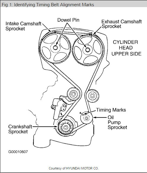

Need to set timing marks for the timing belt To go
the timing is off need to reset the timing
my tdc is wrong how do I get it back to tdc
Oct 27, 2020 at 9:10 AM (Merged)
  • 110,240 POSTS
There is a mark on the crank pulley and a mark on the engine block that is for TDC. Take a look at the pic on this page and let me know if it helps. NOTE: I don't know if you have a 4 or 6 cylinder but both are there.
https://www.2carpros.com/diagrams/hyundai/sonata/2001

MHPAUTOS
  • 31,937 POSTS
see pic, note that the timing marks for the cams are at the top it is a bit hard to see in the pic.
