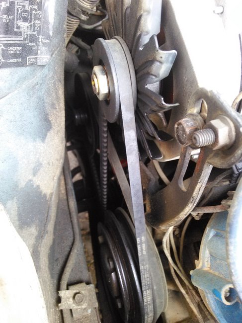

I just baught an oldsmobile cutlass and it needs a water pump but i dont see how to get the belts off. Pleas help im not to familiar with older cars

Yo need to be a little more specific as to which model Cutlass and which engine you have.

Its a 1985 oldsmobile cutlass ciera brougham 6 cylinder

There are 3 different 6 cylinder engines available for that car so you need to be more specific.
3.0, 3.8, or 4.3. Don't guess.

3. 0

The pulley in the upper left of this picture is a spring loaded tensioner. Rotate it clockwise to release belt.

The picture didnt come. Is it theone the one rhats connected to the power steering

Thats not the engine i have

This one

In that case there is something wrong with the information you are giving me because that is the setup for the engine that you told me you had.
