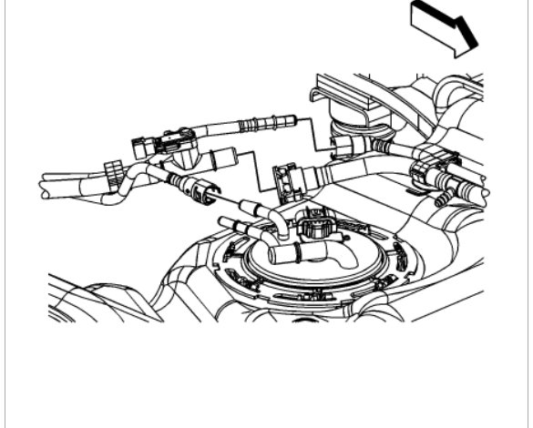

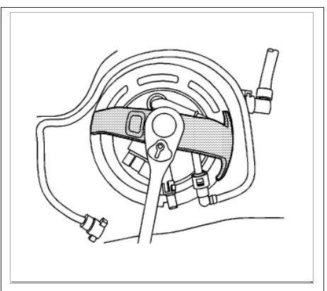

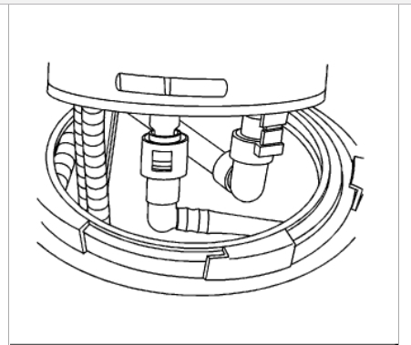

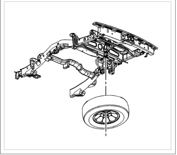

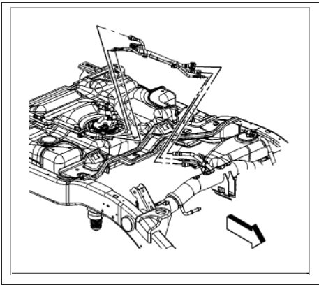

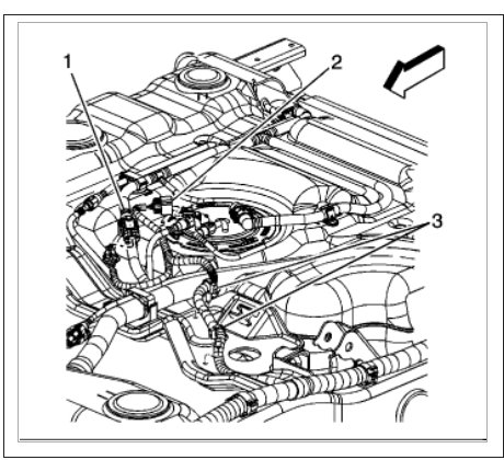

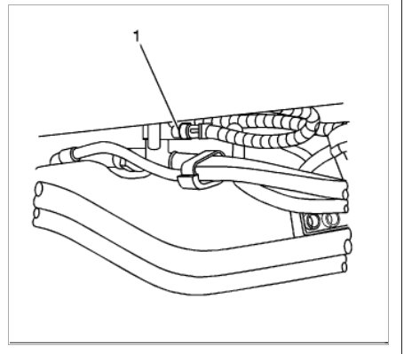

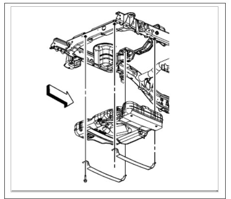

Someone put used cooking grease in my gas tank what can I do?
Oct 18, 2018 at 11:19 AM
  • 54,840 POSTS

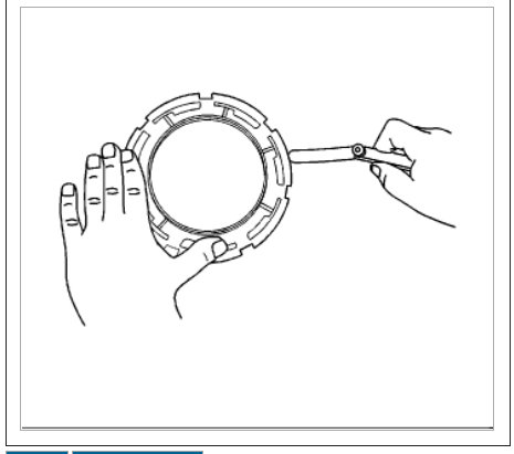

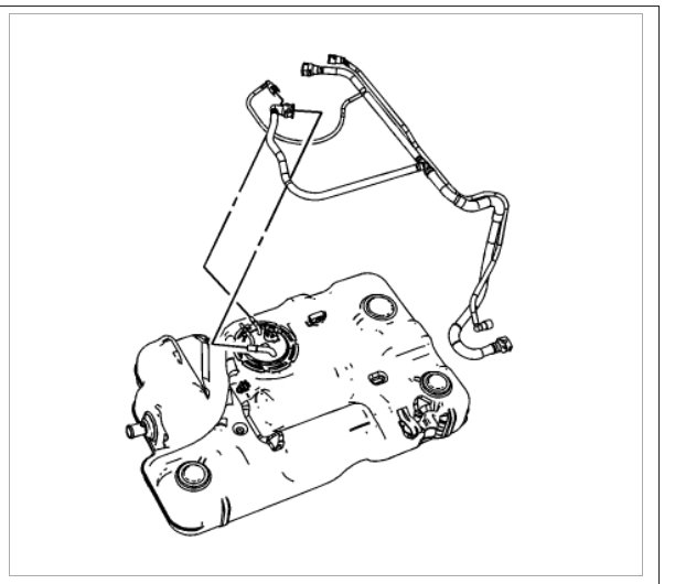

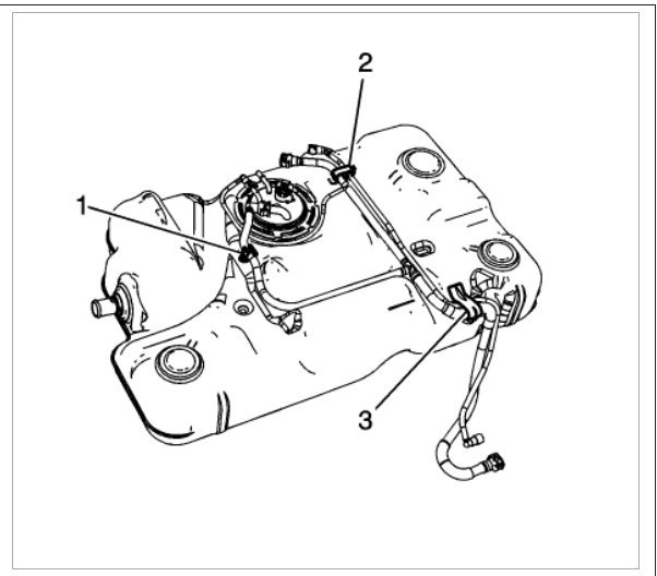

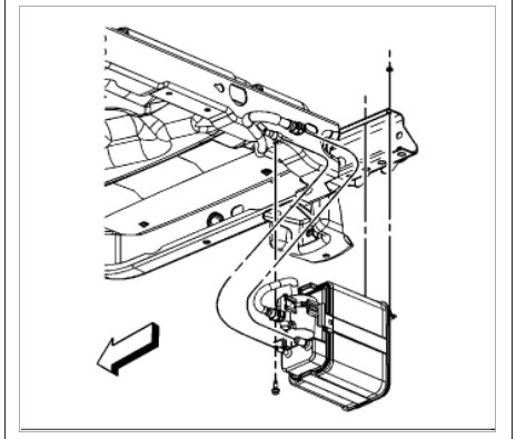

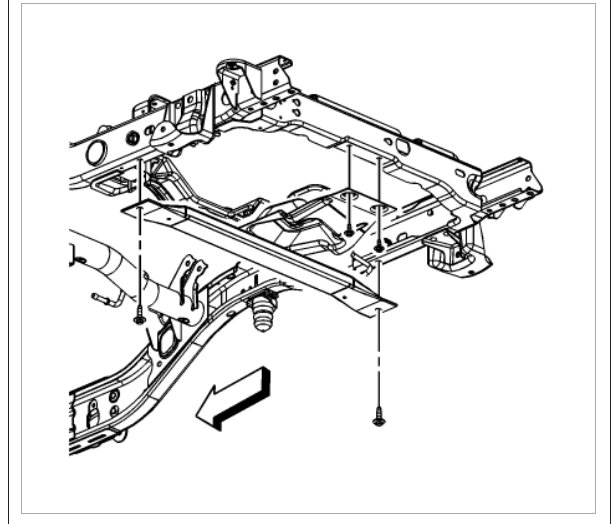

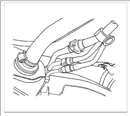

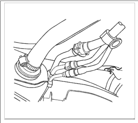

Not to nice for sure, you will need to remove the gas tank and have it cleaned or I would just replace it with a used unit. This is because the fuel pump is ruined as well. Here is a guide to show you what you are in for when doing the job step by step and diagrams below to show you how to remove the gas tank:
https://www.2carpros.com/articles/how-to-replace-an-electric-fuel-pump
