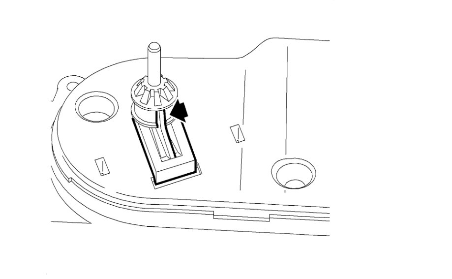

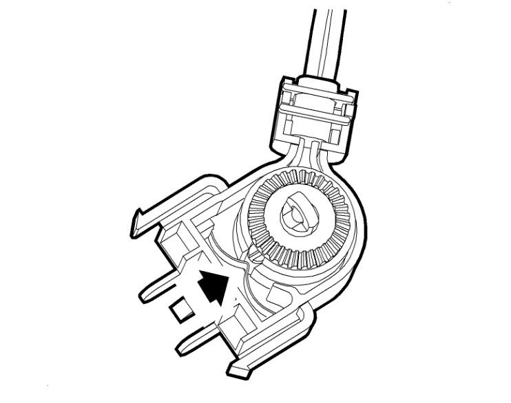

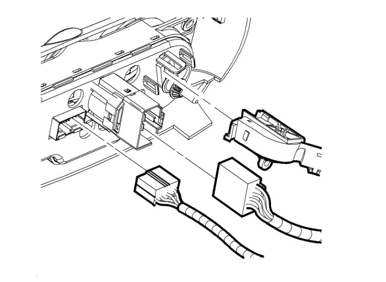

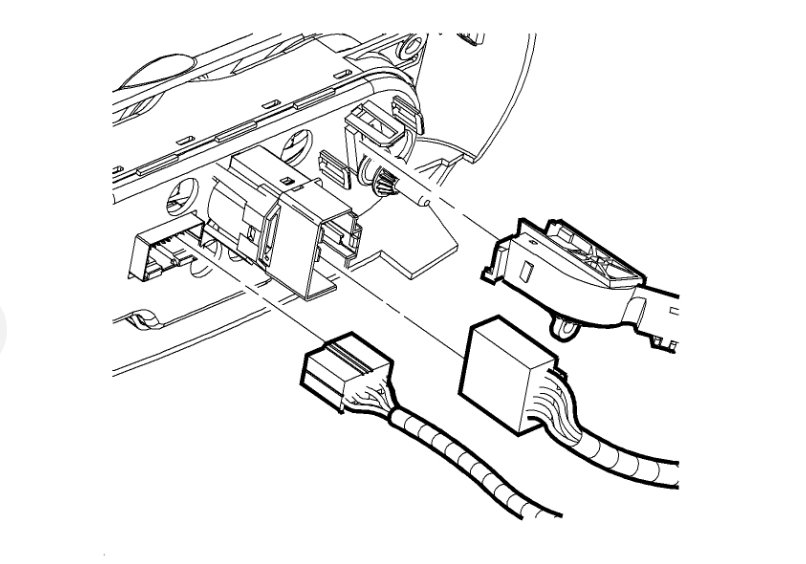

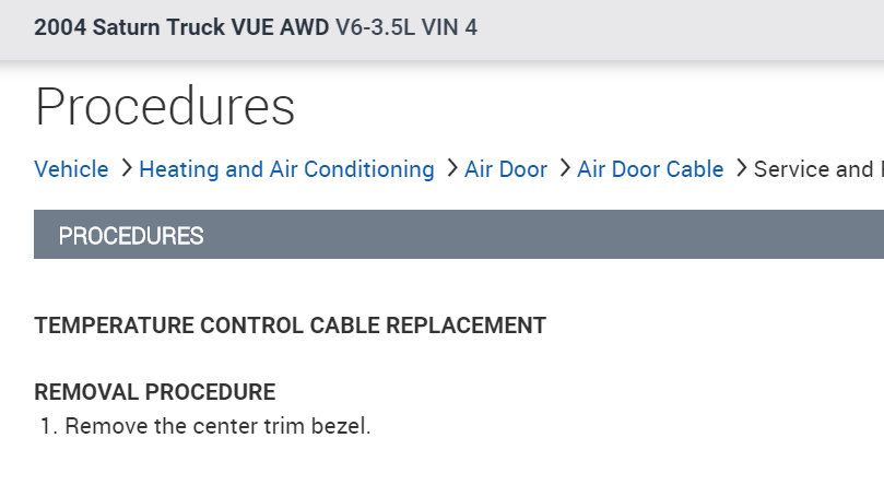

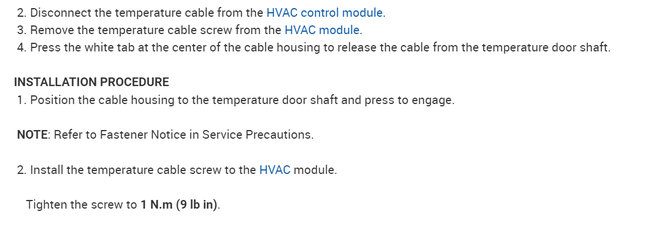

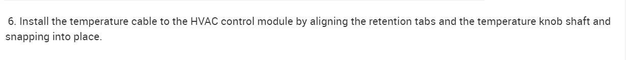

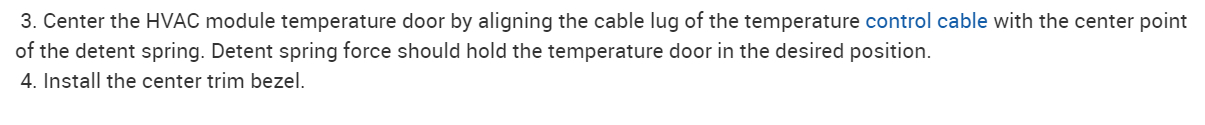

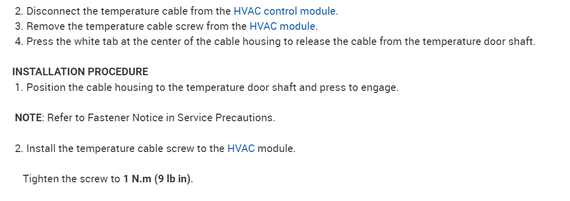

The cable or blend door is binding and broke the hot/cold knob shaft. how can check the door or replace the cable assembly?
Jul 19, 2019 at 2:45 AM
SCGRANTURISMO
  • 4,897 POSTS
In the diagrams down below I have included the factory step by step guide for the removal and installation of the temperature control cable for your vehicle. Please go through this guide and get back to us with how everything turns out.
