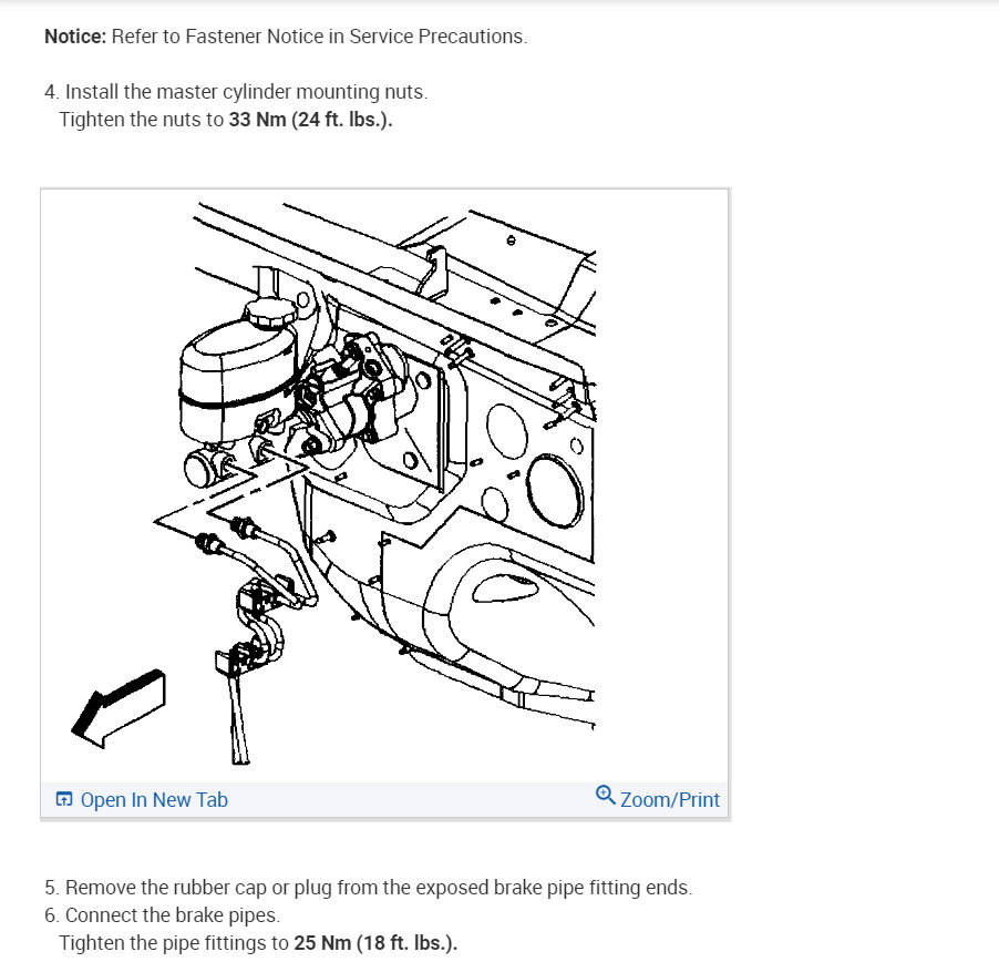

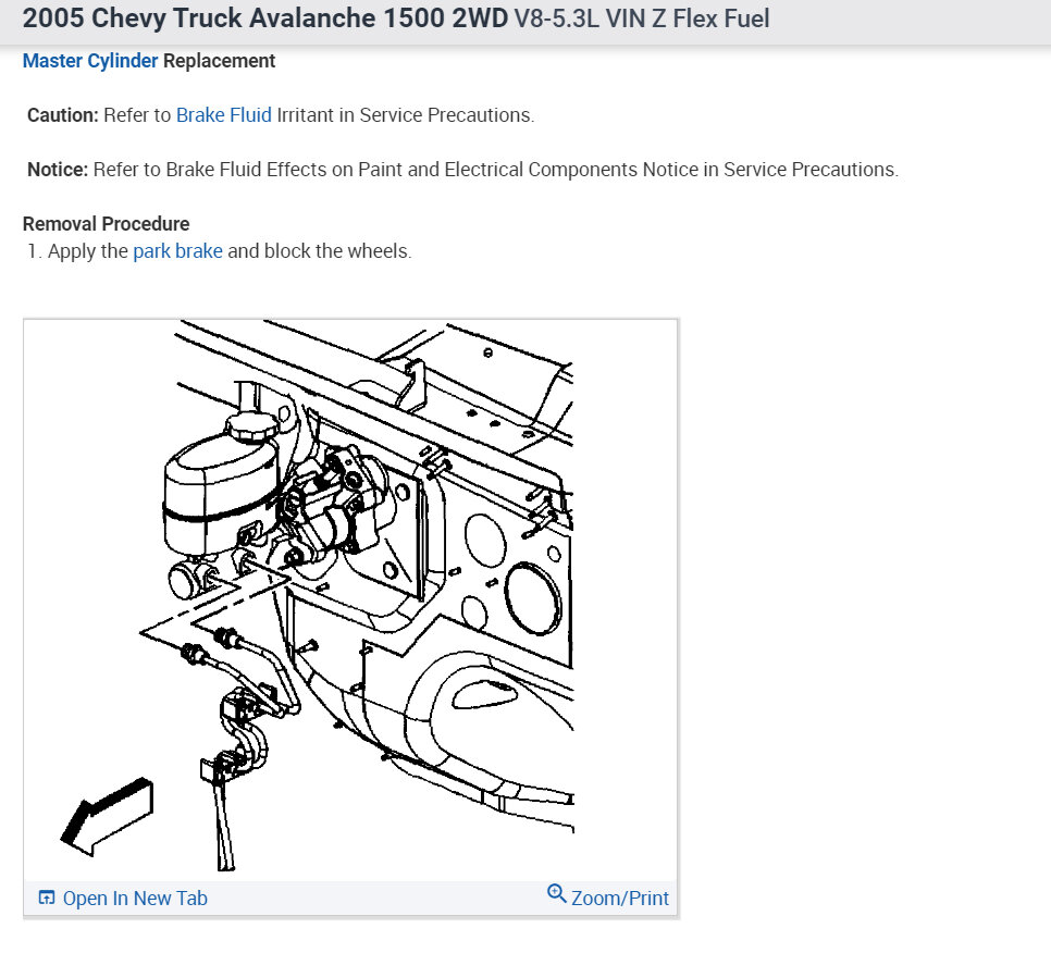

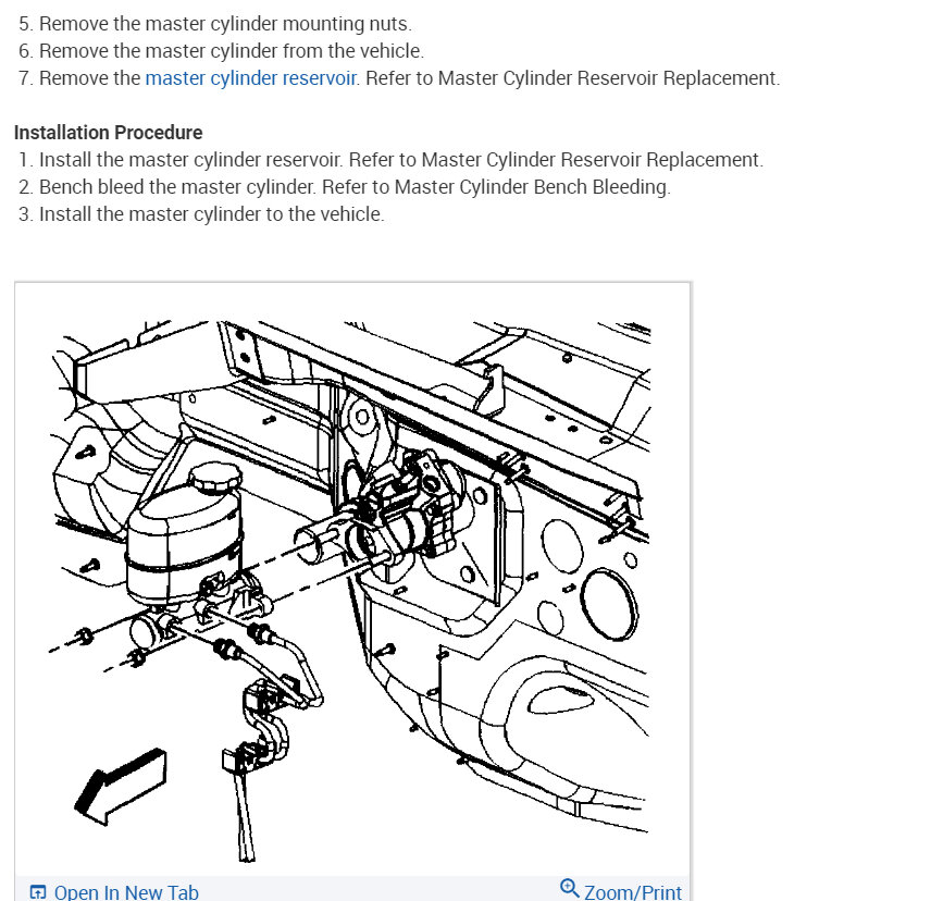

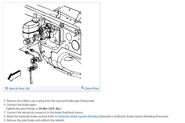

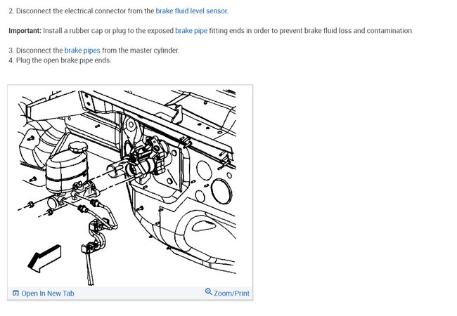

I would loosen the brake master mounting bolts three turns to see if the wheel start to turn again. (Do Not Drive)
https://www.2carpros.com/articles/how-to-replace-a-brake-master-cylinder
Here is how to change out the brake master in the images below. Check out the images (below). Please let us know what happens. I have also seen the hydro boost push rod need to be adjusted inward.
