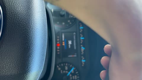

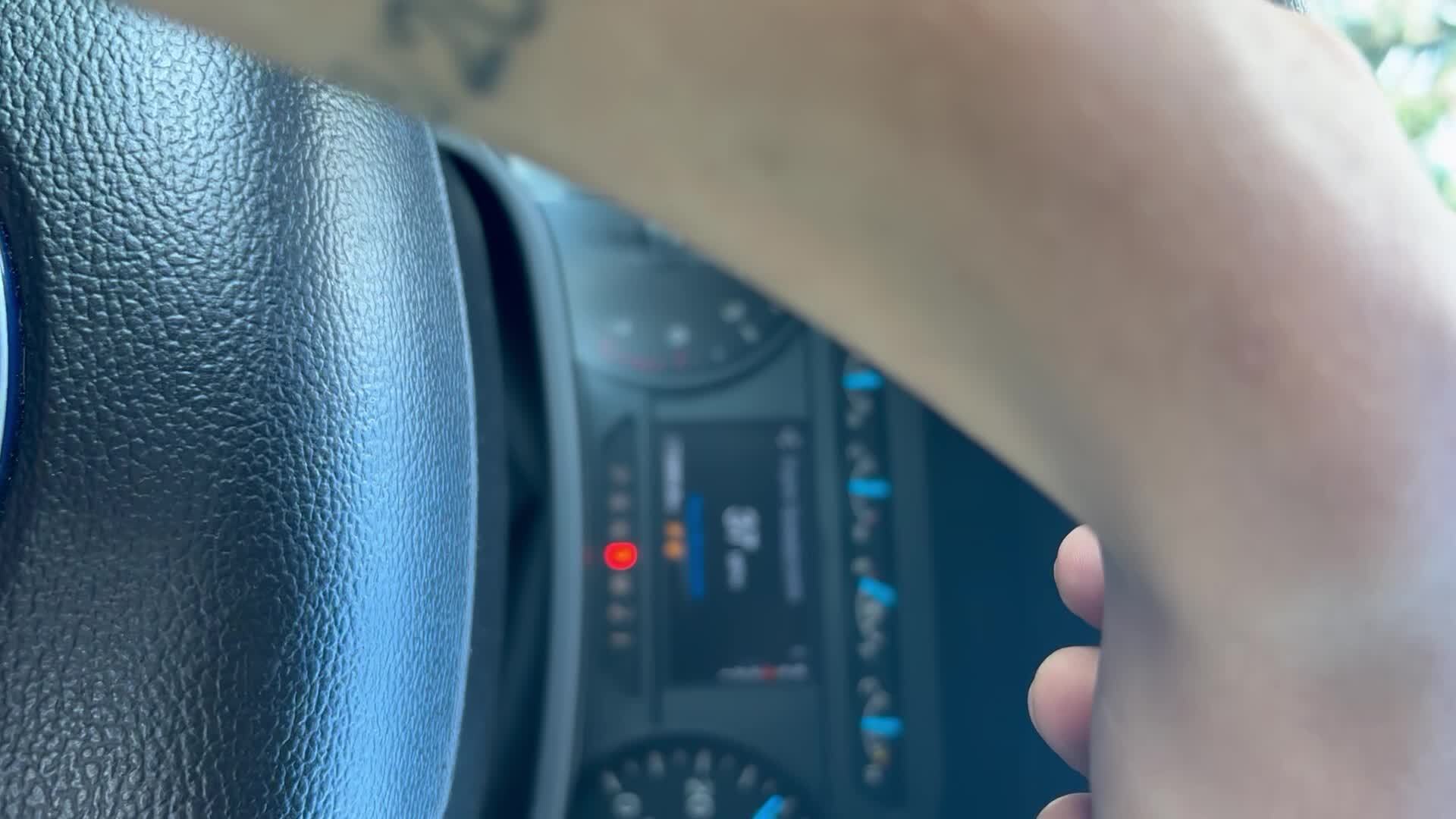

My truck will squeal after warm up. It’s a rotational squeal and is only after warm up and not a belt. I have no uneven wear or anything abnormal. Some shaking while braking and hitting bumps but I have a busted strut up front. It doesn’t pull and the tire doesn’t wobble so I know it’s not a wheel bearing. I pulled a tree in 4 hi and the day after is when it started squealing after warmup. And it’s only when I’m driving usually past 30. Also the squealing usually happens the most when I left off the gas or it downshifts.
The squealing is mid of the truck to up front. It’s hard to tell between exhaust and road noise

Thanks for the video but can you listen to it to see if you hear the noise? Does this truck have aftermarket rims and tires? Even though the bearing hubs don't have play they can still be bad fyI. Also, the serpentine belt can make a squeal noise but you say it is not the belt. If I can hear the noise it will help, and try to tell where it is being generated from. If it is the belt you should be able to rev the engine in park and it will make the noise. Let my know if the noise only happens when the truck is moving?

-Ken, it only happens after it warms up. I can rev it as much as I want in park and the belts don’t do as much as chirp. I know my tensioner pulley clicks every few minutes one time. Like it shifts. Then it’s fine for a few minutes and then shifts. But if it was a bad tensioner wouldn’t it squeal upon start up and during revving while not moving? But as far as aftermarket, I have no aftermarket wheels or tires. All are OEM and currently stock

Nice work, I don't think it is the belt, it sounds more like a front bearing hub is bad, does this make sense? It is a common failure which makes strange squeaking noises at odd times. This video shows the job being done on an older truck but the procedure is very similar on your vehicle.
