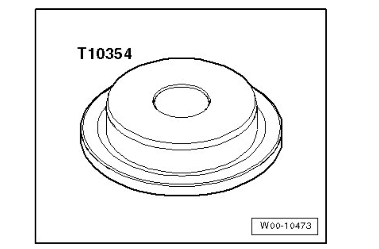

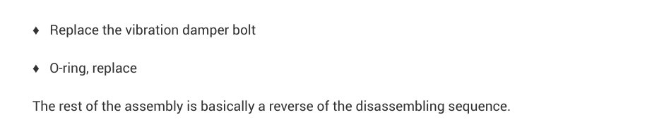

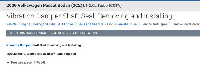

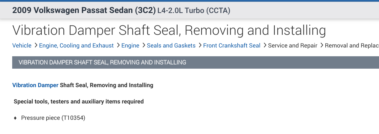

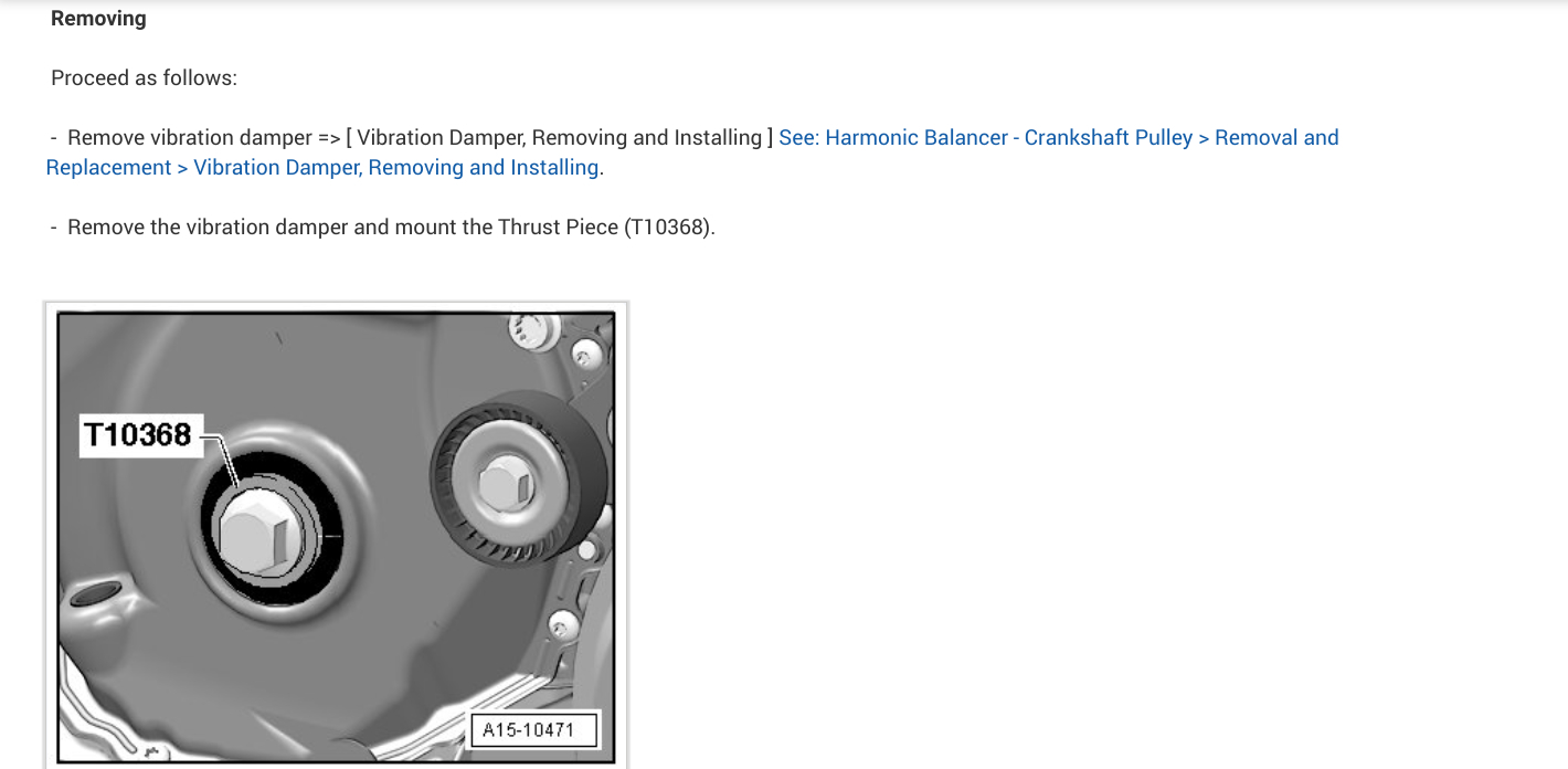

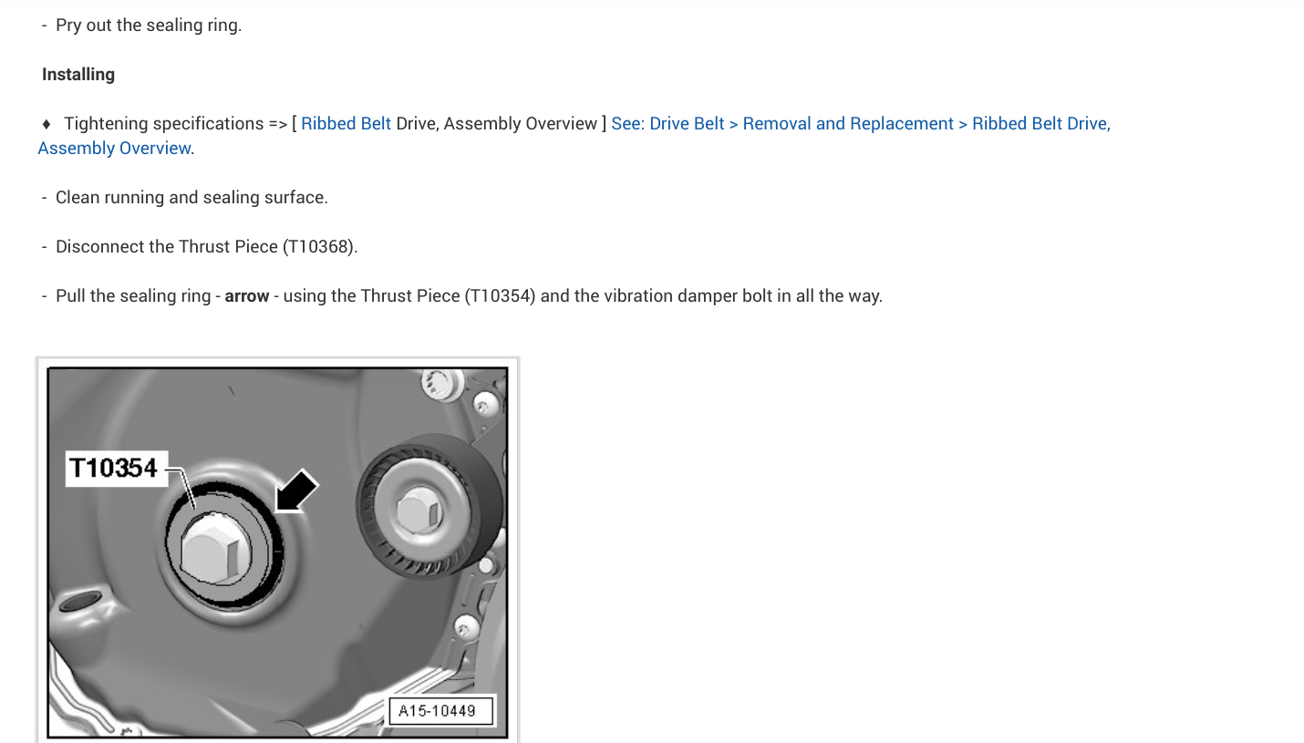

I have included the instructions for the removal and installation of the front main seal for your vehicle in the diagrams down below. It is from the vehicle manufacturer. Please go through this guide and get back to us with how everything turns out.
