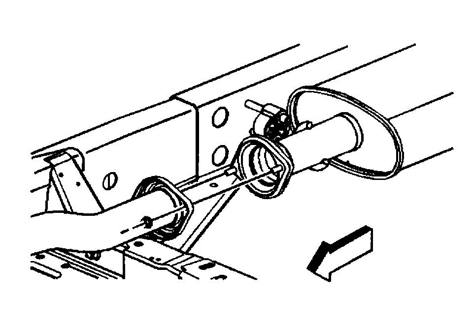

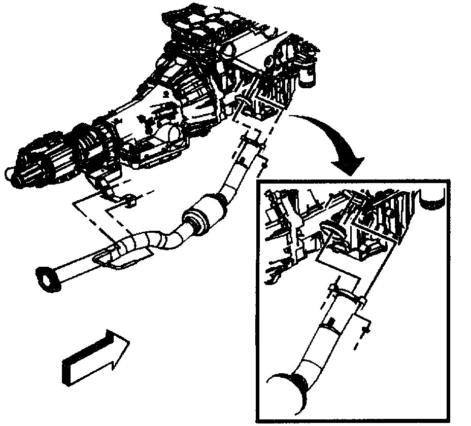

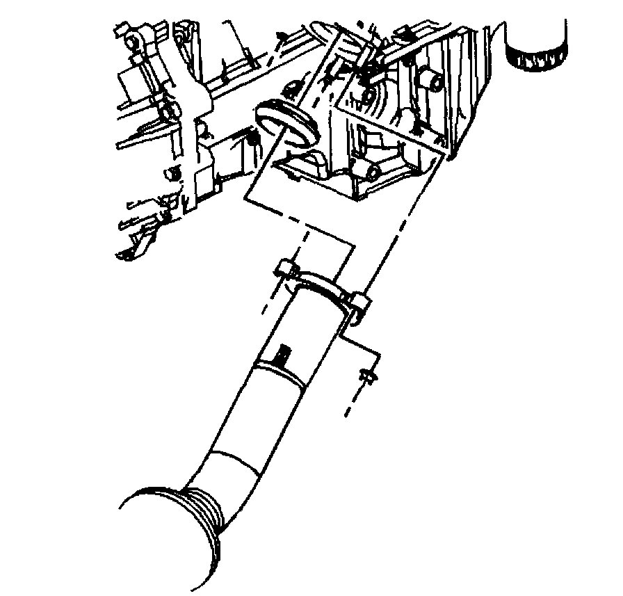

Here are the directions specific to your vehicle. The attached pictures correlate with the directions.
2002 Chevy Truck TrailBlazer 4WD L6-4.2L VIN S
Procedures
Vehicle Powertrain Management Emission Control Systems Catalytic Converter Service and Repair Procedures
PROCEDURES
Catalytic Converter Replacement
Removal Procedure
pic 1
1. Raise the vehicle. Refer to Vehicle Lifting.
2. Remove the nuts that secure the converter pipe to the exhaust manifold.
pic 2
3. Remove the nuts that secure the converter pipe to the muffler.
pic 3
4. Slide the catalytic converter out of the exhaust insulators and out of the vehicle.
Installation Procedure
pic 4
1. Install the converter hangars into the exhaust insulators in order to secure the pipe to the vehicle.
pic 5
Notice: Refer to Fastener Notice in Service Precautions.
2. Install the converter pipe to the muffler and secure the pipe with the nuts.
^ Tighten the converter pipe to muffler nuts to 45 Nm (33 ft. lbs.).
pic 6
3. Install the converter pipe to the exhaust manifold with the exhaust seal, and secure the pipe with the nuts.
^ Tighten the converter pipe to the exhaust manifold to 50 Nm (37 ft. lbs.).
4. Lower the vehicle.
