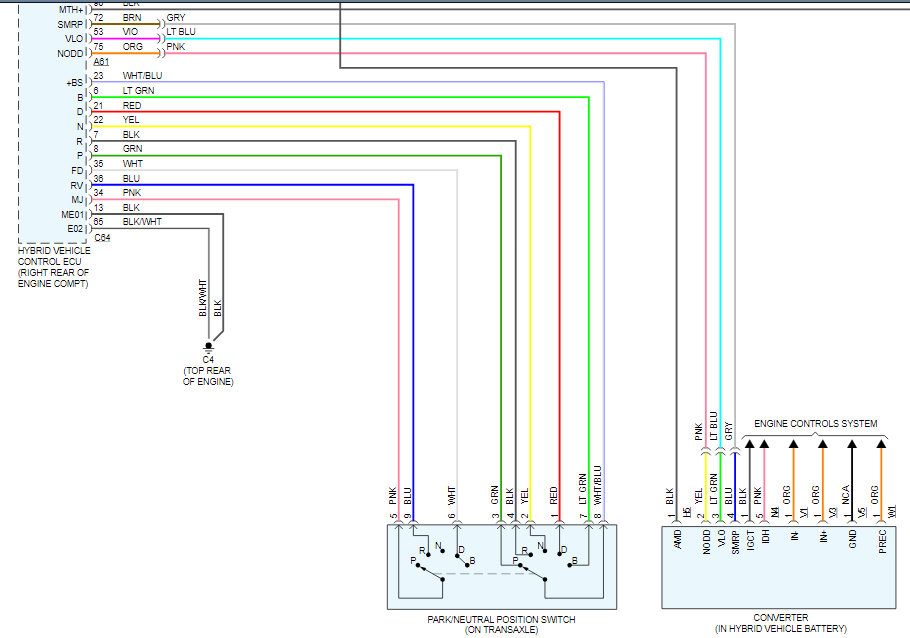

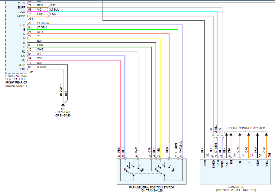

Doing some wiring for taxi and l need to locate the transmission pulse so I can connect it to my meter. any help would be appreciated.

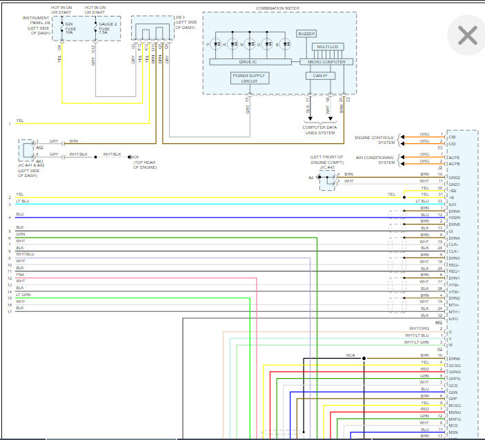

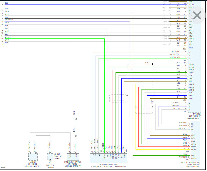

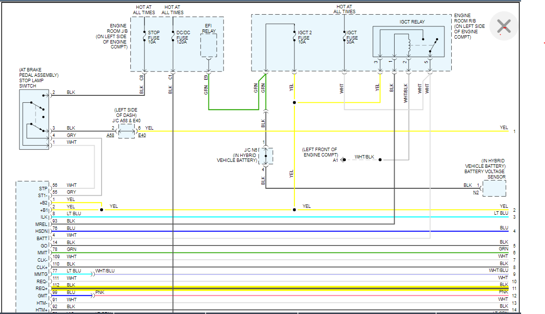

I've attached below wiring diagrams for the transmission circuits for your Toyota hybrid. I've cut the pictures in half to make them larger.Hope this helps and thanks for using 2CarPros.

Thanks Danny.. l will try to figure it out..
