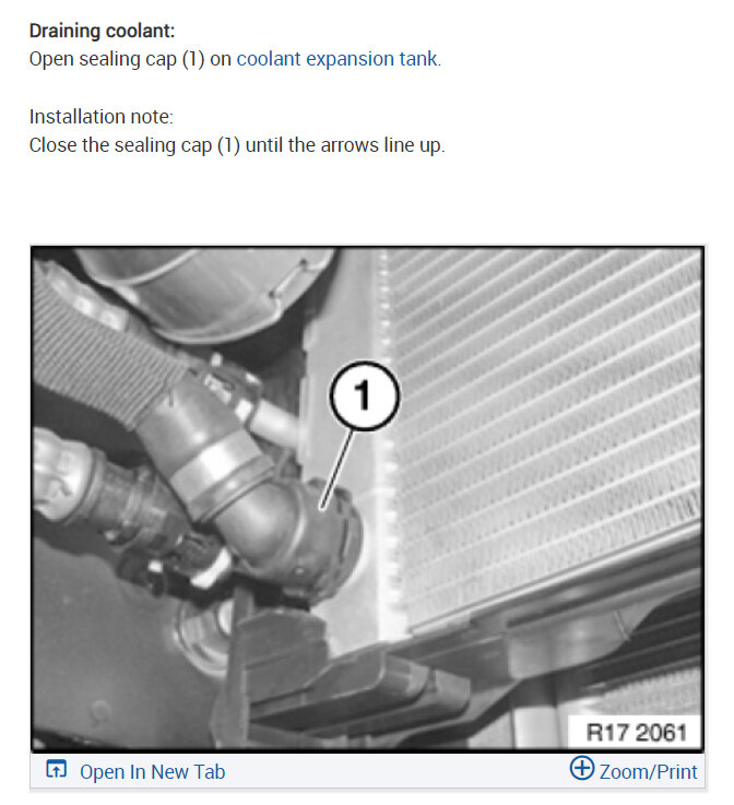

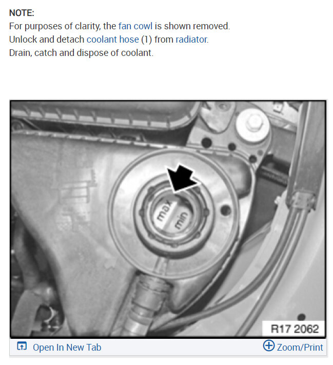

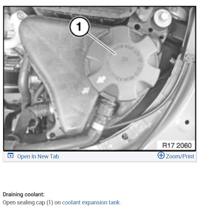

Hello, I want to drain out the coolant the vehicle listed above. Please could I know the process to drain it and how to refill it. The location of the draining tap.
Mar 6, 2024 at 8:32 PM
  • 55,721 POSTS

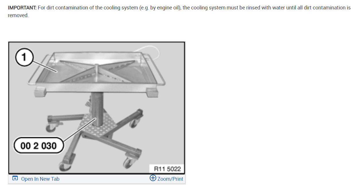

Sure, here is a generic guide on how to drain and refill the coolant. It looks like there is no drain plug, they want you to remove the lower radiator hose. Here is how in the images below:
https://www.2carpros.com/articles/coolant-flush-and-refill-all-cars
Check out the images (below). Let us know if you need anything else.
