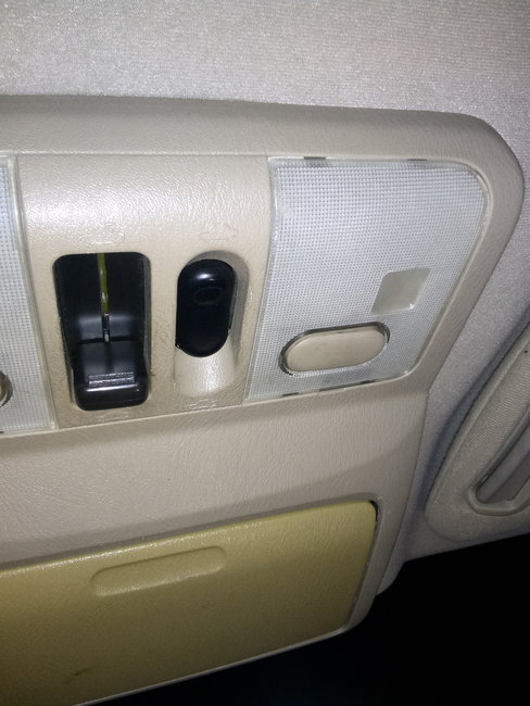

Hi, my brother switched out the car battery on his car. After starting up the car he went to open his sunroof and we noticed that when pressing the slide open fiction switch it only opened about three inches, so he passed it again and it open another three inches. So, in order for it to fully open and close he would have to press the switch buttons several times. I had the same problem on my Lincoln Zephyr and found it there was a reset/relearn procedure to fix it. Can anyone helping with the steps on how to do it on his Maxima? Would greatly appreciate it. Also thank you in advance.

There are 2 switches. One is for the tilt up and back down to the close position and the other is to fully slide open and close. I would send a video, but my phone isn't allowing me to do that i can show you. When i press the tilt switch the function works fine. It's just when i use the other switch to slide open to full and back to close that it isn't working like it should.

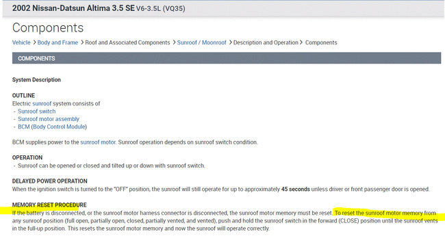

There are limit switches on the circuit, but I don't feel replacing the battery would cause them to fail.
I was able to find more info on the reset, take a look at pic 1 below. Let me know if this is something you already tried.

It doesn't specify if I'm supposed to turn the ignition switch to the on position or not? I'll try it with and without ignition switched on and i will let you know. Thank you

No problem whatsoever. I just hope it helps. As far as the key, if I had to guess, I would say it should be on. Otherwise, there isn't power to the sunroof, and I doubt that would fix it.
Regardless, I look forward to hearing the results.

It worked. It actually functions correctly now. Thank you very much. Greatly appreciate all your time and effort.
