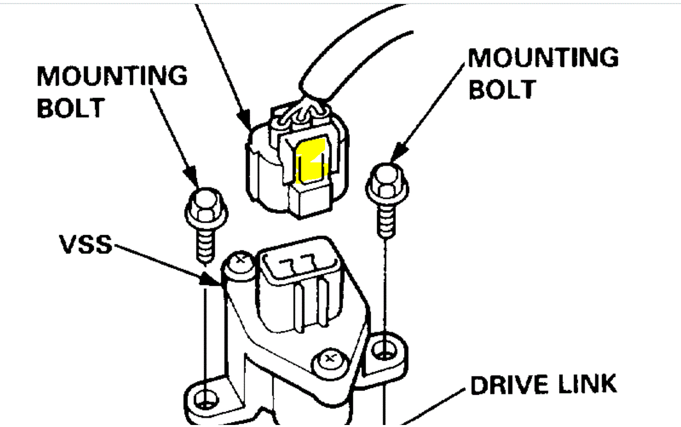

Can't unplug the cable that sits right on top of VSS on the vehicle listed above. Please help!

Take a look at the attached pic. If you press on the area where I highlighted the plug, it should pull off. However, some may have a small plastic locking device that first needs removed. Usually they will be orange or blue in color.
