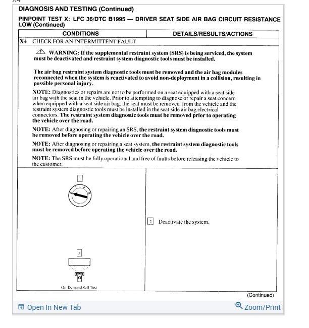

Airbag light is on with code b1995, how to bypass the beeping noise?
2002 LINCOLN LS
132,000 MILES • V6 • 4WD • AUTOMATIC
ANONYMOUS
Is there any way to bypass the beeping noise until I fix it? Anybody know if this is a simple fix, but I really want to know how to disable the beeping noise. I don't need to be reminded that my airbag light is on.
Dec 22, 2021 at 4:14 PM
ANONYMOUS
  • 0 POST
also, the airbag wire under the seat is fine and is not broken.
Dec 22, 2021 at 4:16 PM

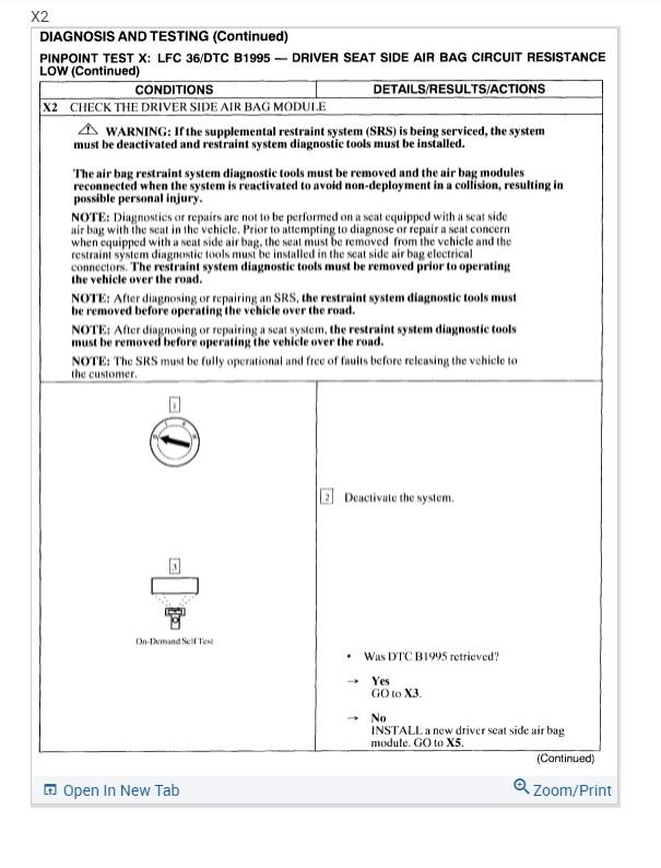

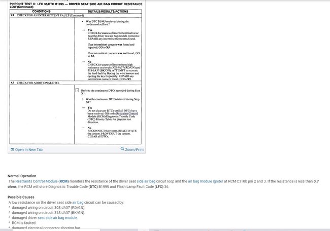

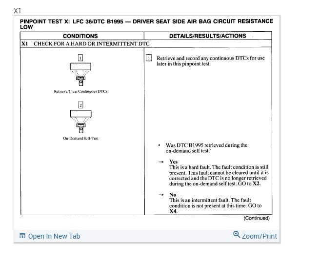

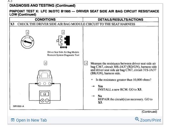

Good evening,
There is no way to bypass or disable the beeping. Since it is a safety system, it is programmed for you to have it repaired as soon as possible when the fault occurs.
I attached the flow chart for you below. The wires are a common failure, but they don't have to show external damage to be bad. They could be corroded internally. That is what the testing is for.
Dec 22, 2021 at 6:11 PM
