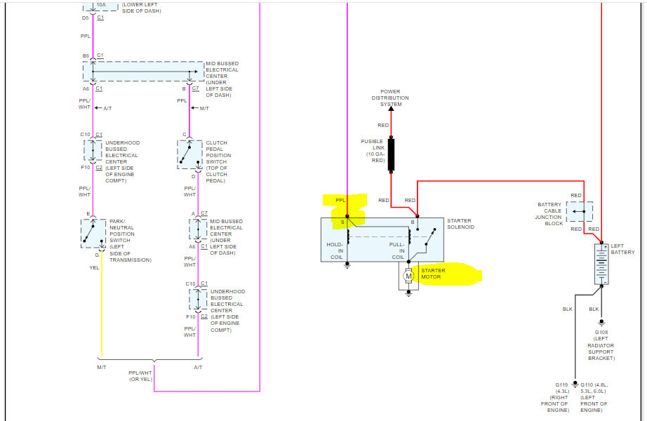

If there is no change, at the starter motor you will see a smaller gauge purple wire. That is the trigger wire. It doesn't have power until the key is in the start position. Have a helper turn the key to the start position while you check the purple wire for power.
If the wire has power, the starter is the likely problem. If there is no power, let me know and we can work backward to see where power is lost.

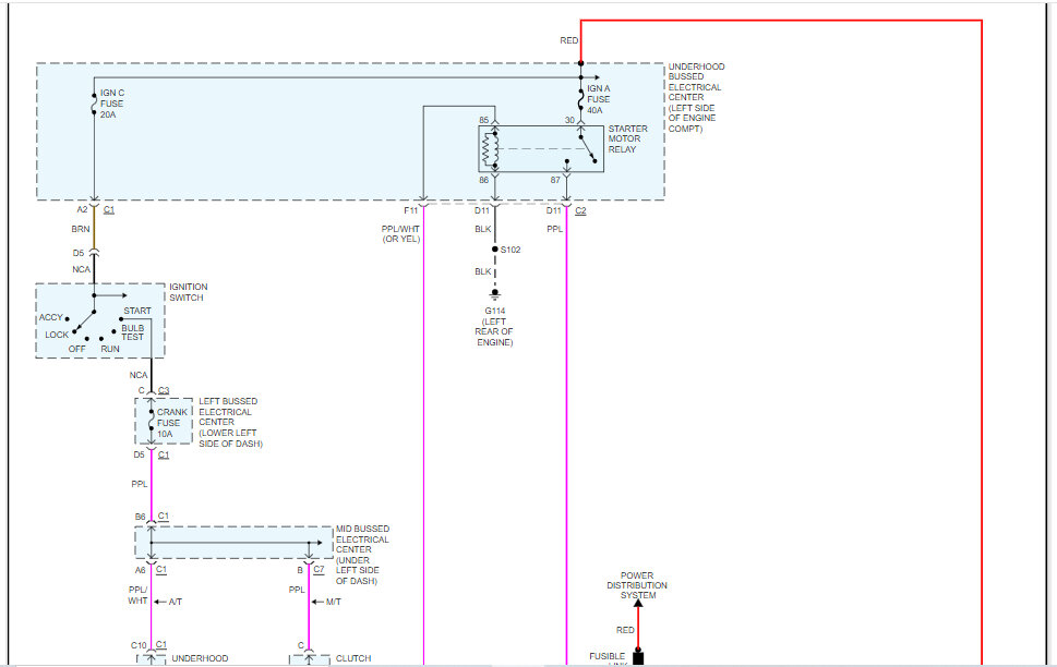

Additionally, I attached the wiring schematic for the starter circuit below, and here is a link that you may find helpful:
See pics below. Note: I had to cut the pic in half to make it readable. I did overlap the two so you can follow from one to the next.

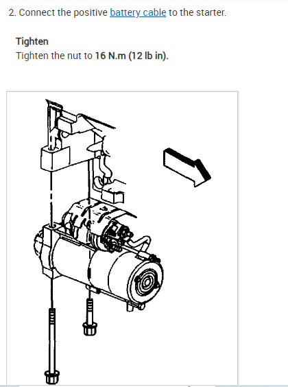

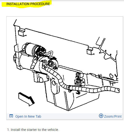

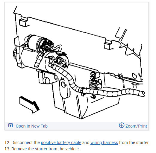

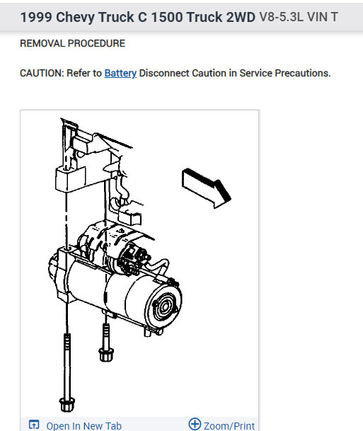

Also, I attached the directions specific to your truck below.

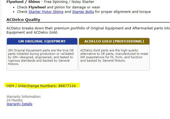

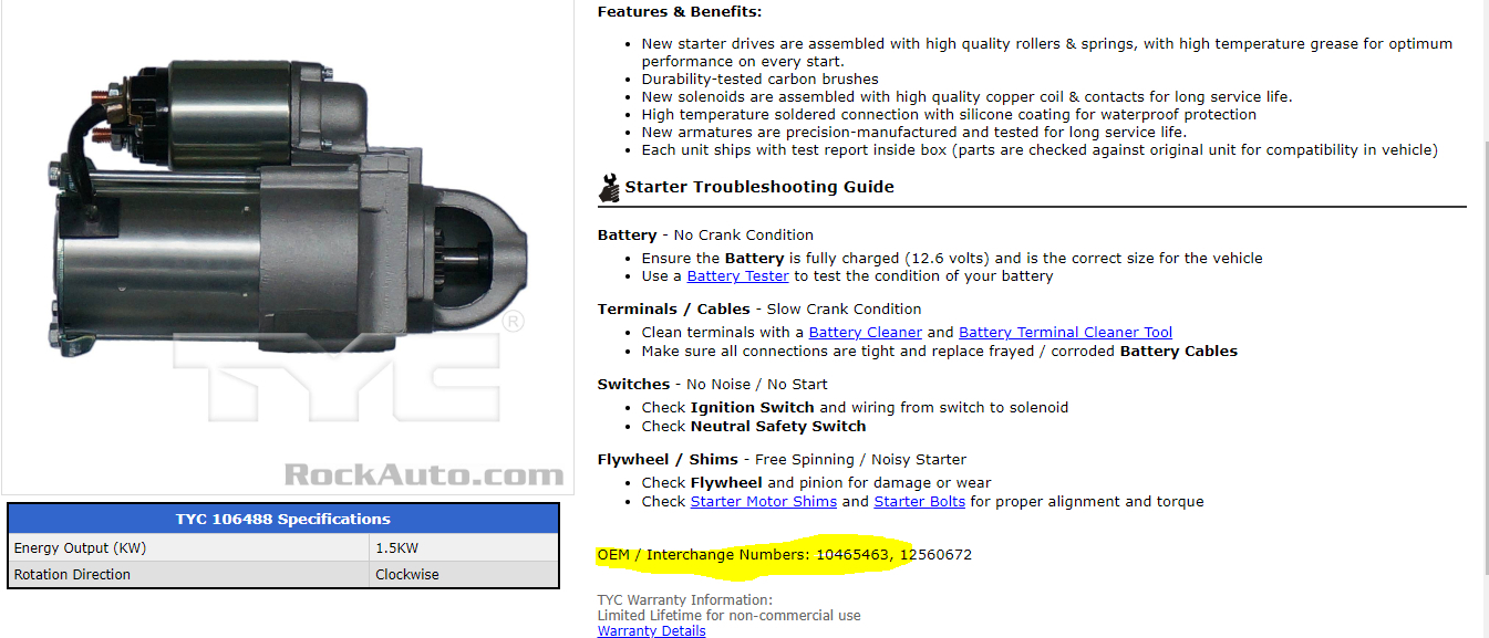

As far as the part you listed, I don't believe that is correct. Interestingly, Rockauto doesn't indicate a 5.3L engine for this year, but I know they came with them.

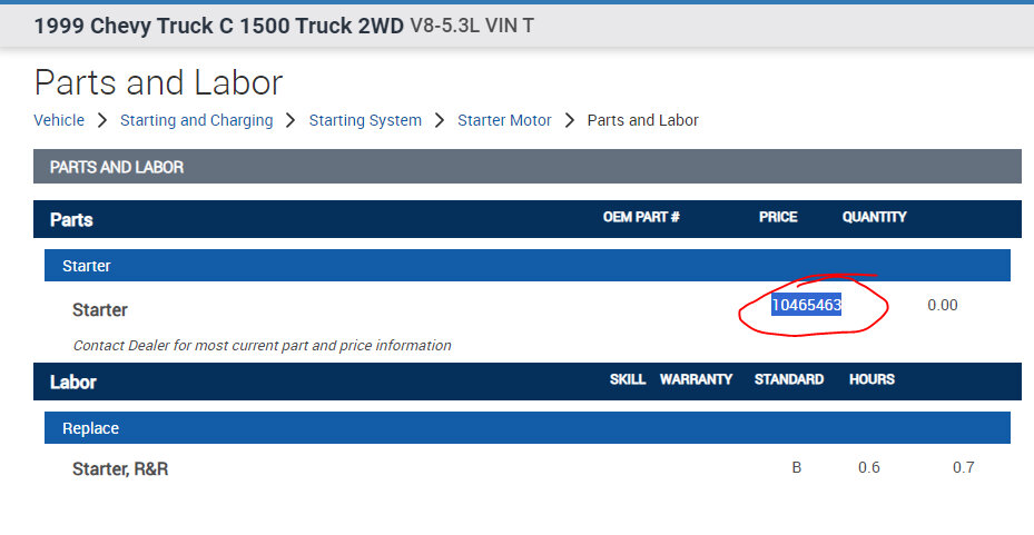

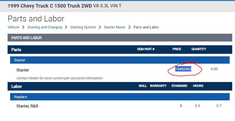

The OEM part number for the starter in your truck is 10465463. See pic 1 below. I looked up the part you indicated, and it shows a different OEM part number that it replaces. See pic 2.

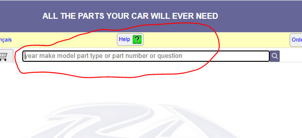

I used the OEM part number from my manual and Rockauto came up with multiple starters that indicate it is a replacement for what my manual indicates. Pic 3 shows an example.

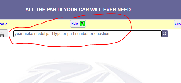

At the top of the page, you will see a place to put a part number. Put the 10465463 part number there and it will bring up starters.

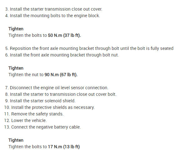

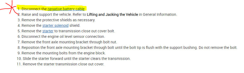

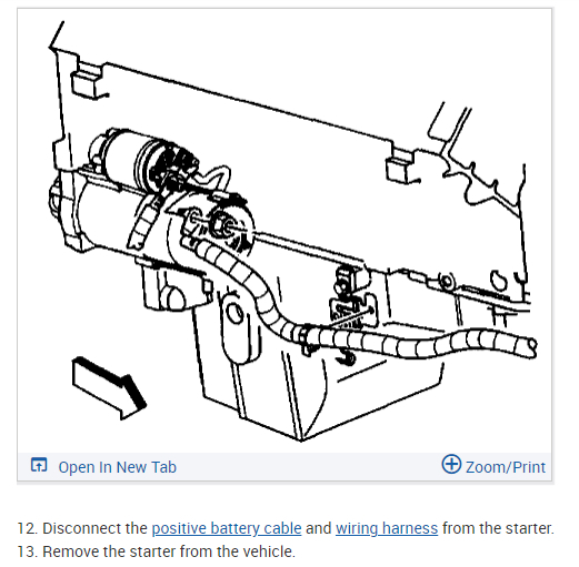

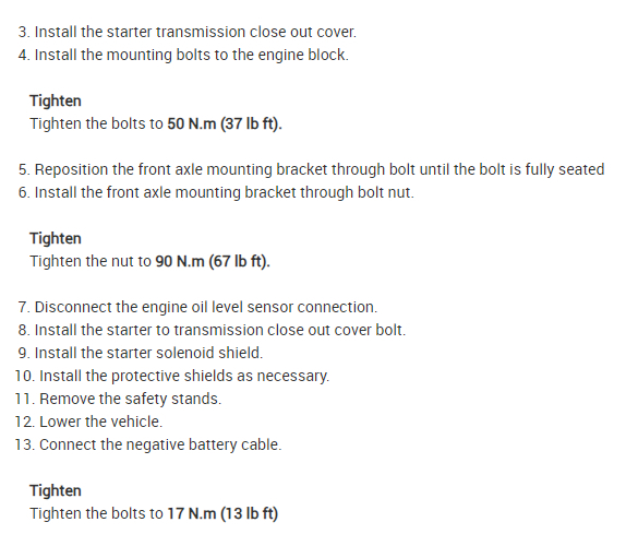

Starting with pic 5 are the directions for your vehicle. Before starting, make sure the battery negative terminal is disconnected. Also, it indicates removing things that I just don't remember ever having to remove. LOL Take your time and check to see what needs to be done for removal. It should be two bolts and the wiring on the starter motor.

You saved me a lot of headaches. I had ordered the wrong part. Luckily i was able to cancel and get the correct part. I ordered the New Bosch starter because it had a lifetime warranty. Thanks for saving me the hassle of a return and exchange and the discount code. That was awesome! So, i guess i can start taking the old starter out. I'm wondering how hard those bolts are going to be to remove if they were machine tightened. I don't that. lol.
I have the truck on my ramps that i use for my oil changes. The tow truck fella was sweet and put it on them for me. Can you tell me why i would just disconnect the negative battery cable? I always disconnect both of the cables, or does it matter?

As far as the battery cables are concerned, once the negative is disconnected, the circuit is open and no longer complete. At that point, you don't need to remove the positive.
