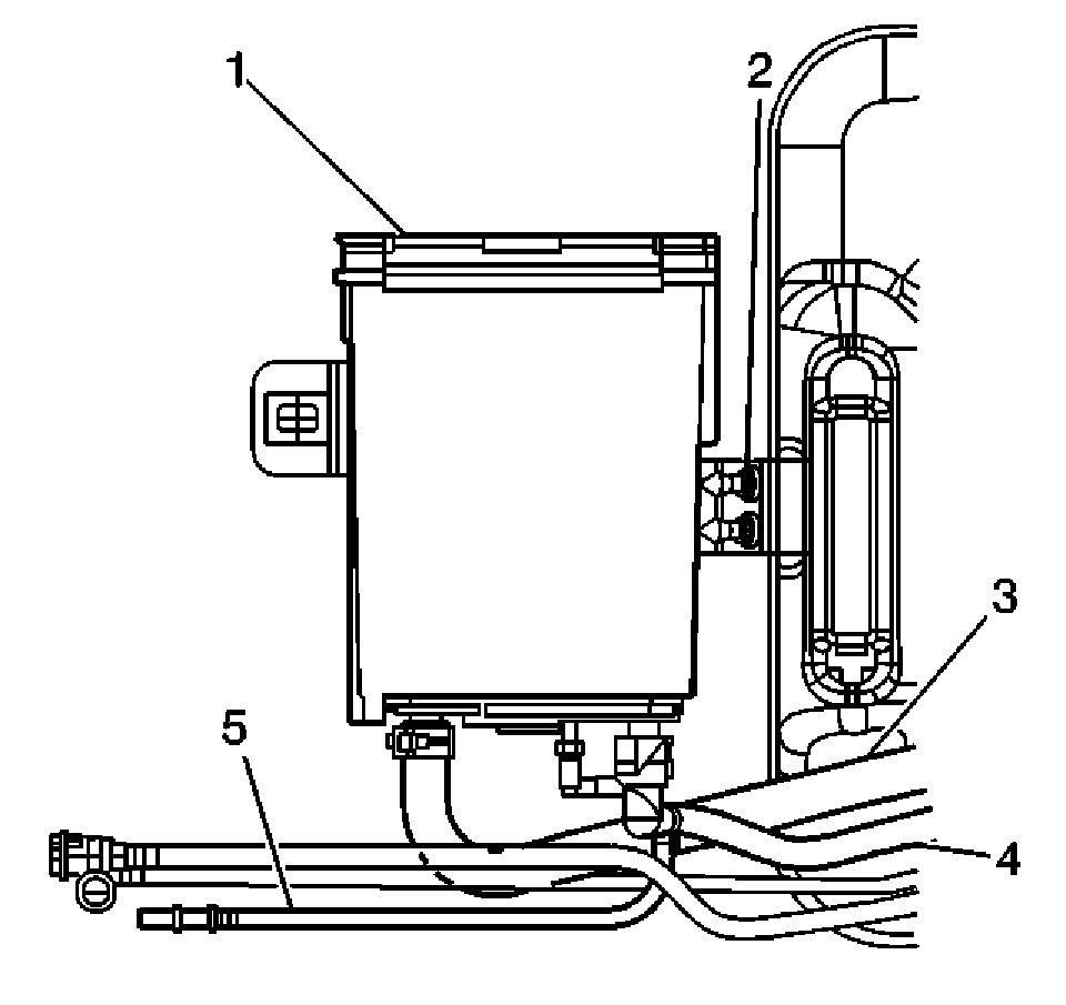

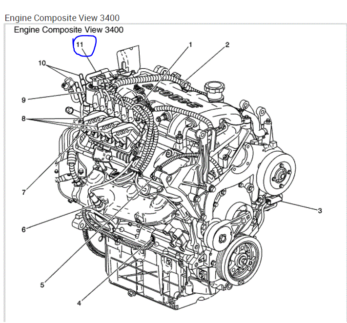

There was a EVAP system leak test failed by by DTC's diagnosis. I got smoke tester. But I don’t know where to connect the smoke delivery tube tip.
Thanks for your instruction and helps!
Saturday, November 21st, 2020 AT 2:01 PM
  • 109,885 POSTS
The EVAP service port is located in the EVAP purge pipe between the EVAP purge solenoid and the EVAP canister. The service port is identified by a green-colored cap
I attached two pics below. The first shows the canister which is near the fuel tank. The second shows the solenoid. If I recall, the service port is near the purge solenoid (number 11 in pic 2)
Let me know if this helps.
