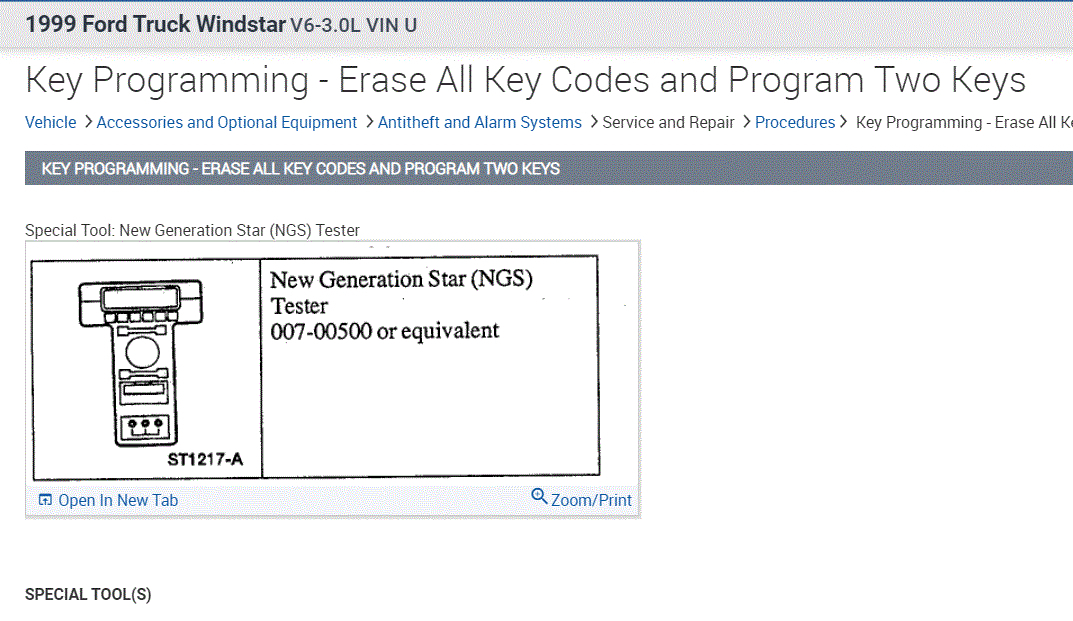

Just changed my key cylinder on my van and theft system light is blinking on instrument cluster dashboard.
Jan 29, 2022 at 8:06 AM
  • 110,248 POSTS

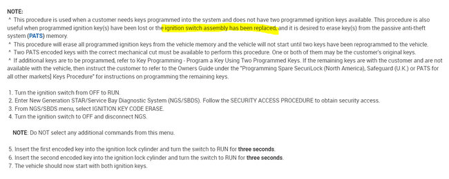

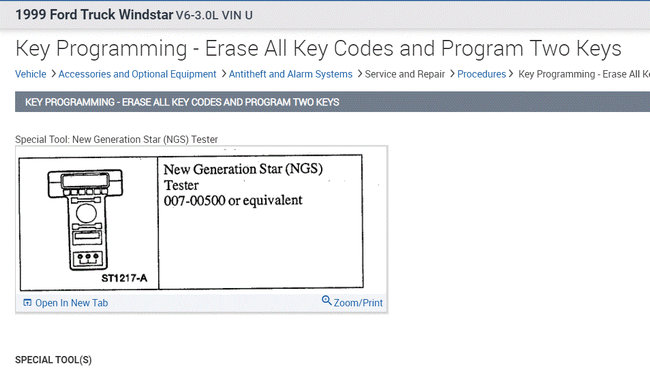

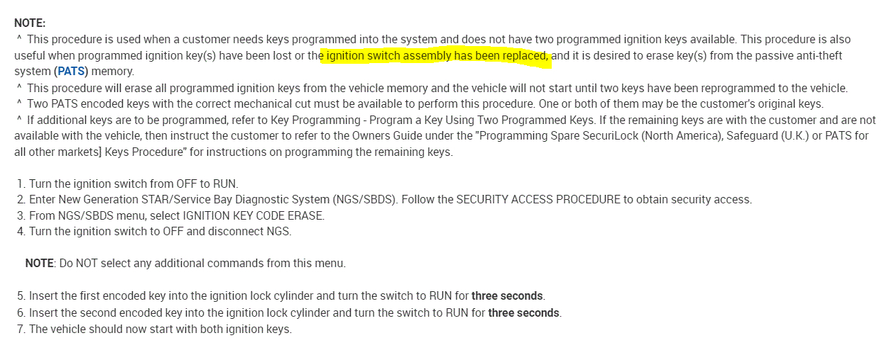

If the key tumbler has been replaced and you are unable to use the old keys, the (PATS) passive anti-theft system needs to be programmed to accept/recognize the new key. This requires a scan tool that can communicate with the PATS system.
I attached the directions below. Most people don't have the tooling to do it. If that is the case, you may need to contact a locksmith or a shop with the equipment needed.
I wish I had a better answer, but that is what is required.
See the directions below and please feel free to ask questions.
