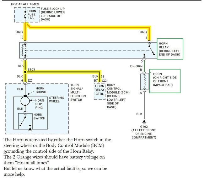

I have found my fuse on my car under the left side of the dash. I have 4 wires coming out of it. Two orangeish yellow, one green and one black. Which one is the horn trigger wire?

Hello, it looks like you have the correct wire coloring, I will post the Horn wiring diagram for you here in a second, but did you find a blown fuse for the Horn (15Amp)?

No my clock spring has a broken spring retention clip and I’m just looking on how to wire an after market button

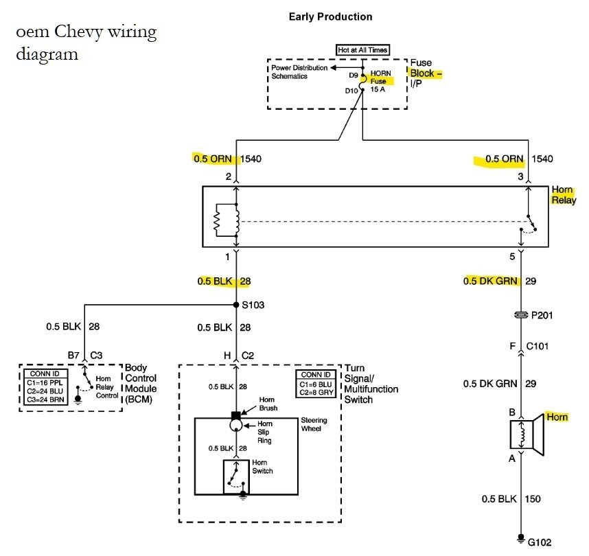

These are the wiring diagrams for the Horn circuit, the 2nd diagram is the oem Chevrolet diagram which the colors match on both, so the first one is accurate as well. Let us know what you find or if you need further help.
