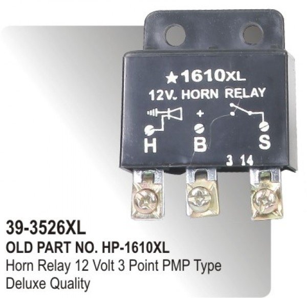

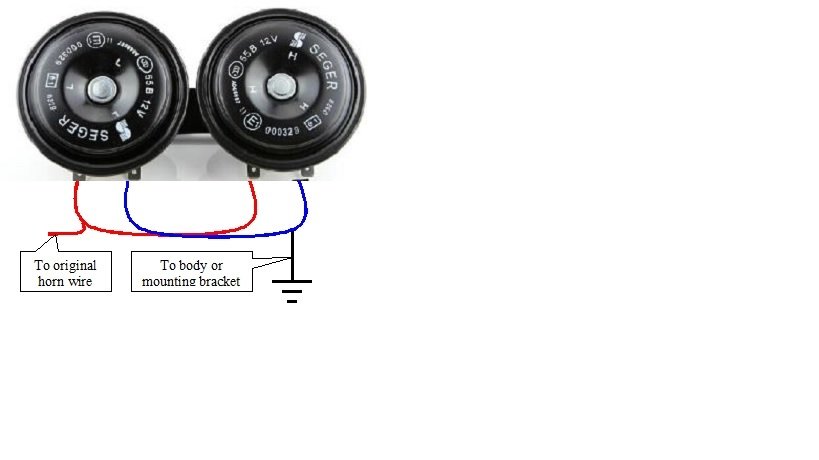

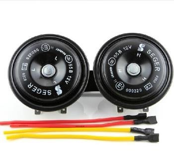

Sir, a single beep horn is received as factory fitted. I want to connect two horn instead single. I purchased two horn set, a relay three pin. twelve volts how many ampere need?Please help me to how to do wiring. I want to do it my self.

The relay is not needed if your vehicle already has one for the horn.

Thanks for your reply... i will check if relay available...
