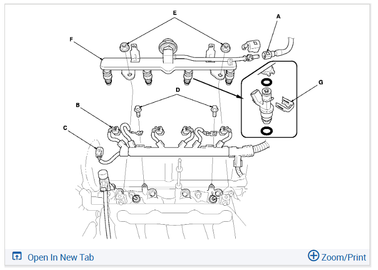

P0302 and P0303 codes appeared, even after replacing spark plugs and coils. I suspected fuel injectors problem, and tested their resistances with multi meter, but four injectors showed all similar resistance around 11.04 Ohm. And I found the 3 injectors 3 and 2 were loose in their cells that I thought may be O=rings damaged?
I want to remove injectors, but I could not find answers to my question on YouTube site.
How to replace fuel injectors on Honda accord 2009?
Thanks for your comments and helps!

Yes, testing the resistance does not always work, it is more about the injector nozzle. I would remove the injectors as you are thinking and use this guide as a test:
https://www.2carpros.com/articles/how-to-test-a-fuel-injector
Here is how to remove the fuel injectors in the images below. Let us know what you find.

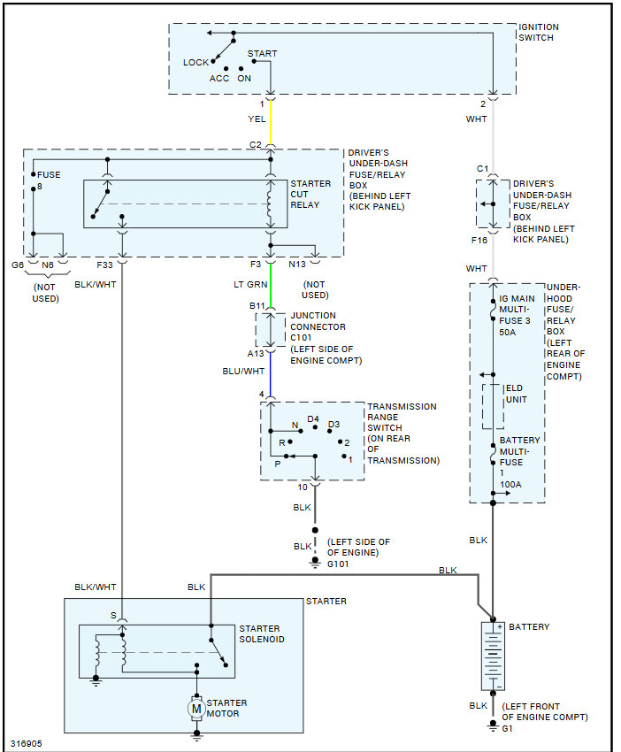

I replaced new spark plugs and coils on #2 and #3 problematic cylinders. And I tried to start up engine, but I could not start the engine. there was no crank voice. if the starter was gone? I charged battery from 11.47 V 78% 12.6 V to 99%.

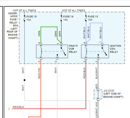

Today I did an injector circuit power test using the voltmeter negative side connected to the negative side of the battery. key on at III position without start engine, positive end probe both sides of injector wiring connector. the voltage showed all zero on all four injector wires, indicating circuit was disconnected. so, I need to check the wires and connectors.
I tested the engine starter, with voltmeter set 12V, connected on both battery ends, and checked voltage changes when key on starting position. There was voltage decrease from 12.7V to 10 v, indicating starter may be OK. But no crack sound when turned key to the start position.

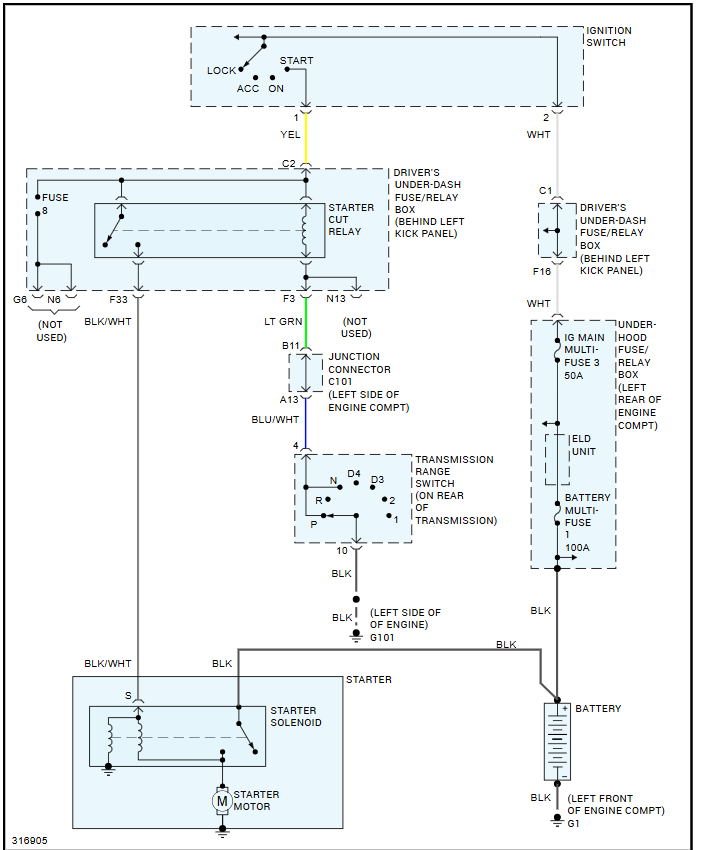

The images were lights on dashboard when key on III position without start. It’s normal. Yes, there are two problems now: first, I don’t know if injector 2 and 3 bad that caused p0112, p0113?
Second, now a new problem is the engine couldn’t startup with all injector wires losing power. When turn start key, no crank sound, but it changed battery power from 12.7v to 10v, indicating starter was not dead?
If specific fuse was broken? Or wire was disconnected?
I was going to check vacuum leak and fuel line pressures, but engine couldn’t startup now.

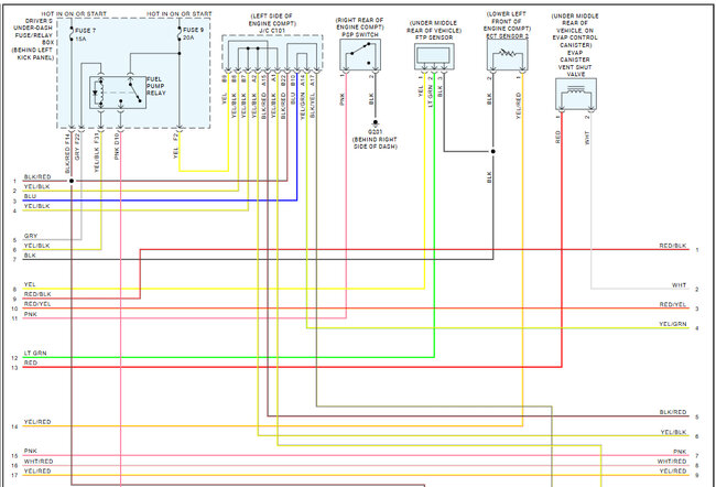

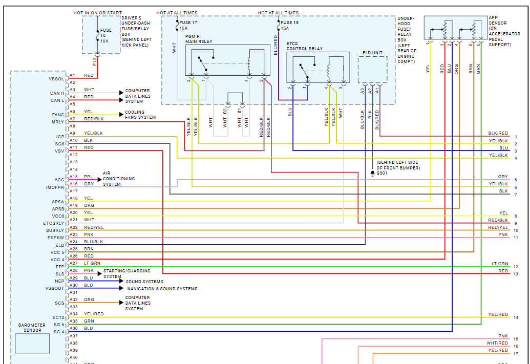

I need diagram from injector line to battery and battery to solenoid and starter diagram.
The cause of new problems probably the same on power lack on starter and injectors.
Thanks for your help!

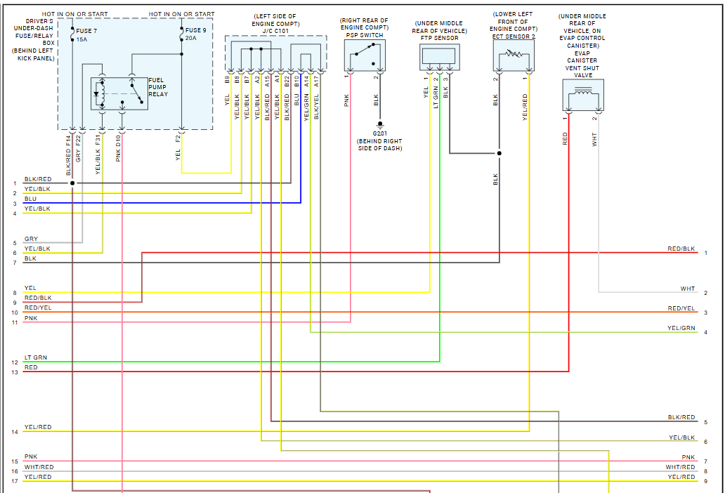

Sure here are the wiring diagrams for the PCM power and the starter system. Let me know what you find. Try uploading a video?

XJSHEN
  • 251 POSTS
Hi Ken!
I couldn’t identify the part and its location as well their circuit. If you could kindly provide detail detection video or text documentation?
